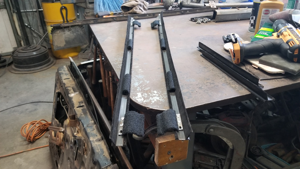

Finally finished my DIY outer dew wipes. I replaced all the felt pieces with Velcro material. I also replaced the rubber parts of the inserts with new weather stripping from Home Depot.
If you ever decide to do this, I recommend using some kind of hole punch to make the holes. Using a drill was imprecise and I'm worried about how much trouble I'll have installing these on the doors.

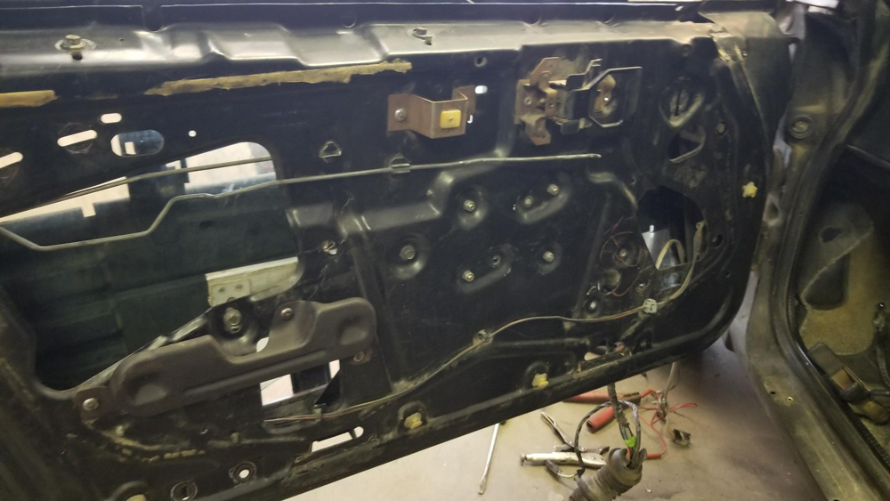

Weekend update. I installed the power equipment into the driver's side door. I underestimated how much time would be required to clean the inside of the door, the window glass, etc.
Bolting the power regulator to the door turned out to be a PITA. I had to grind down one of the bolts to get it to fit between the motor housing and the door. I didn't take a picture of the problem area because I was frustrated, but after wrestling with it for 20 minutes I got it installed.
As I told my wife, it's a little thing, but being able to actually install something instead of taking something off the car is a huge lift.

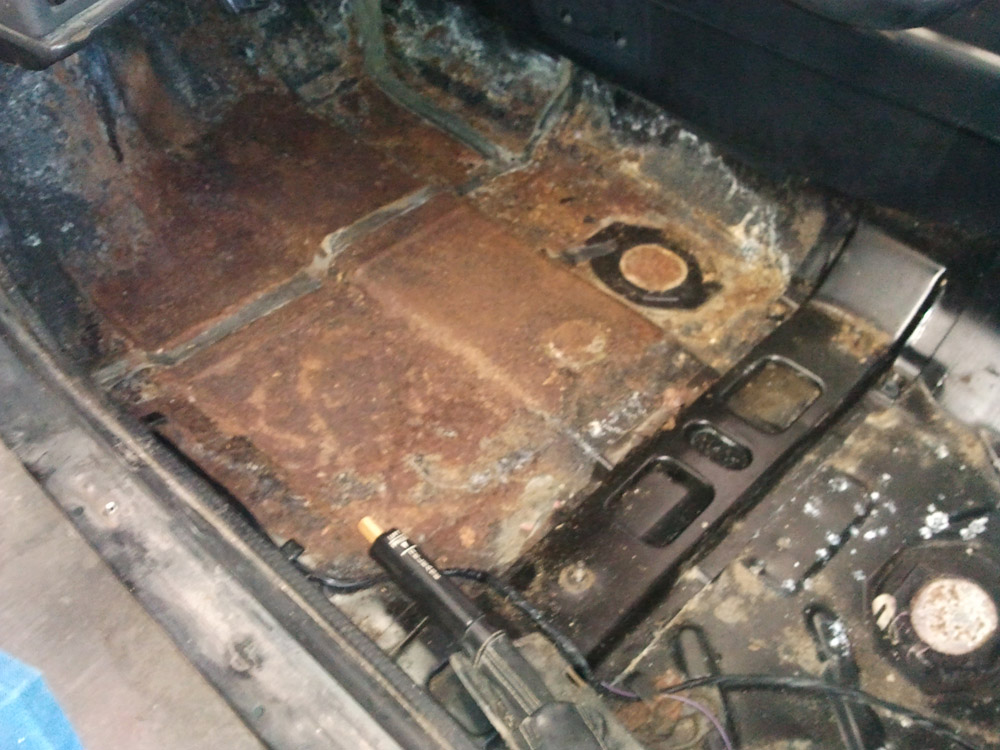

The first is what the driver's side floor pan looked like when I first pulled the carpet out. The car had very little rust, except for this.
I think the original owner must've spilled a coke down the console, because the bottom of the car looks great and there aren't any holes.

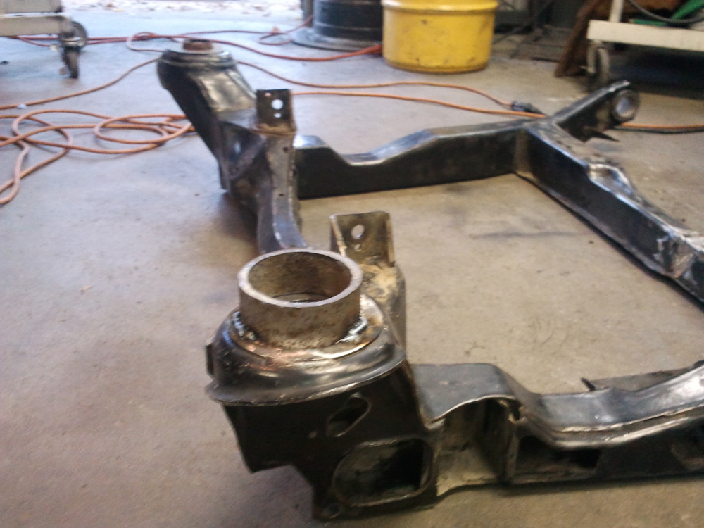

Next up is a photo of my GTZ's bottom engine mount. As I've mentioned before, I'd considered using the Grand Am style mounts, with one in front and one on the back of the engine, because that seemed to be the most common type. On the other hand, the GTZ style is very similar to the Iron Duke's mounting system and it doesn't clutter up the engine bay. I cut the flange off the GTZ bracket and I think I had to drill one hole to mate it to the Fiero engine mount.

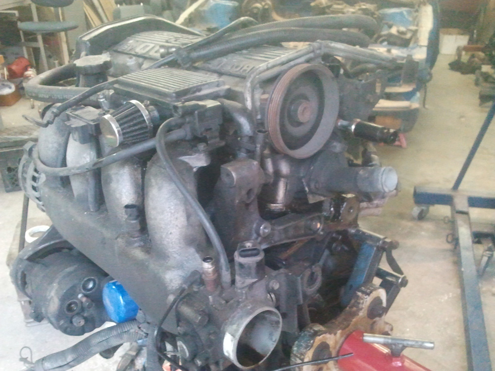

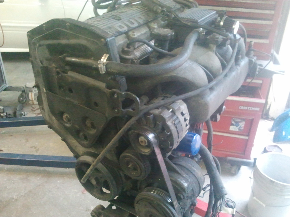

Not much progress to report, but I did find some more photos of the beginning of the project.

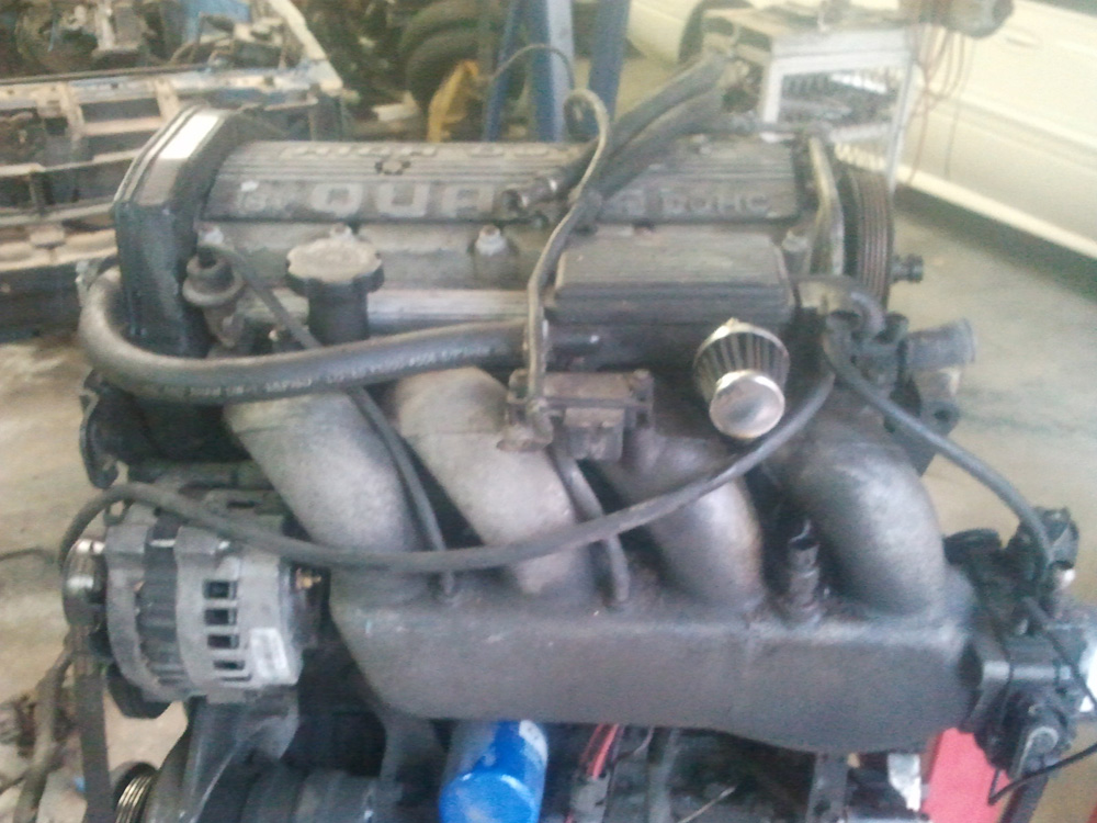

Here are photos of my Quad right after I removed it from my GTZ rust bucket. To review, my brother gave me the GTZ in 2008 with a blown head gasket. I put a new head on it and cleaned up the engine, then drove it every day for four years. I put more than 100,000 relatively trouble-free miles on it. As you can see, the engine was filthy.
The big pulley is for the power steering pump, which I'm obviously not using in my Fiero. Quad 4 power steering pulleys are notorious for being difficult to remove.

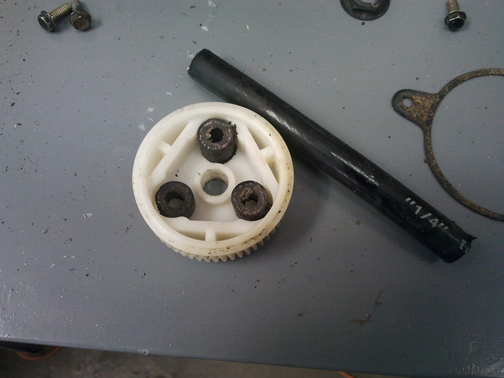

When I bought the car, the right front headlight was propped up with a piece of firewood. I disassembled the motors and found the "sand" inside. After reading everything I could find on this forum about replacing the plastic dowels, and playing around with the gears, I decided there was no reason I couldn't use sections of rubber fuel hose.
I figure the only reason the engineers used plastic dowels in the drive mechanism was to absorb shock. I put the motors back together and tested them and they worked fine. So come at me if you disagree.
