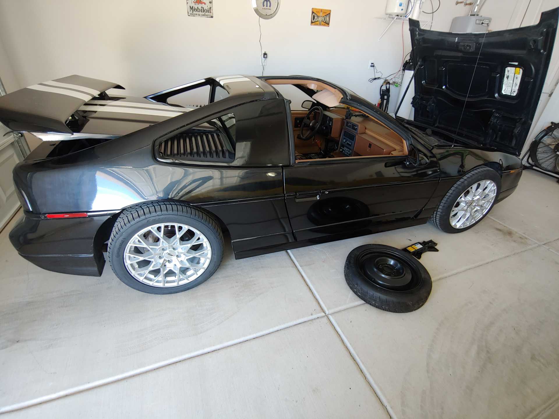

Chief08
MAR 05, 12:11 PM
So I finally got the wheels mounted after the wheel stud fiasco.

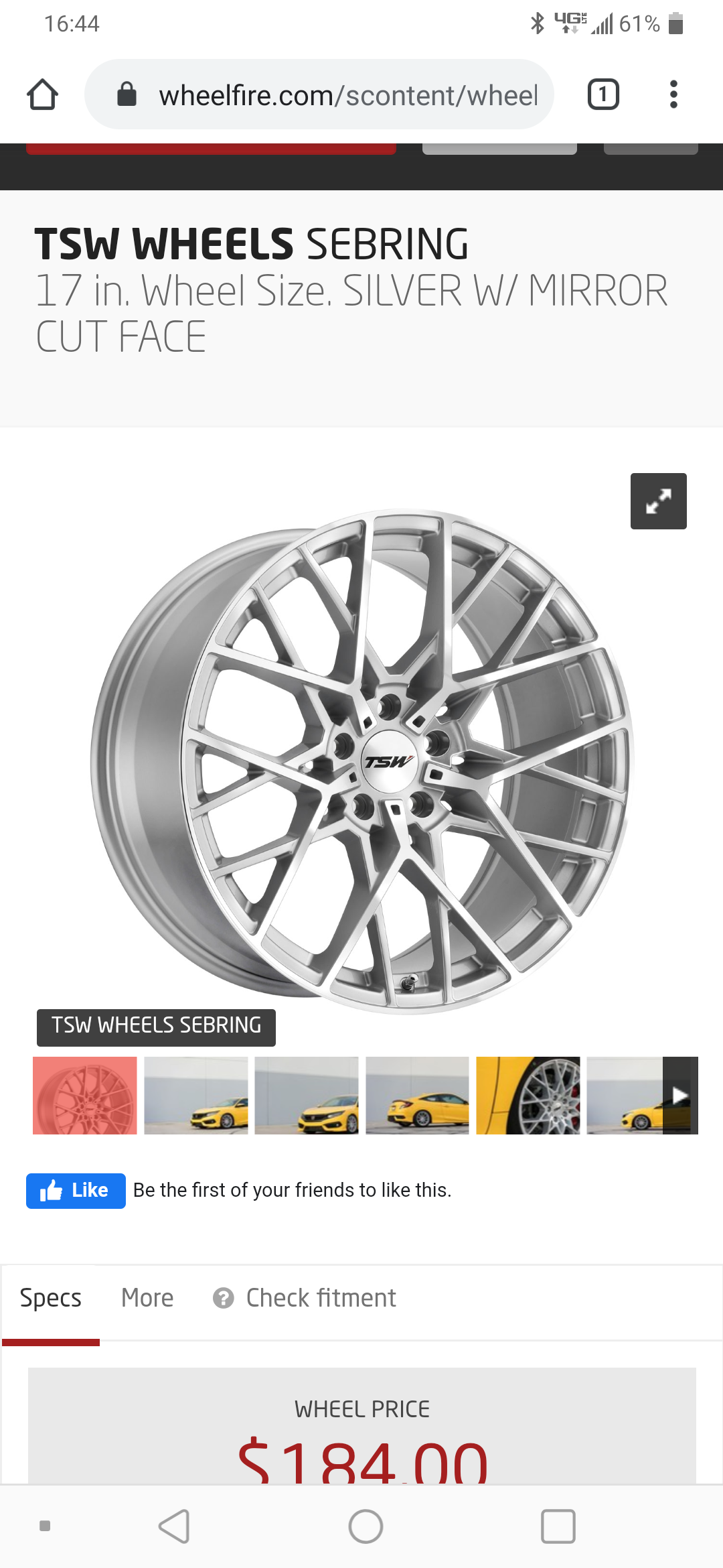

Chief08
MAR 05, 12:35 PM
| quote | Originally posted by Fiero Tom:
What make of wheels did you buy? Size and offset please. |
They are TSW Seibring 17"×8" 35mm offset.

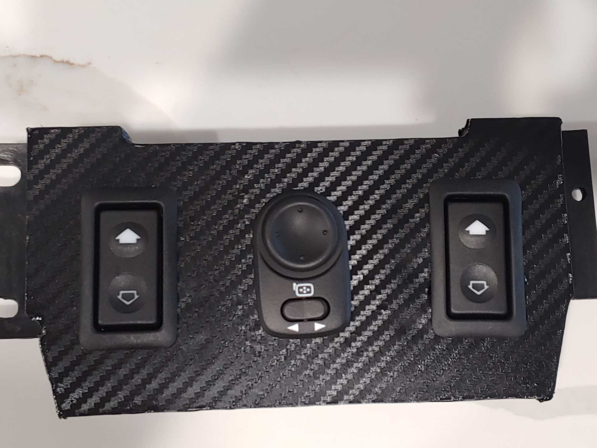

Chief08
MAR 05, 08:19 PM
I finally got my switch panel set up.
