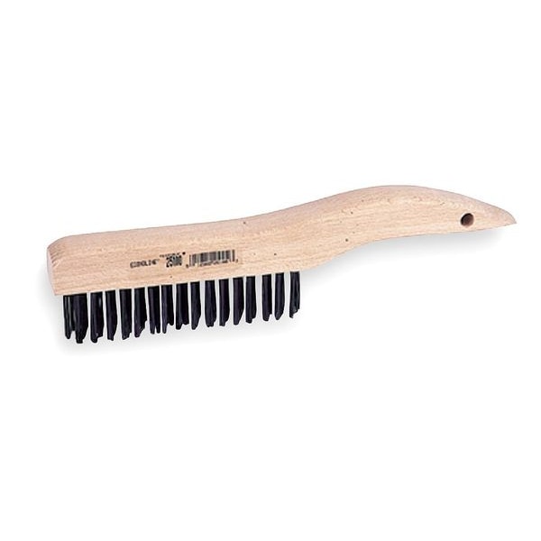

The rust coating paint stuff was unfazed by my wire brushing attempts. I ended up using a pick to scrape almost all of it away from the area, then the wire brushes to clean up after. I'm thinking I might need stiffer wire brushes.
This is the wire brush I was referring to.
