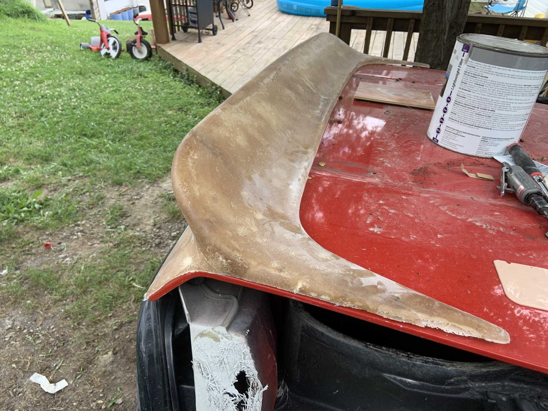

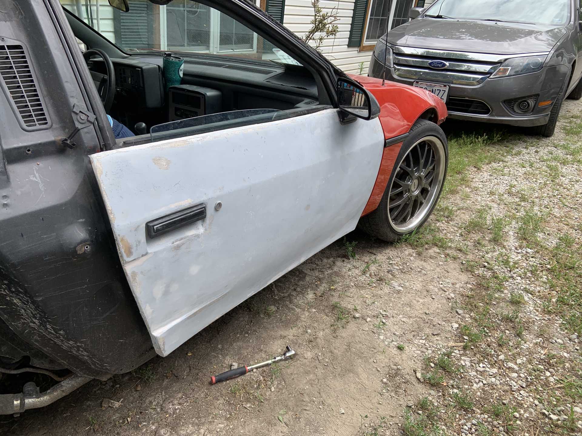

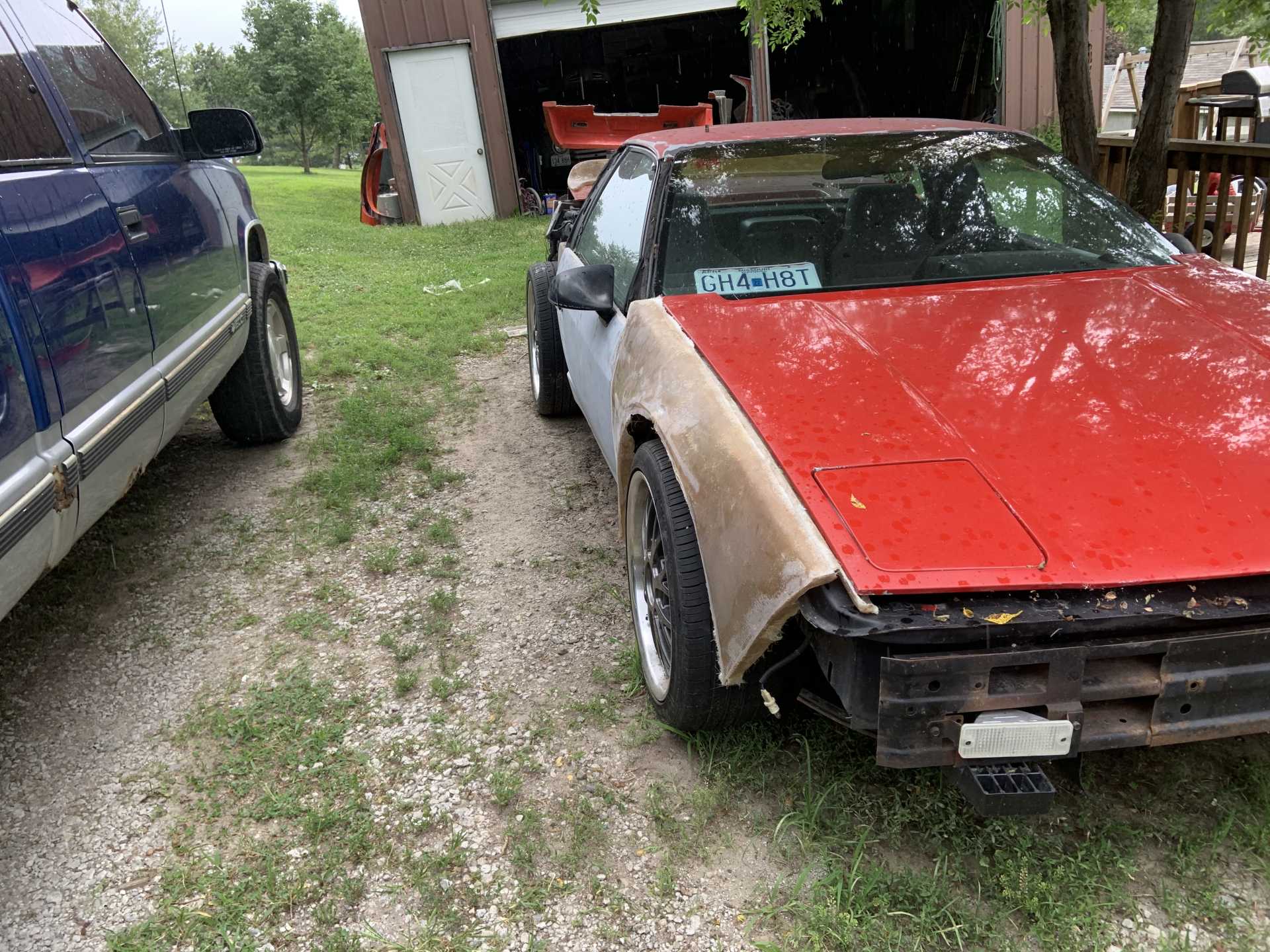

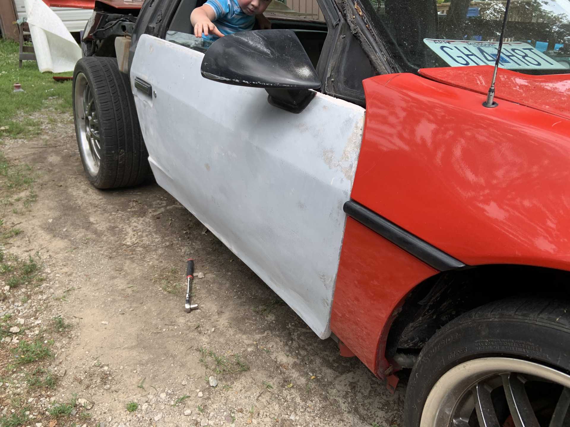

Just a little update on what I’ve gotten done so far. The passenger door skin was blocked trimmed and added about half the mounting points so far. I was able to mount the skin so I could make sure all my door gaps are good and have plenty of adjustments before I complete the rest of the mounting points on the inside. I was able to cast the rear spoiler as well I did confirm with sage that it is the smaller of the irm spoilers he has. When the heat breaks I should be able to cast the front clamshell.

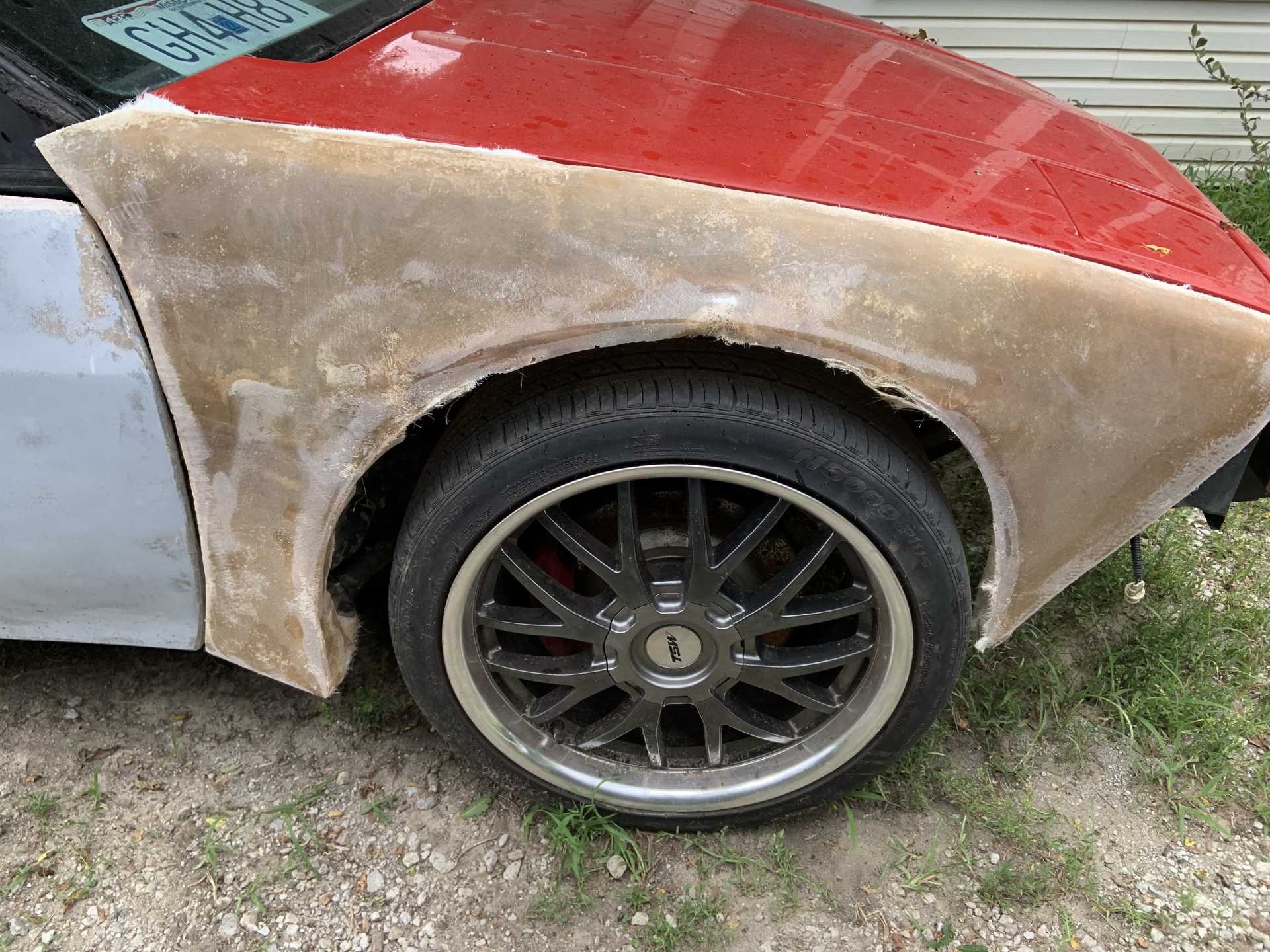

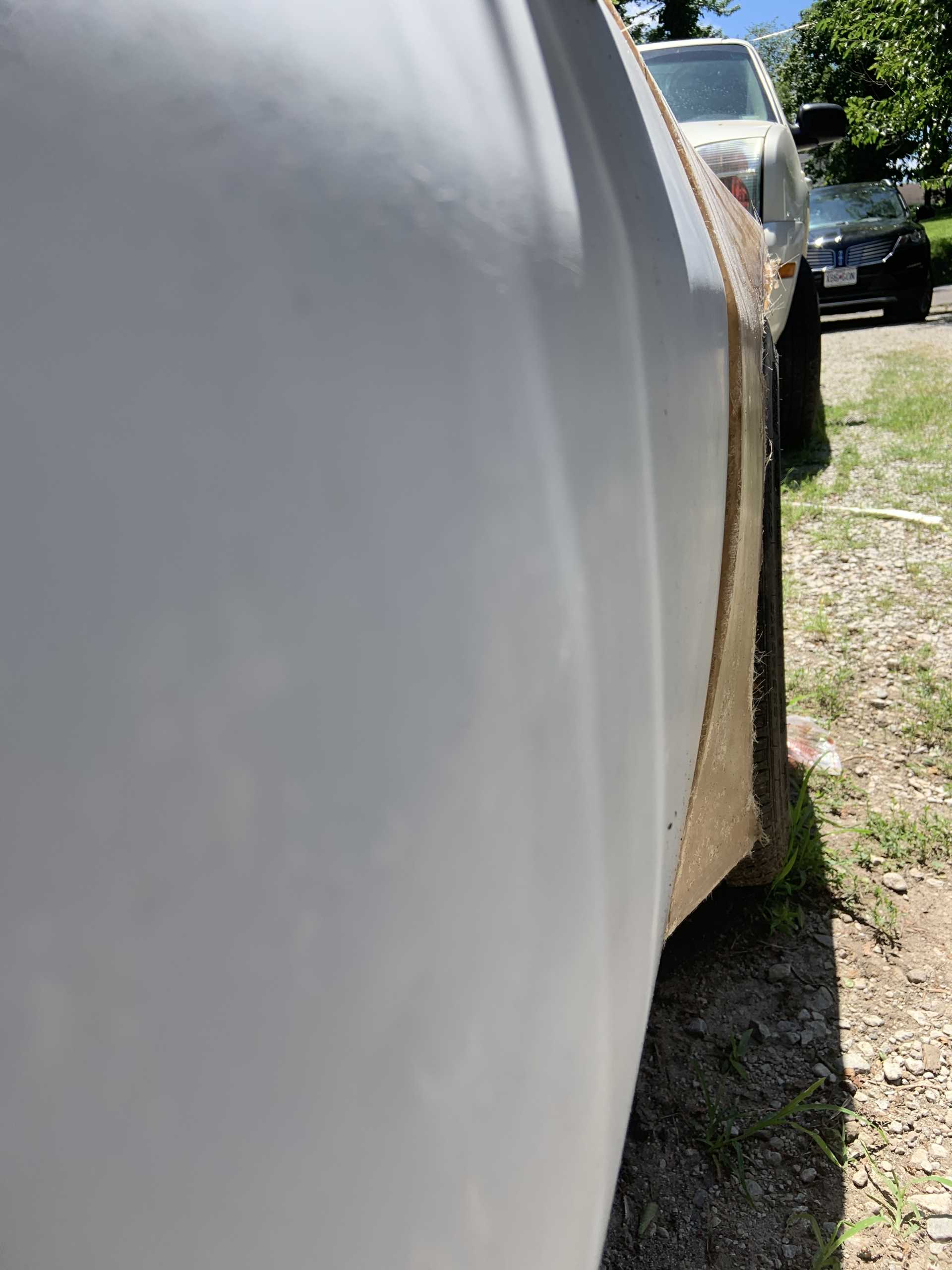

Forgive me for a lack of gel coat on these parts. I’m going into this unknowing what my results will be and really don’t want to wast the material and money. I have ran into a few things here and there that need modifications which render the gelcoat useless. Here is a fender fresh out of the mold. A couple issues I ran into while working this mold. It is a two piece and when I put the wheel arch in I rolled my glass in the actual fender it’s self so I got a roll and bubble in the glass. The second is it looks like the the wheel well is too far back and not centered with the wheel.
In the next few days I will be adressing the few issues and get the fender and spoiler in primer
