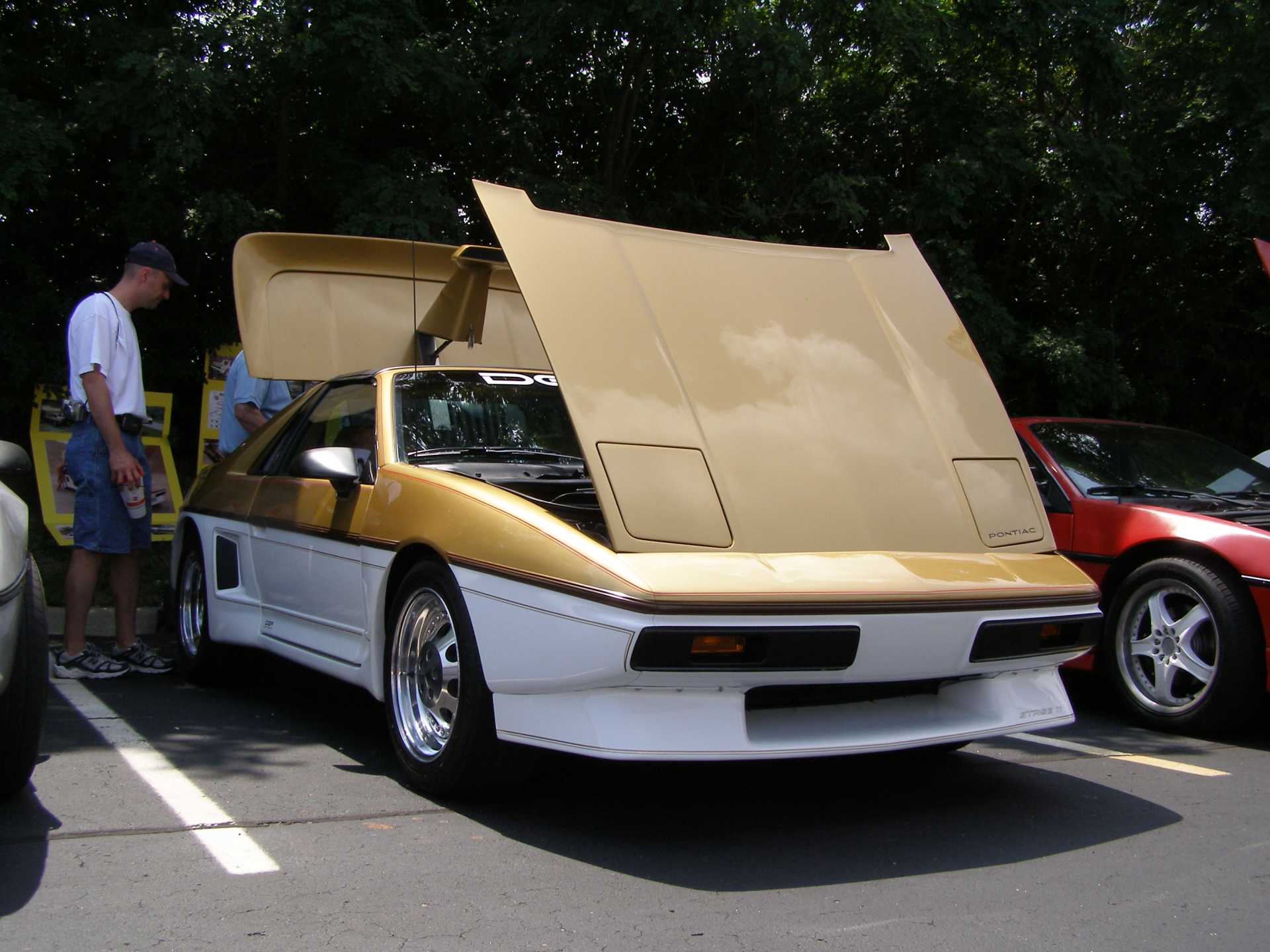

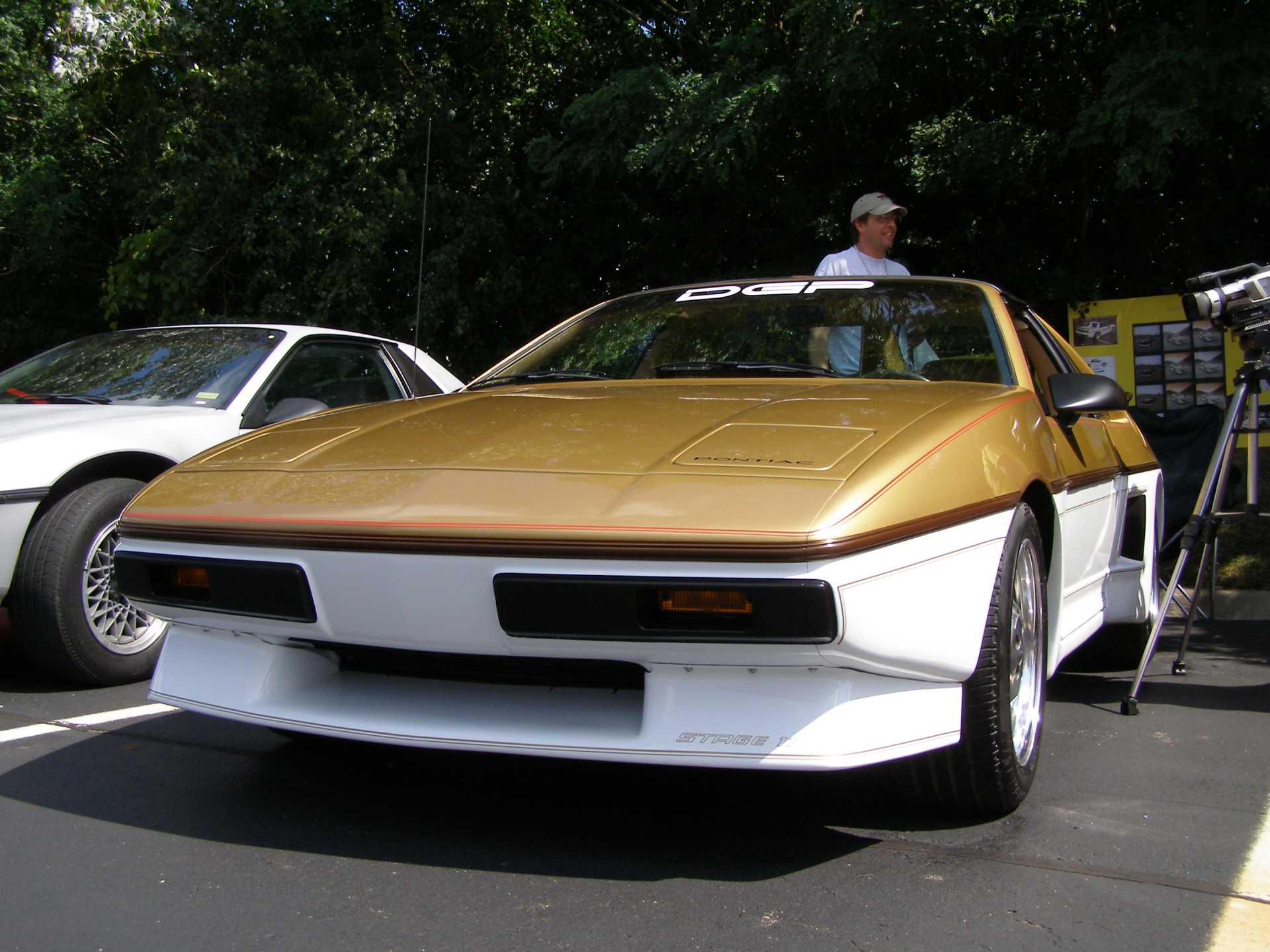

I have also noticed that on the original DGP fiero the side moldings are not moded into the body. its almost as if they were added on as an afterthought. They look like the stick on round moldings one could buy. if one looks close around the wheel wells you will notice that the moldings don't go over the body line of the arch.

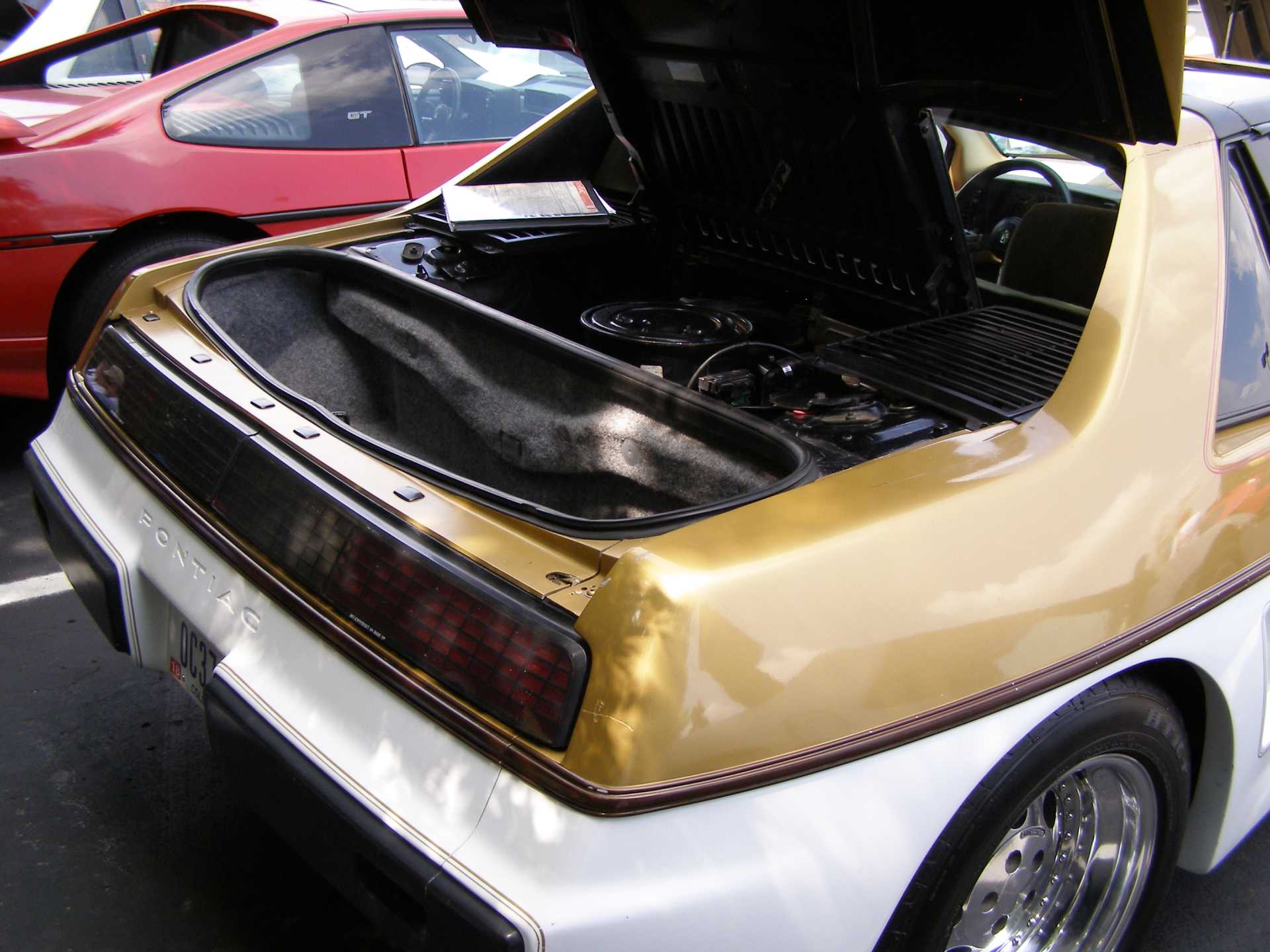

My factory DGP with a close up of mouldings Excuse the shot with ribs as my buddy was playing with my kids play dough lol
