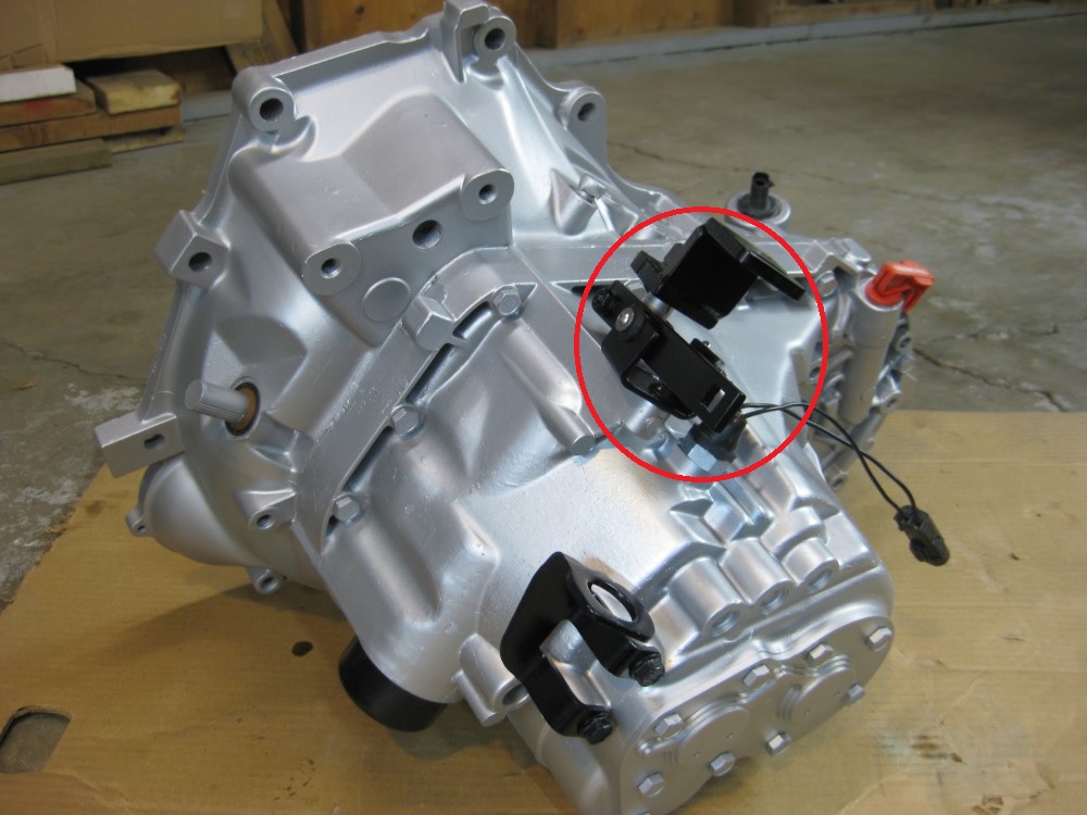

Same here. I had a new FWD Getrag (not Quad4) for my Indy but still wanted a bellhousing swap so it looked like a Fiero original. Clutch arm would be outside of case, no adapter for slave needed, and only required Rodney's shifter brackets on top of the shift shaft.
I took the bellhousing off my old Fiero Getrag and took it with the new transmission to a shop. Trans already had correct gear to drive speedo unit. They did the bellhousing swap and made sure the differential bearings clearances were right etc. Charged 2 hours labor.
IF you can find the parts for a rebuild kit, you'll have that cost + the cost of a shop rebuild. Still ends up the same, if not more (more disassembly time).

This is essentially what the original poster of this thread Backtothe80s did himself. The reverse shift rod needs to be shortened on Quad4 Getrags. He knows more than I do (I had a transmission shop swap the bellhousing and mine was a FWD Getrag).
| quote | Originally posted by Backtothe80s:
So I decided to go with the FWD HM282 (my original Getrag was tired and very few people in Canada know about them and the parts were getting up there to rebuild) and swapped bell housings from the original Fiero Getrag. I also swapped the speedo gear, shimed the diff with the GM shim tool and GM shims, cut the reverse shift rod so the case would close and reassembled. All good to this point. I installed Rodney’s FWD conversion kit so I could hook up the factory cables. |
Everything depends on your transmission shop. Ask them. They may charge an hour just to take the old one apart, then 2-3 to do the swap to the new one. If they don't know what they're doing it could take longer, or they could give up and give you back a box full of disassembled parts "no charge".
I separated my old Getrag case myself, so I only carried the Fiero's bellhousing in with the new FWD Getrag transmission. I think my guy knew what he was doing and maybe had shortcuts on swapping it over. He did it in 2 hours.
My transmission had the correct speedo gear in it - you take out the VVS and look in the trans to see if they're the same. Dickman has correct speedo gear if you need a new one. http://rodneydickman.com/pr....php?products_id=330
Once I had the Fiero bellhousing swapped over as pictured, all I needed was Dickman's Conversion Kit for the shift shaft. Apparently, the arm of this needs slight modification with the Quad4 Getrag which started this discussion (see above). http://rodneydickman.com/pr...o.php?products_id=58
The lower bracket holes need to be tapped. http://www.fiero.nl/forum/Forum9/HTML/000038.html
Some people don't like the gearing of a the Quad4 Getrag. See links to Fierobsessed threads posted earlier.
