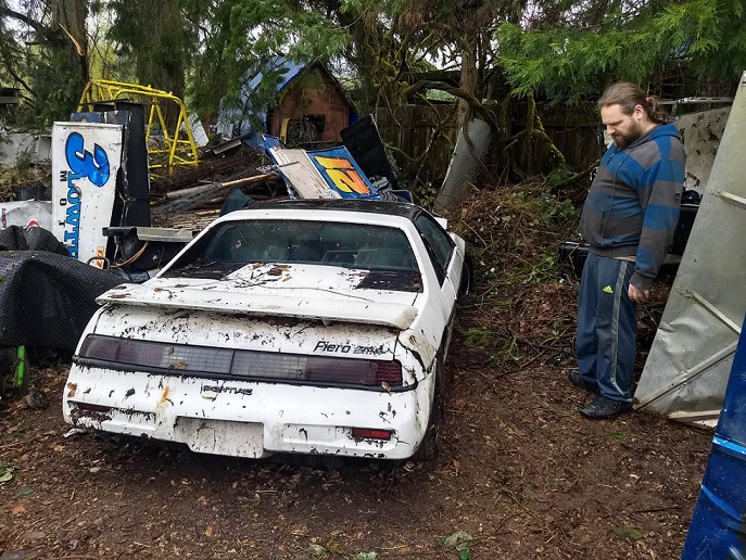

NICE! Rebuild it!!!

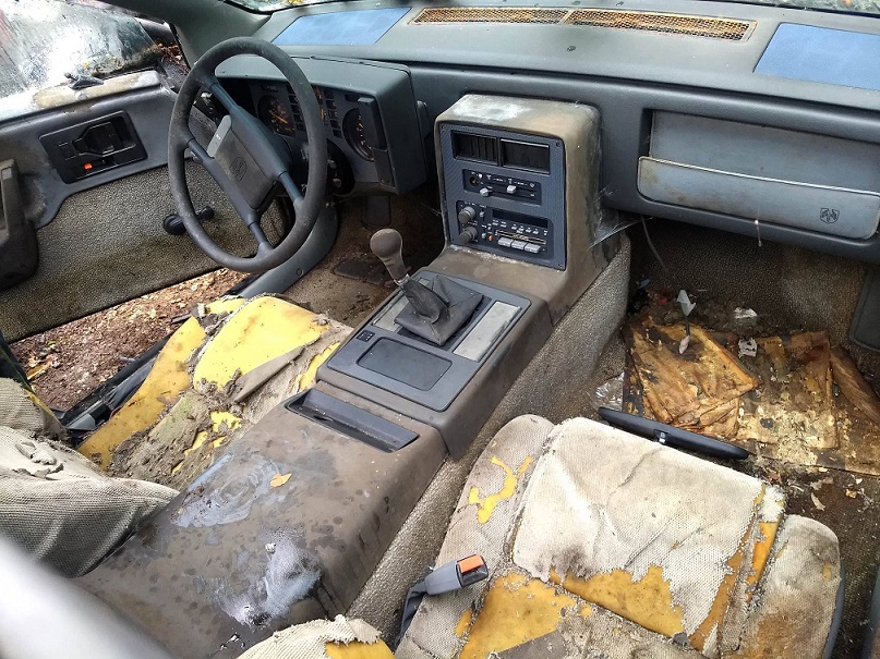

You should take the interior and other parts missing from the other Fieros before you give em to your buddy to part them out... By the looks of it, you will need at least a new interior from all that humidity! ------------------ "Discord" Red 1988 GT under restoration!

Hey...think about it...all that humidity, mold......That may be a nice FUZZY interior.........(Congrats on finding a real collectors car)

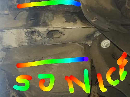

If the rest of the undercar is as clean as that one shot, you have a good foundation to build on! ------------------ "Discord" Red 1988 GT under restoration!

That's going to be a lot of work but will be worth it for sure. Keep a good log going with pictures.

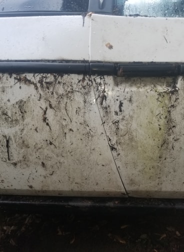

Trees normally don't fall horizontally, which is what would have been needed to push the rear of the car into the door. (looks to be 3/8 to 1/2"). It more than likely has been ran into. With it being a T-top, there isn't much structure left between the A & B pillars and a rear collision could push the two pillars together, which is what it looks like happened.
Depending on price, it will be worth buying for the 88 parts, possibly the T-top parts - all depends on condition of the seals and other plastic bits.

Wow, a no-AC model! But maybe that's not uncommon in rainy PNW. No power options either... I'm surprised it has a cassette!

No ac is extremely uncommon here, less in Canada. This is maybe one of 5 I've ever seen. I'll be picking it up on Saturday and tearing into it to see what the damage looks like under the clip. I'm thinking going tan or beach wood interior as well if the car can be fixed. Wish me luck!

The very first thing you need to do is gut the interior and throw it all away! I can only imagine what it smells like...ugh!
It looks salvageable to me. Once you get the rear bumper and clip off you can see what, if any, damage there is to the chassis. Just take care around anything T-top related...you do not want to break or damage any of that stuff.
