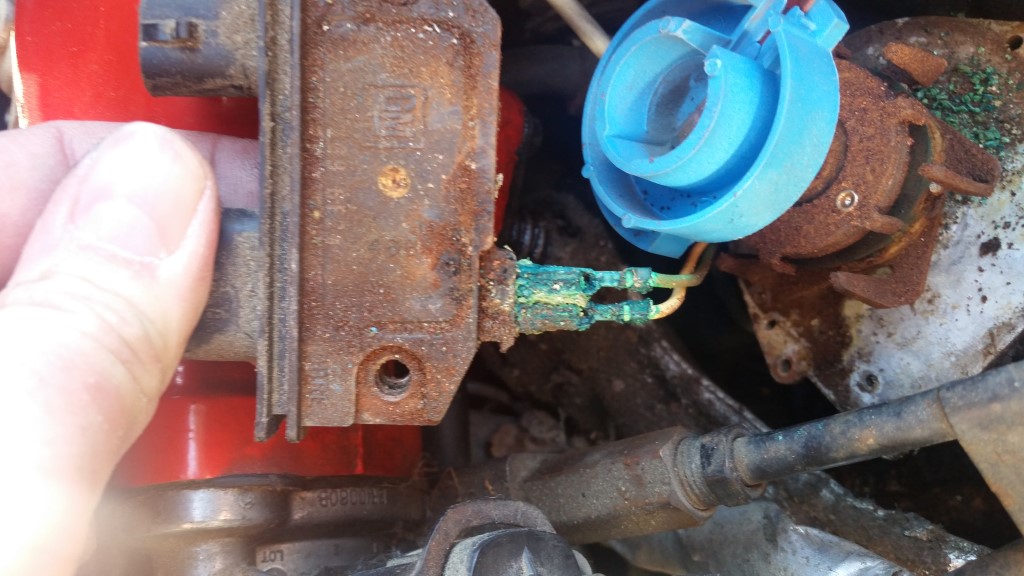

I have been reading up on the ignition system now, and just as said here the pickupcoil and ignitor module seem to be weak points.. Also oxide in those connectors.
So today I opened the distributor and disconnected the pickup coil, this coil reeally look bad, and also the connectors.. wow, im surprised the engine started at all..
.jpg)
I cleaned everything very well, both the superseal connectors (no oxide there that i could see, but anyway..) and then the pickup coil connector.. this was not very easy but finally I cleaned them and I measured with an ohmmeter, no contact with ground and 820ohms over it, thats perfect due to my haynes-book.
So it seem to be ok even if it look like sh*t.. however, since they are prone to fail and it looks like it do i will do as rexgirl suggested and buy one..
I also cleaned the connectors to the ignition coul, again they looked fine but cleaned anyway.

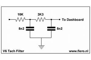

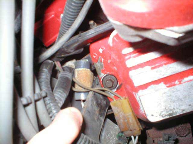

Since your black Ignition Module sends a signal to the tachometer, and then on to the ECM, your IgnitionControlModule is at least working partially now. If you cleaned all the rust off the Ignition Module's mounting screws and it's grounding tubes, it's still possible that the ICM is failing or yes, the tach filter is not operating correctly. Here is the location of the tach filter (thanks Derrangedsheep) :
and here is the tach filter schematic:

BTW, the polarity of the pick-up coil wires into the ICM matters, so it's important that the wires are returned to their original terminal. New pickup coils have a connector that properly connects these wires, but yours has disintegrated. It's also typical that the wires loose their color and appear white, so you may want to use the picture you posted here as a guide.
