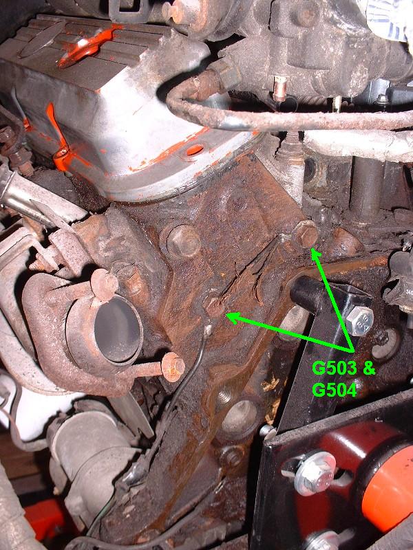

The next step probably will be to ensure the grounding, does anyone have a pic of where the groundcables are attached ? as I said I only found one, and that didnt look that nice,

I just went out and looked for ground-cables..
The one front right I found before, it exist but is in bad shape.
The one rear right is simply not existing, i find the bolt it should be on, but there is no cable.
The left one I didn't find, I found one going between the hinge and then into a bunch of cables, but nothing between engine and chassi, not sure it it should be or if I found the right one.
It sure could be the source of problems here, one groundcable in miserable order, and one missing..
I'll try to buy some tomorrow, unfortunatly the nearest store doesnt seem to have any long cables, they have the one front right, but not sure if 35cm is enough for the one rear right.. hmm.

Rexgirl JUL 02, 05:58 PM
Here is a pic (thank you Bloozberry) of your ECM and some sensor grounds. They are on the driver's side over the starter and clutch arm.

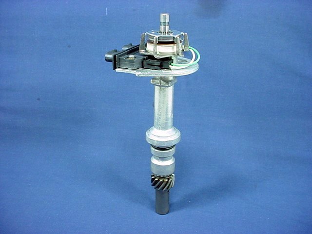

BTW, since you ordering from Rockauto, it might be wise to buy a 'Distributor Pickup Coil' as well. It is the white disc with the green and white wire leads pictured here

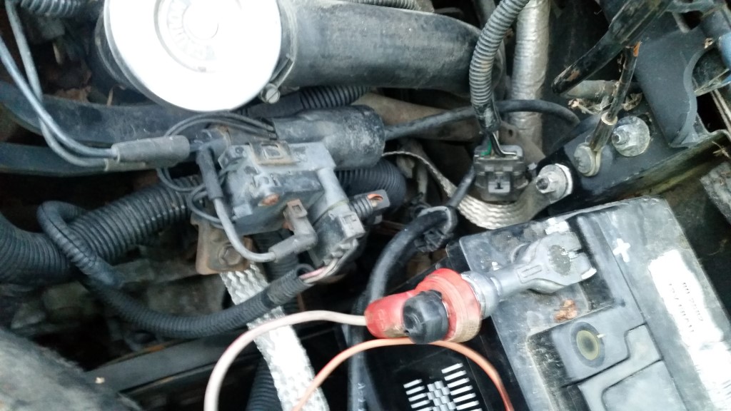

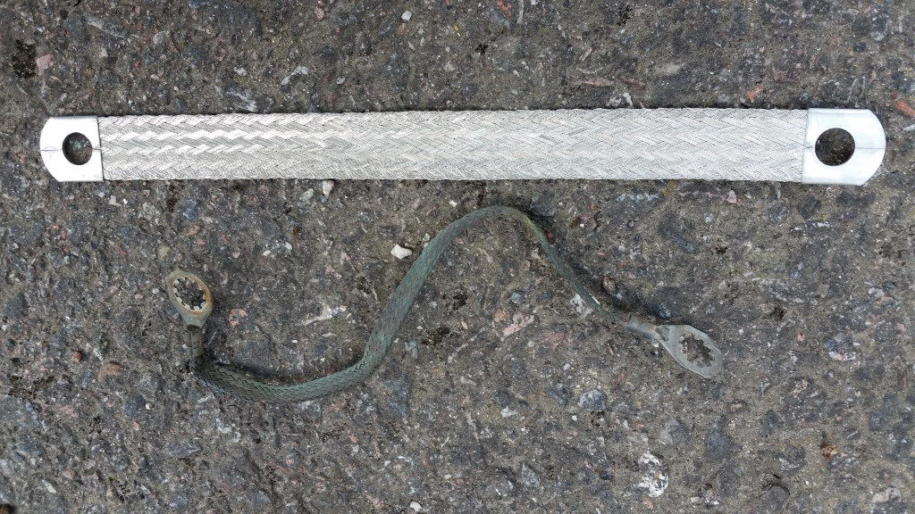

Today I bought two groundstraps..
First I replaced the one between the hinge and the engine.. a bit difference..
I also replaced the one between the blockm and the battery.. I would have liked a cable here but the only thing i could buy was a braid.
I dont have to tell you about all the problems I got then I first dropped a nut down in the engine and had to find it, and also destroyed the threads on the battery adapter so I had to modifiy it to be able to use it :P ..I solved the problems.
..Well, did it help ?
NO.
The engine still have big problems starting, and when it do start it misfires..
HOWEVER..
The old groundstraps where bad, because now the starter motor spins faster than EVER, the front lights are brither and so are the interior lights.
..So it was a good thing to fix anyway.

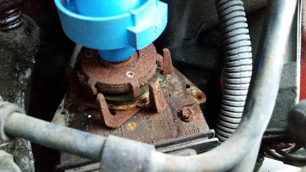

I took apart the distributor again to clean it, and took a photo of it.. doesnt look very nice..
Rexgirl: why do I need a new pickupcoil ? ..it sure doesnt look very good when i looked at it, but is it a common problem ?
