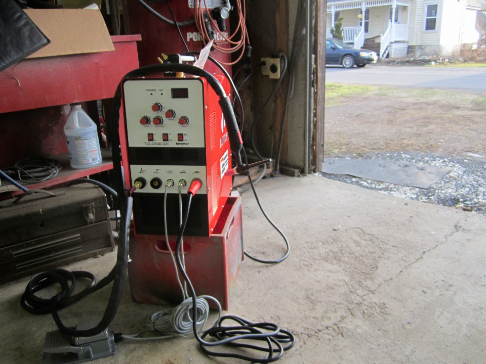

I bought this tig welder for my shop. It's a little on on the low end but I think it will be good for hobby use along side my old mig. I have yet to get the tank and some supplies.
So it maybe a month or two before I get back to the Fiero for this year. Updates will be coming soon.

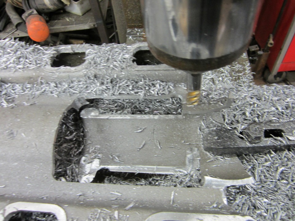

You can see the bottom half of the small tube that runs from the throttle body flange half the way thru the the upper 3500 plenum. Its too small and long for my needs I think. I milled it all away. This big opening will be closed with 1/8” aluminum sheet.
You may also see the six port openings have been enlarged to the full size of the gasket. I will roll the edge later, when cleaning up the welds.

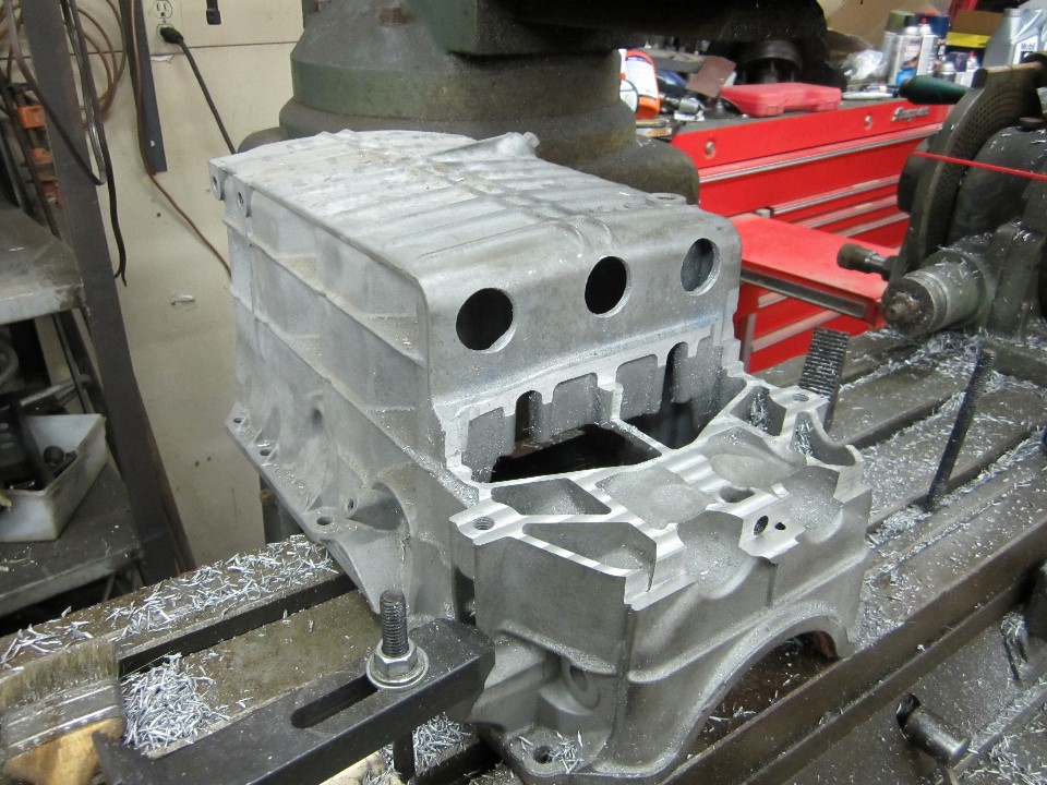

What is this __ doing now? I intend to enlarge the oil pan into the space the exhaust would use. I am leaving that area with the three holes as a dam to help control oil sloshing away from the pickup. I intend to make one-way doors to help by closing off the holes. This oil pan is from an uplander (?) and not the G6,and dose not have the recess for the filter. A little more room there to.
