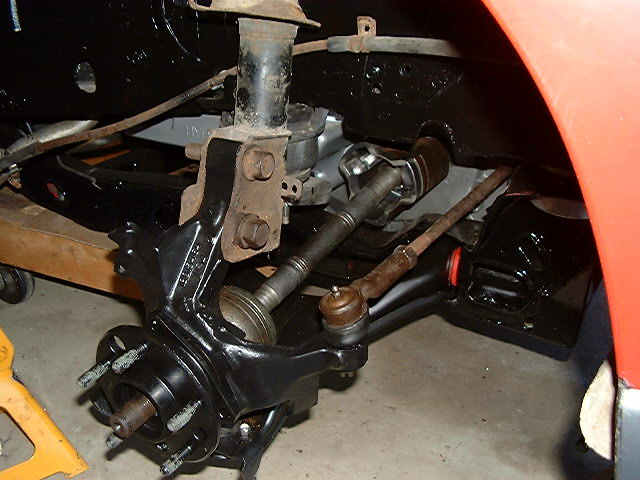

A few pics from mine:
Hats during cleaning:
The old strut, minus the spring, on refurbed suspension, measuring axle length:
Installed:
Different view and one of the holes I need to fix:
I used 7" perches for Monroe shocks from Speedway and KYB struts and QA1 300#, 12" springs from Summit.
Bob

Hi Folks
Finally finished my conversion over the weekend.
How it looked when I started
Old and new side by side
New strut in place.
After I finished the job,I went out looking for potholes, sleeping policemen, and cats eyes, and was really pleased with the results. Although the suspension still needs to be properly set up front and rear, I was surprised by how smooth the ride was - I had been worried that the 375lb springs would be too stiff, but that isn't the case at all. Interestingly, there was a minor, but obvious difference in the angle of the struts at the knuckles when I started (they are much closer to the same angle now).
I initially set the height by eye before installing the struts and am about 1cm too high (compared to standard) so need to drop them a bit, next time I'm at home and it isn't dark and it isn't raining...
Ciao!
