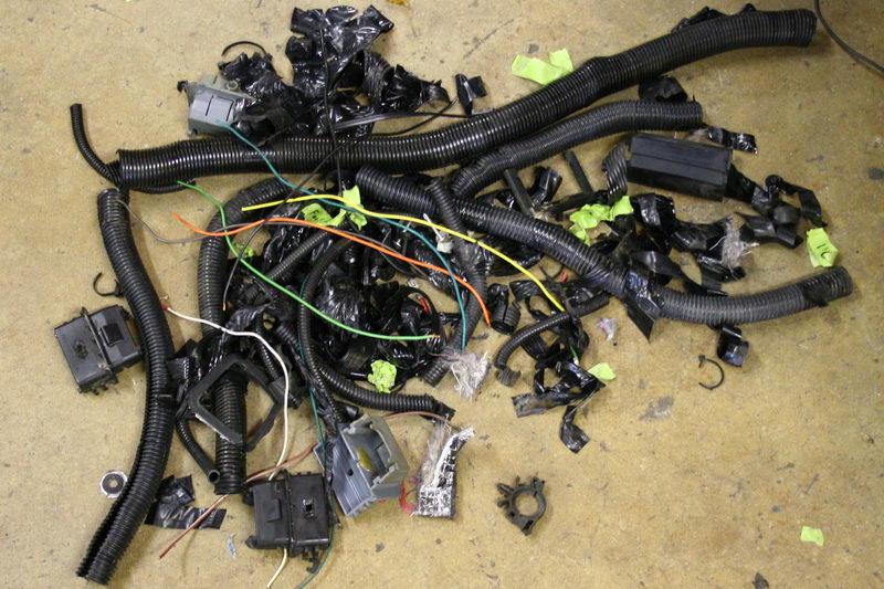

Stuff taken out so far...the trash pile gets bigger
New lid shock installed
and bigger!
