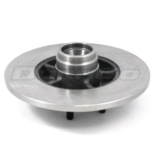

Report this Post07-29-2020 12:22 PM Click Here to See the Profile for cvxjetSend a Private Message to cvxjetEdit/Delete MessageReply w/QuoteDirect Link to This Post
Patrick- Maybe he has a three-wheeler....
Cliff, Amazon has them in the US...I suspect you could get them to send one thru Amazon UK......Bendix Brakes PRT1286...
But the back will look like this (The HUB is integral)

cvxjet
3934 posts
Member since May 2010
I guess that I should first PREVIEW every picture post- I do not fully get the damn "Want to overwrite image" crap....
The threewheeler image was supposed to be this;
And the front of the hub looks like this;

If the photo from the part in the link is correct, you must have a 1988. If that is the case, all of the wheel bearing and seal stuff may not apply, although checking the bearing and seal while you are there can't hurt. If I could read the language in the link, I could better answer your question. Sorry.
