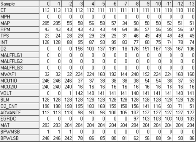

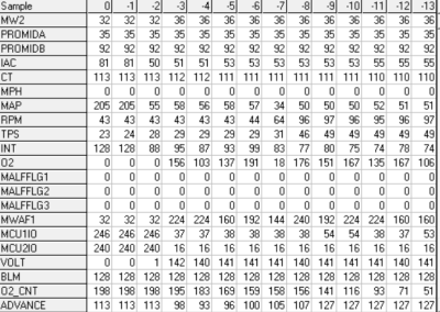

So I picked up an aldl cable to get my readings, check for codes, senors working ect. Now all I am trying to do is compare these to a fiero thats not running poorly like mine(poor acceleration under load) and see if it will help lead me to the right thing I need to fix or at least a general direction. So I came to the place with all the smart people because I couldn't find anything online, in my user manual, repair manual, ect. My car is an 85gt 2.8l .
RWDPLZ
Posts: 15087
Registered: May 2002
Total ratings: 305
Report this Post04-03-2020 04:42 PM Click Here to See the Profile for RWDPLZSend a Private Message to RWDPLZEdit/Delete MessageReply w/QuoteDirect Link to This Post
Hard to say without more context, but what's with the single low oxygen sensor reading, and the coolant temperature never changed from very cold? How long was the car on? First few readings appear to be before the car was started, and with it just sitting there in park/neutral?
Ya so first reading was car at idle and then later readings were reving car

Patrick's graph showed coolant temp going from 87 to 208. Your coolant temp is going from 113 to 110. Something is not right there.

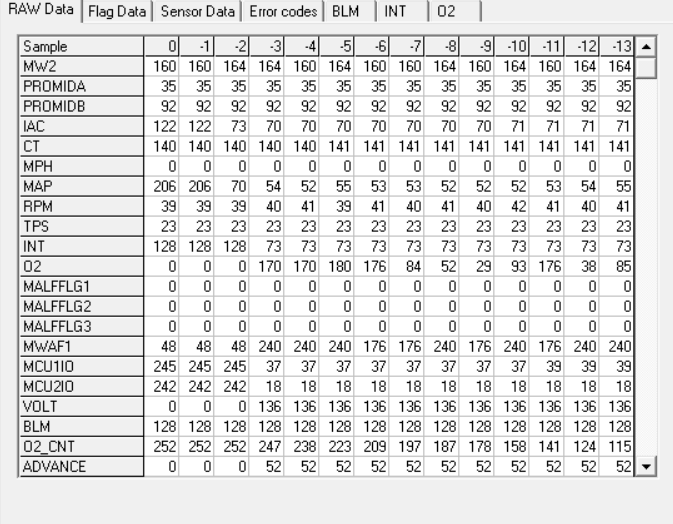

This was taking the car for a drive after it had warmed up for a while
Posts: 39490
Total ratings: 464
Report this Post04-03-2020 09:30 PM Click Here to See the Profile for PatrickSend a Private Message to PatrickEdit/Delete MessageReply w/QuoteDirect Link to This Post
I don't see the Manifold Air Temperature readings at all, and the maximum Coolant Temperature of 141°F is way too cold.
Do you actually have a thermostat installed? If you do, what temperature is it rated at? Should be 195°F.
Ya know thats a good question lol, when I got the car there was one sitting in the trunk that looked kind of roughed up and I ended up throwing it away because I assumed the previous owner had swapped them and just hadn't gotten rid of the old one.And I can post the MAT readings from warm drive if that would be helpful?
Posts: 39490
Total ratings: 464
Report this Post04-04-2020 01:44 AM Click Here to See the Profile for PatrickSend a Private Message to PatrickEdit/Delete MessageReply w/QuoteDirect Link to This Post
The last thing to do is to assume anything about a car and how it's been previously treated. I suspect you have no thermostat installed. Spend a couple extra dollars and buy a superior 195º thermostat - Stant SuperStat 45819.
