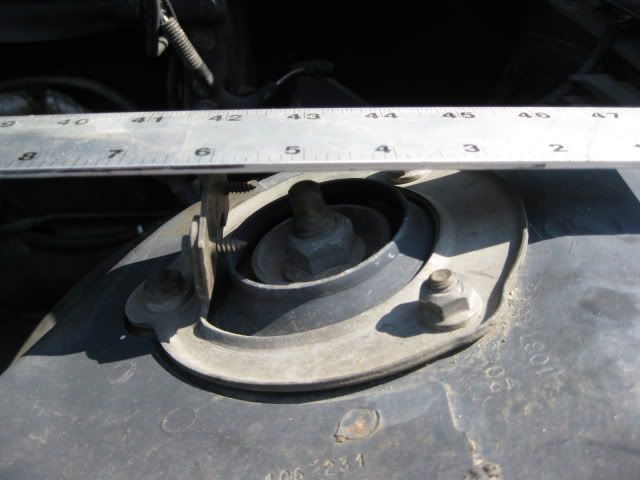

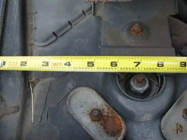

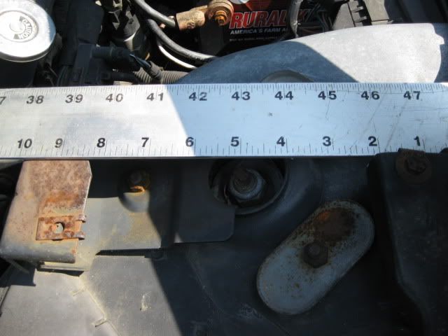

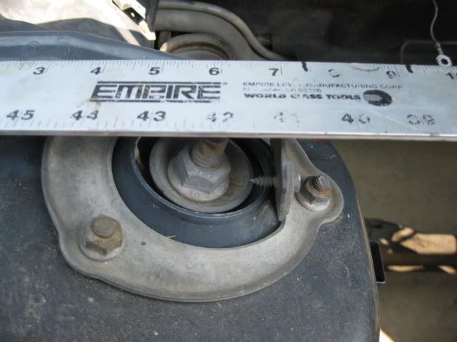

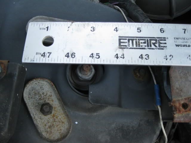

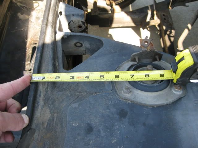

It used to be commonly referenced as 1" forward and 1" inboard, but that isn't exactly right.
1" forward and 1 5/8" inboard is more accurate.
84-87 Trunk wall lip to center of strut:
88 Trunk wall lip to center of strut:
84-87 distance between strut shafts (40 1/4"):
88 distance between strut shafts (37"):
