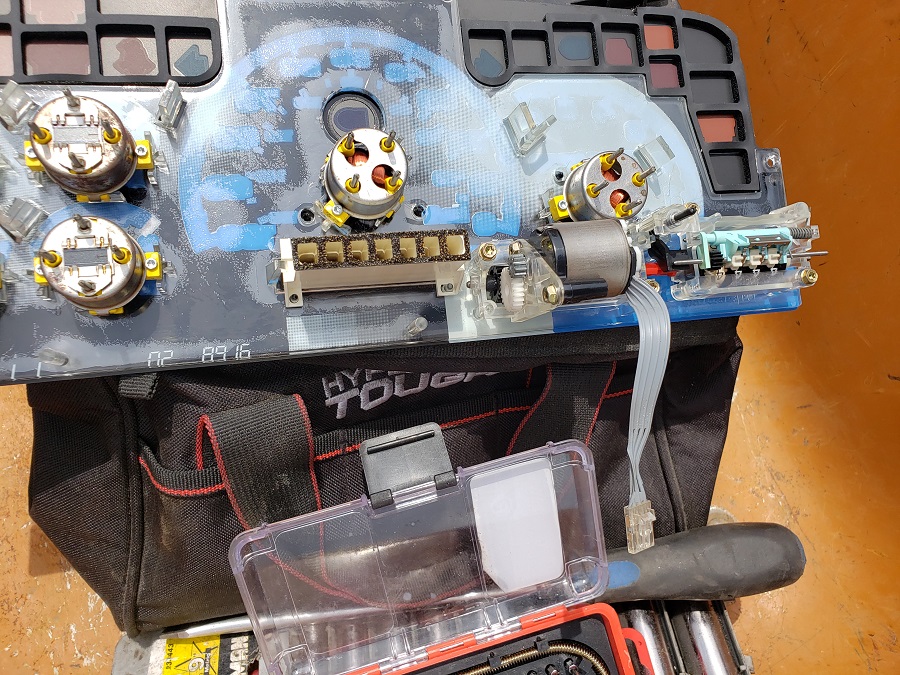

Report this Post07-29-2020 12:02 AM Click Here to See the Profile for hercimer01Send a Private Message to hercimer01Edit/Delete MessageReply w/QuoteDirect Link to This Post
I found this, it's from a 95-99 Tahoe. It's the drive motor for the trip and odometer both.
It is interchangeable for the Fiero both motors but the Fiero connector needs to be swapped over.
I used a spoon to push the motor posts down while I pried the disc off the back of the motor. I tore up the first motor.

Report this Post07-29-2020 01:58 PM Click Here to See the Profile for DLSMI 85GTSend a Private Message to DLSMI 85GTEdit/Delete MessageReply w/QuoteDirect Link to This Post
I replace the servo motor for the odometer on my 85GT last year. I found the part on a Corvette site Batee.com part number A010. It took about an hour to replace it.
