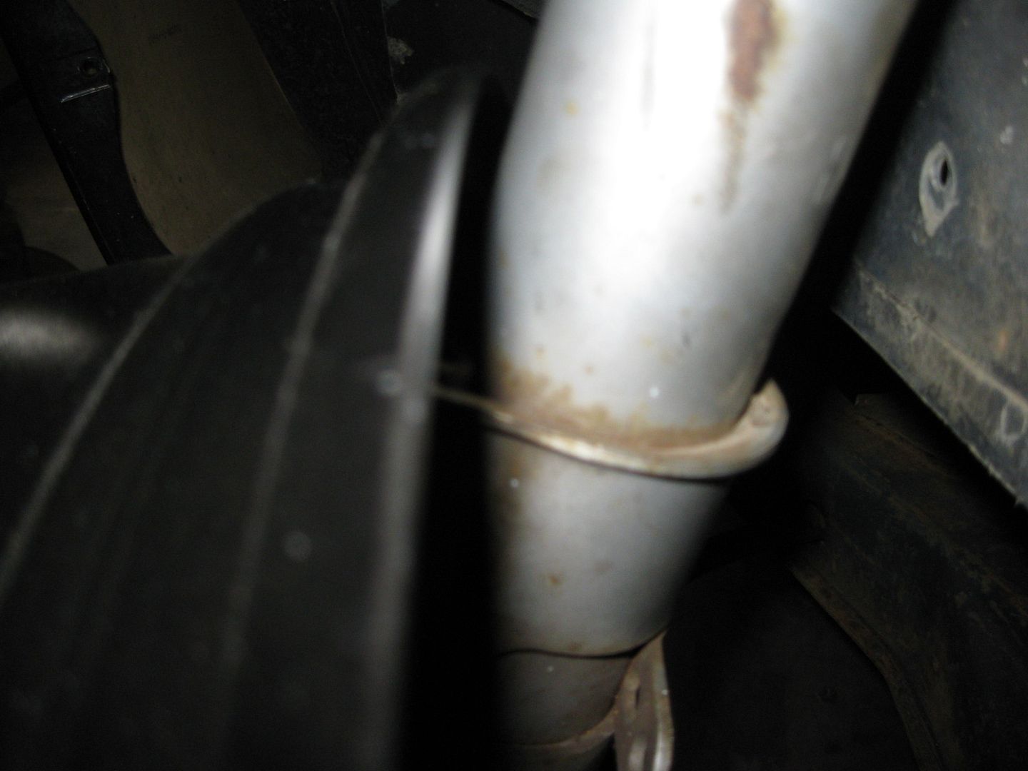

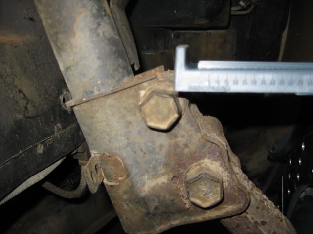

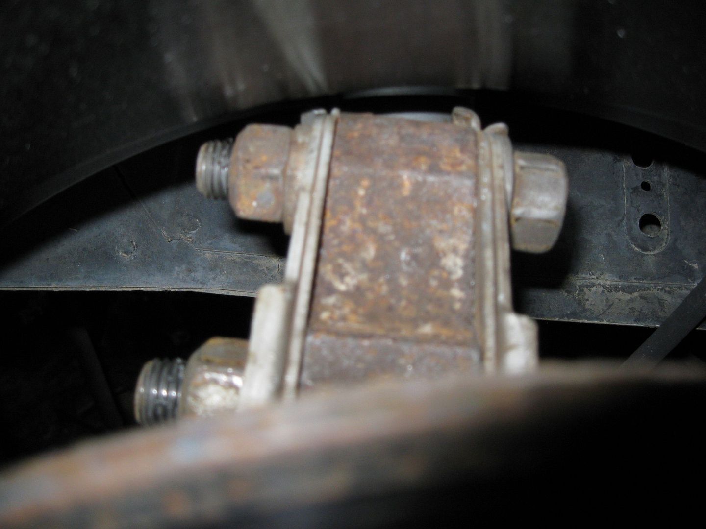

Depending on how deep the offset is, 17" wheels will likely hit the mounting point between the strut and the suspension upright. The picture below is an 88 and I think the 84-87 mounting point is slightly lower, but probably not enough. The tool was set to 17", so for me 18" is the minimum wheel diameter to maximize wheel width.
Here is a good drawing that Blooze did for a 18x 10 1/2" Vette wheel and the 88 suspension, followed by some actual mock up pictures. Notice the inside of the wheel just barely clears the strut/upright mounting flange. The other thing to notice is how close the inside edge of the wheel is to the strut body. If you run a coilover sleeve all the way down to the base of the strut, it may not clear, so it would be best to mount the sleeve off the weld bead for the stock spring perch.
