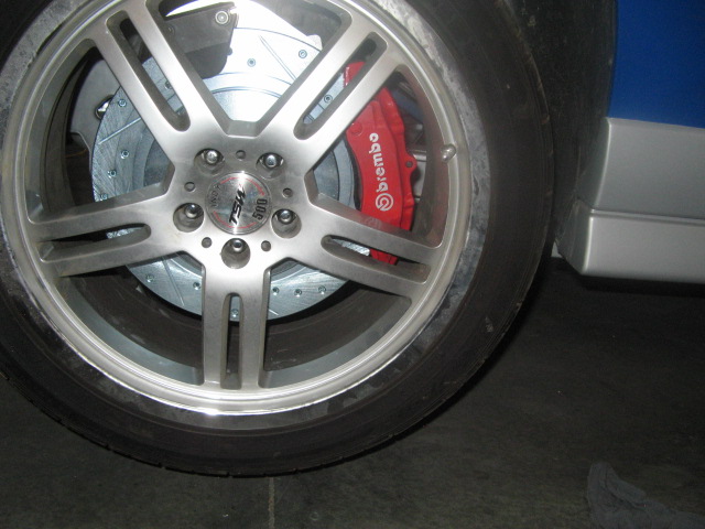

Here are some pictures of the current brakes on the car with 18" wheels:
Any of these kits will provide more brakes than you need and the one above is incredible and great for bragging rights. The Vette setups retain the Vette E-brake and the Brembo setups have a spot E-Ebrake (sort of my idea) which is weak. WCF is working on a better E-brake to replace the Wilwood spot setup.

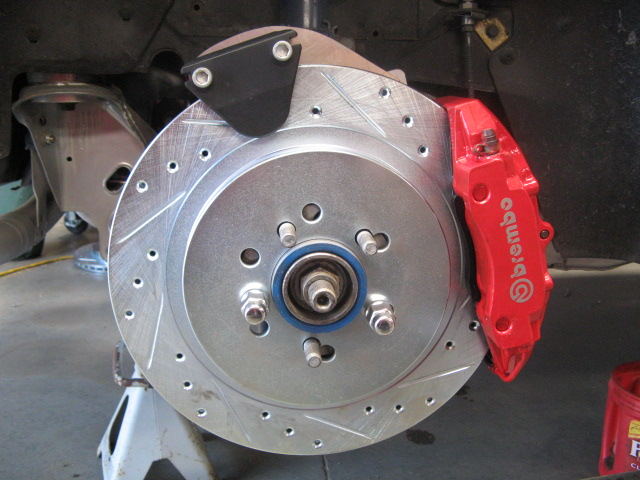

I supplied my own 2000 Porsche Boxter calipers, cleaned the repainted them and put new decals on them and replaced the pads with a German brand. The calipers did not need to be rebuilt and they work just fine after two years.
Here is a pic of one of the 13" Viper rotors.
