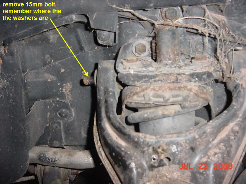

Can the front bump stop be removed so that I can take it off, and fix it as I will be cutting 1.5 coils off the front springs. I did search and couldn't find the answer. I haven't started on the front yet so I haven't looked myself, and couldn't find anyone with a portable welder to come to my house and do this. And from looking here I saw that it might be possible to take the whole thing out and bring it to my work and have someone do it.
I saw this pic, and it looks like it might come off, does anyone know for sure. Looks like 3 bolts on the side holding it, and 2 bolts holding the bumpstop down.
Pic is from MulletproofMonk https://www.fiero.nl/forum/Forum2/HTML/094633.html and thanks for that guide, its really helping out, already have the rear done. And also thanks to Redraif for his guide https://www.fiero.nl/forum/F...118751.html#lastpost as it helped me do my own diy coil overs.

If you want to get it on the ground to work on it, you have to take the whole crossmember out... Otherwise the bump stops are exposed when you take the upper and lower control arms out (and spring).

I managed to cut mine and re-weld it in while still having the A-Arms attached and cross-member in the car. It was a little hard to get in but I got it, it was also hard to weld the back side.

Same, I had to lie on my back to weld the backside. You really need a dremel with a cutoff wheel for cutting out the very back. But Yea it really was not hard.
The first cut comes out really bad, but it is really easy to clean up the part you cut off, and the part still attached to the car I just took the grinding wheel and pressed it flat against the bottom of the cut and it flattened it really nicely.

I did it to a spare crossmember and swapped them out. That conical shape is real hard to get a straight cut on. Also, remove the bumpers AFTER you cut the bottom of the stop off. It'll take a LOT of lubricant and a dull screwdriver to push them out without ripping it in half and rendering it useless. Then you just pop it back in after your finished welding. If you take it out to this, it's also a great opportunity to weld the upper control arm shaft tubes. They have a tendency to break off as they age.
