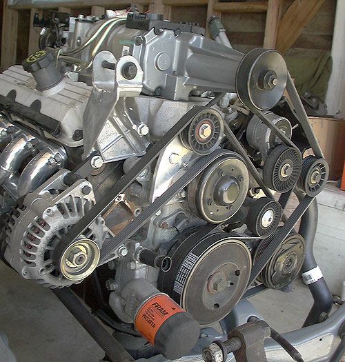

When I have swapped 3800SC's the alternator gets moved low and the power steering pump is trashed.
I wish someone would show me how to run the belts on the 3800SC without repositioning the tensioner.
Look below:
Now if that tensioner wasn't re-clocked (or another one used) to push up at a higher angle the belt would be hitting/rubbing the water pump pulley that already has a belt wrapped on it. Notice the interference when the tensioner is not at the right angle on this photo.
