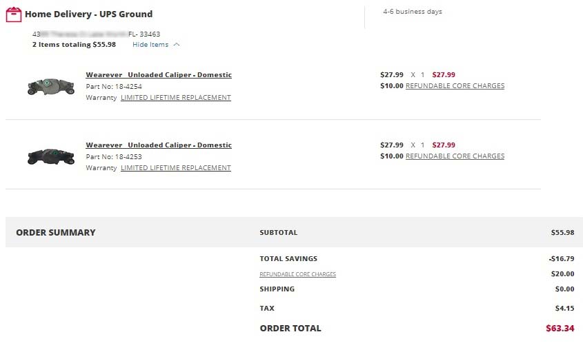

Sounds Good, Thanks! I split the difference in the year range and used 1986, which happens to be the year of my Fiero. There is a 30% off promo code for Advanced AutoParts I found with a Google search
I will get $20 back when I take the cores in to my local store, bringing the total to $43 for new front calipers, with free shipping.
The Promo Code I used is: DY5DBX
