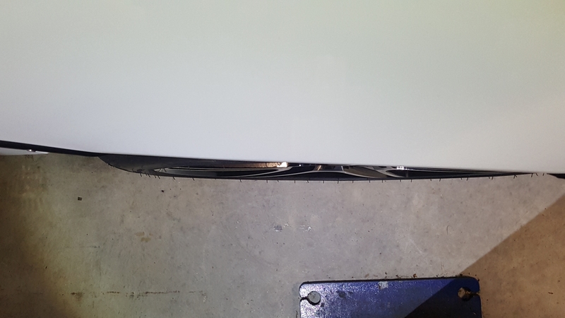

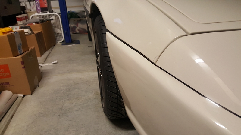

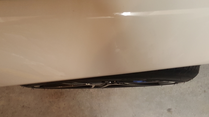

Yes, you are correct, did not notice that, but 5mm is less than a 1/4 inch(5mm = 0.19685 inch). So you are adding 0.19685 inches out to the finder. Just look at the 8.5x35mm and move it to the right to almost half of the distance to the 8.5x26mm. The rim will be past the fender wells. The tire will probably be another half of a inch past that.
Here are some pics of my 17x7.5 rims. Yours will be around 3/4 of a inch out further due to the 1 inch bigger and the 5 mm offset difference.
Keep in mind the front fender of the car curves in.
This is the rear
In front of car
