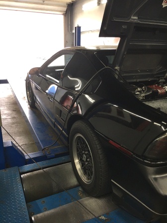

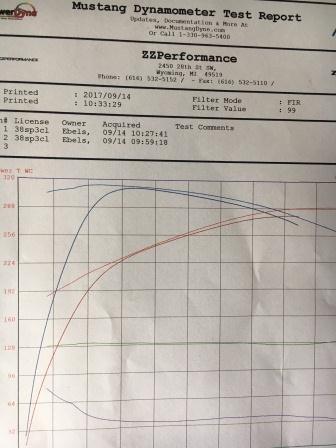

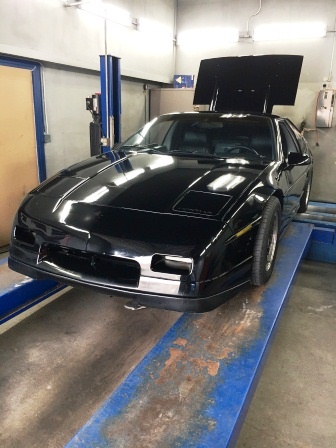

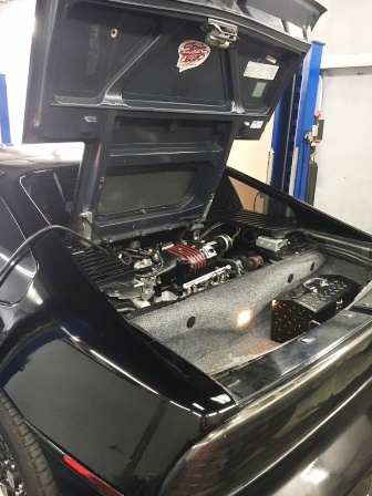

Dyno Day at ZZP here in Michigan!
I am very pleased with the results. The car runs awesome. 290rwhp @ 315lb/ft of torque! The tune is still pretty conservative and great for weekend cruising. She still has more in her but I am happy right now with where she sits. See my signature for mods. Thanks for looking!
'87 GT - 5spd, Project Car- 3800SC II: Full Rebuild, VS Cam, 90# Springs, 3.3 pulley, TOG headers, 3.5" CAI, WP underdrive pulley, A104's, 180* thermostat, 36lb injectors & SPEC 3+ clutch- 38SP3CL

How dare you test this beauty on a "MUSTANG dynamometer"?? I want a recount.

Yes I've heard about Mustang Dynos supposedly reading low but I've also heard that they give a more accurate number than others. I believe some dynos inflate numbers a bit.

Dyno's are subjective. Best to use same machine to get baseline, then go back to same machine after upgrades to judge effectiveness.

I automatically thought about how mustang dyno's read lower than a dynojet etc.
I didn't catch that when I read the first post. Those are great numbers for that dyno.
