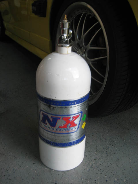

After near a 5 year hiatus I am finally installing the nitrous kit back on my yellow car. When I had the stock 2.8 with automatic I put this kit to have some fun. The 75hp shot made a nice difference and ran about 5-6 bottles before a transmission fluid cooler line blew off and I stopped the car to put the 3.4 I took out of the red car.
So after many obstacles I finally got this car running in spring of this year and now has a 5 speed with a slightly modified 3.4. It has the Truleo intake, 272 cam, FOCOA headers and most of the other common little things we do to these engines.
I did a search on nitrous and found almost nothing from the latest (non archives). So maybe it seems very few has interest on this. Still I'll post what I did, what I am using and how it goes. At some point I plan to take it to the dyno (maybe January) and measure the difference. So let me know if some of you are interested on this.

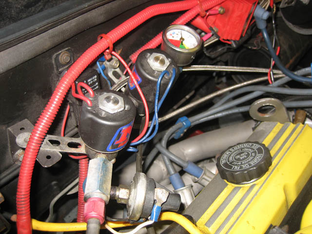

Good. This is what I have istalled. I'll ID the components I am using.
This is the hardest part to install. Buch of hoses and wires/relays. #1 is the fuel cut-off switch and is a very important item. If fuel preasure drops it will kill power to the system. #2 is the fuel solenoid and it connects on the side to the fuel rail and on the bottom to the hose that provides fuel to the nozzle. This is a wet system. #3 is the nitrous solenoid. #4 is the preasure gage.
Here you can see the fuel connection. You need to remove the shrader valve.

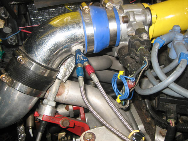

This is the nozzle at the intake. Both, fuel and nitrous go in and a spray combo goes out into the intake. Here is where you change the jets to adjust for power level. There are jest for both, fuel and nitrous.

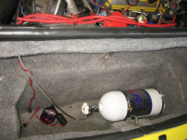

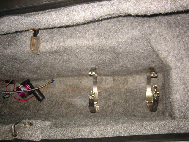

Brackets in the trunk
10lbs Bottle
All in. The bottle is tilted a little to compensate for liquid movement when accelerating. All the components above are NX.

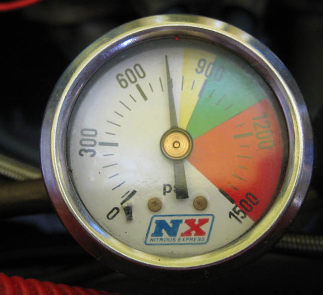

Back when I bought this they wanted me to buy a bottle heater. I said no because I thought living in south FL is hot enough that I wouldn't need it. Later on I found out what a big mistake that was. It is not above 85°F all year round here. You need that bottle pressure at 950psi to get the best performance and to extract the last ounce of it. Yesterday I went for a test drive. I knew the bottle was low but pressure was a little above 900psi. I was getting 10 AFR and it felt and sounded like cycling on and off. I'll fill up the bottle and try again. If it still does that then I need to check if the fuel pressure is keeping up (cut-off switch cycling on/off) or if the nitrous solenoid is sticky. With AFR at 10 the fuel seems to be coming out ok. Oh, and I need to get a bottle heater. Today may be the last day I could do a good test without it. A cold front is coming and temps will stay at 50°-70° which is not good for it...

This is why nitrous is useless most of the year on most parts of US without a bottle heater. It was 55° here last night and now is at 72°. The picture was taken after a 20 min lunch drive so the trunk was a little warm (it now does have a full refill). If that needle is not at the top right of the green area you ain't getting anything. I need to get that bottle heater...
