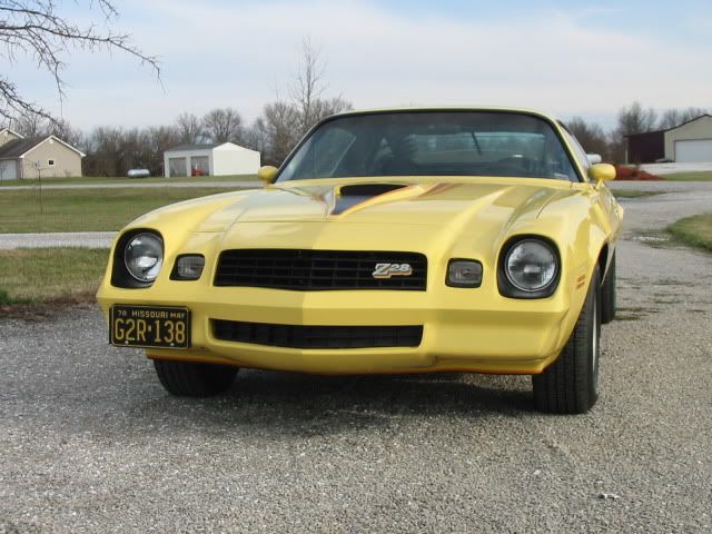

I painted this 78 Z-28....

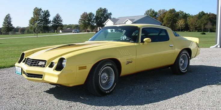

and this 78 Firebird
and many others with this gun....
http://www.harborfreight.co...spray-gun-66222.html
