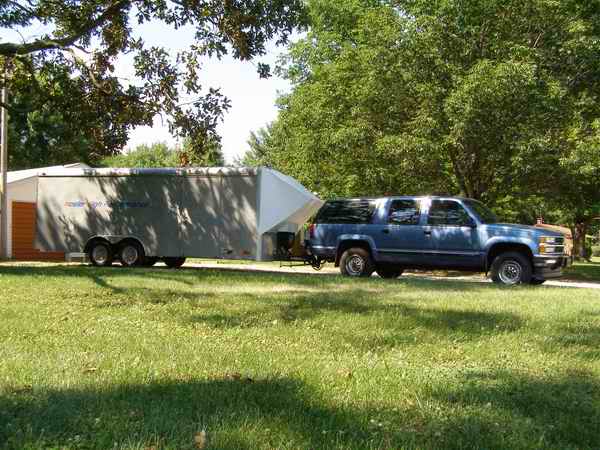

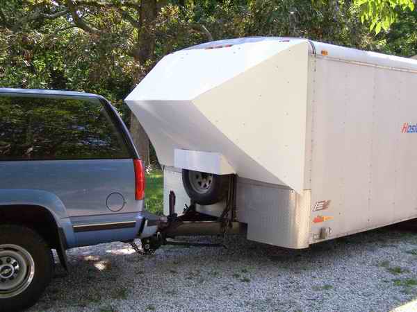

Well..... Here is the finished product. At least I hope it is.
I have assembled all of it but have not taken a test drive yet. Currently my only concern is the side pieces flapping which may be able to be controled by some white duct tape (just the 7" that is hanging off). However, I figure that the wind will simply push them against the trailer. I guess I will find out soon enough.

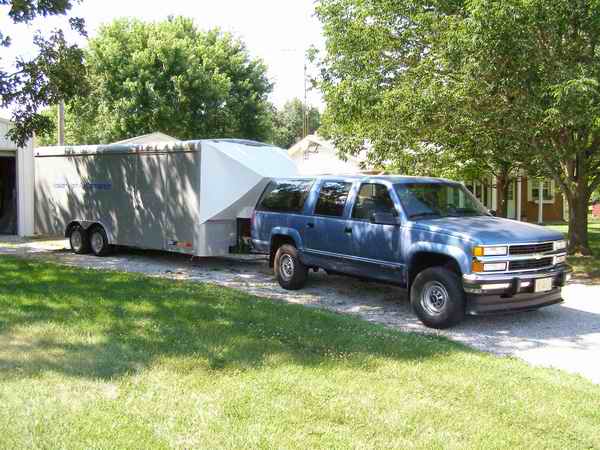

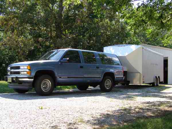

So I took it on a test drive this afternoon on about a 25 mile round trip. Pictures of the whole rig ... (I love my new truck )
The test drive.........
I started out slowly to make sure that nothing was going to come loose or that panels would deflect. I was watching in my mirrors as I slowly got to 55 MPH. Piece of cake! Everything was smooth. I definately noticed that it did not feel like towing a brick anymore. I can feel less pull from the trailer on the truck at speed. So then I tried to pick up the pace until I started to feel the trailer drag in the air. I had a difficult time finding this point because everyting was so smooth. I even forgot to engage my anti-sway friction bar and did not notice any problems. Tracked straight as an arrow. I was able to steadily cruise at 76 MPH before the truck felt like it was working a little. Granted, the trailer was unloaded, but it was the aerodynamic drag that I was trying to determine.
I am happy
However, with all of my projects, there are areas for improvement.
- The gas strut idea works fine, but it needs to be a little more beefy or better angles. Yes, it does clear the doors so "mission accomplished" but I wanted it to have some authority.
- Spring latches would be cool to lock it into place and not as combersome as the loop / bolt method I have. On a positive note, there is no chance of mine coming loose and flipping up.
- I need somthing on the sides. I will be making the "triangle" cones for the sides that will divert air that is on the side of the truck. I will not be able to make that one in time for the trip to Frazee.
I am very interested to see what my mileage is on this long trip.
