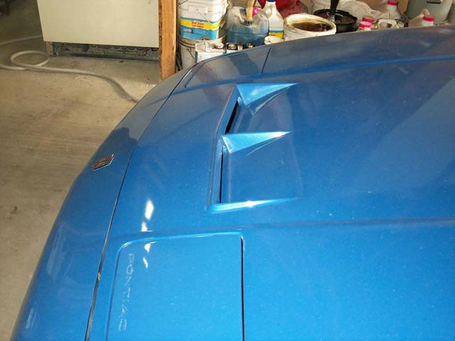

Originally posted by dudewithoutfiero:
i will i am thinking of making it a little diffirent,with a ridge in the middle
Like this one?
I think this is from the great blue chop top.

I have the measurements if you want to do this style...:
fierogt3800
I would be interested in the mesurements as im in the process of adding one to my hood.

[QUOTE]Originally posted by Fie Ro:
I would like the measurements for your hood vent, it looks great!

Thanks for the interest
Here is some useful info when we built Yellowstone's hood.You will be able to reuse most of the parts of the cut hood. These were the measurements:
