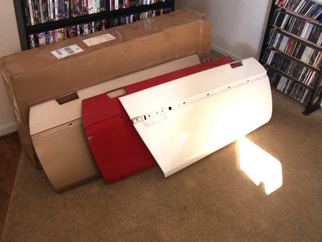

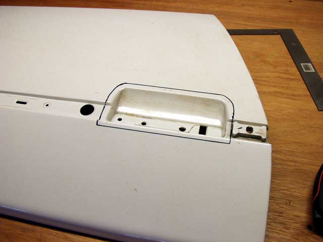

I bought an electric door release setup about a year ago and have finally gotten around to attempting to shave my door handles. I bought a couple of door panels from a forum member (thanks Mark) to expedite the project. I also wanted panels that didn't have the aero moulding to flow better with the rockers that I had Archie install. Here is my progress so far...
The victims...

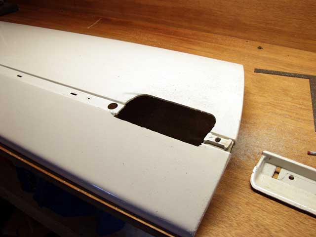

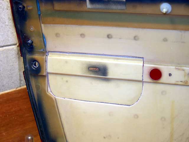

Marked out the cut.

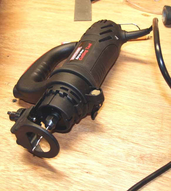

I used a sears roto zip type tool - worked great!
The handle cut out.

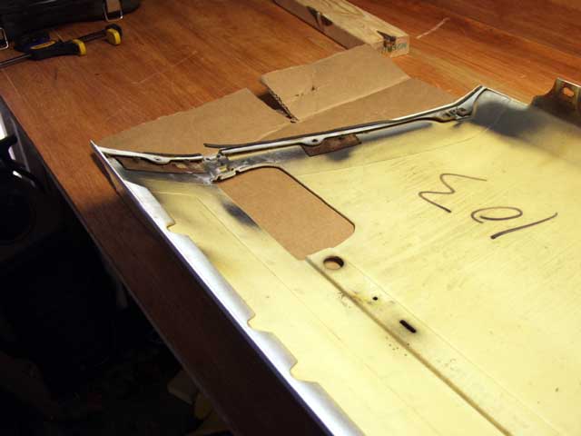

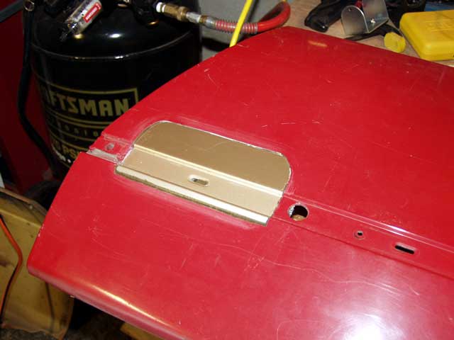

Marked a template out of cardboard for the plug.

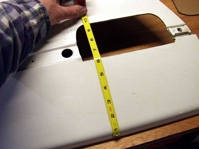

Taking measurements for the next cut.

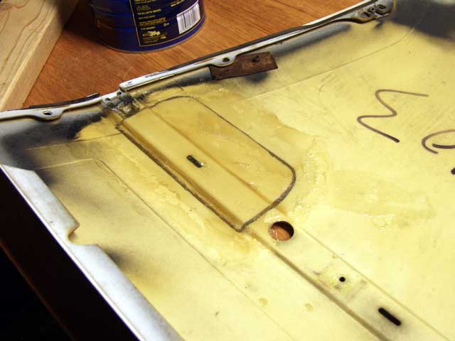

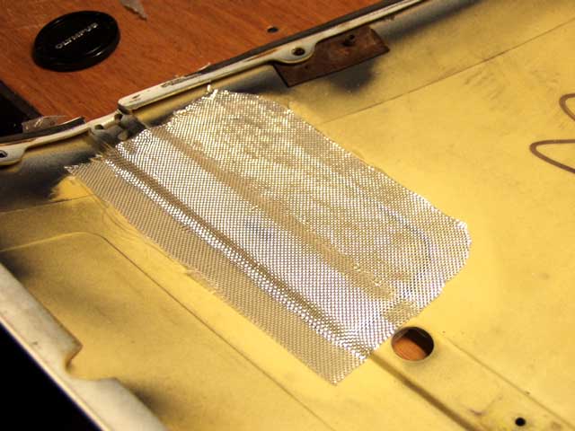

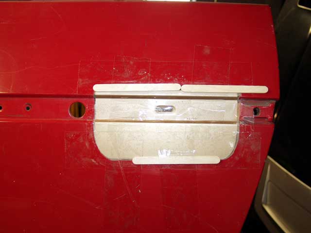

Plug in place ready for fiberglass..
Back side
Cut out the cloth

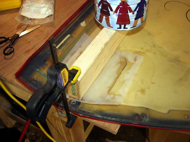

I layed a peice of nylon plastic on the fiberglass and clamped it down to hold it in place over night.

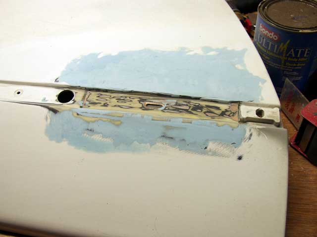

Fiberglassed and ready for finish.
Back side dosen't need anything else.

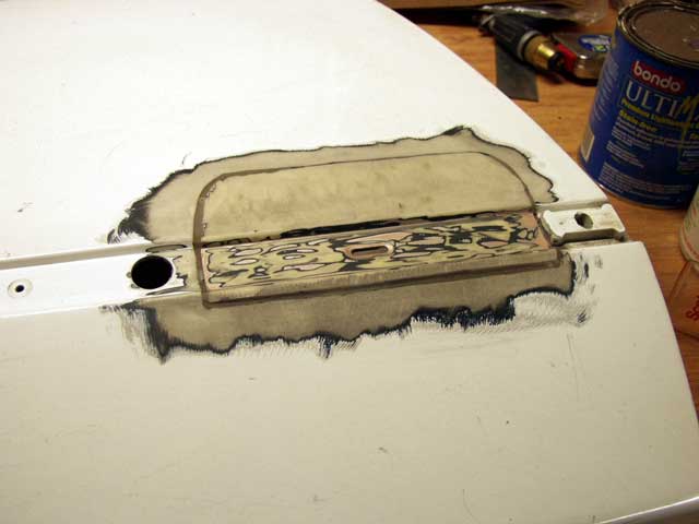

I used a wiz wheel to roughen the surface before I applied the filler.

Filled and partial sanding.
Shot some primer to see the imperfections. Still have a little ways to go..but you get the idea. When I made the plugs I made sure to use a piece of the scrap door skin that had a moulding clip hole in it to help support the moulding thats going to go across it.
Thats all for today, My hands are tired from sanding! Thanks for checking out my thread!

Are you just using normal fiberglass and SMC-type (looks like duraglass) filler? I'm a bit surprised that you're not using a 2-part urethane-compatible epoxy (I've used ones from a number of different suppliers, but really liked the stuff from Dominion & SEM). Just curious as to whether or not you're concerned at all about using a less-flexible filler on an "enduraflex" body panel? (although I do understand that others have successfully used f'glass and normal fillers - just curious)

Thanks for all the comments and kind words...Just so everyone knows - I'm a novice when it comes to body work. As a matter of fact - I hate doing it! But - I know what I want so here I am, learning as I go! Wait till my paint thread hits the forum! That will be another learning experience...
MinnGreenGT - To be honest I feel that the area where the door handles were is not that susceptible to flex. I did a sample fiberglass resin coat, about the thickness that I have on there now, on the spare panel and I'll tell you what - it bonds pretty damn good. I figure with the cloth it will be sufficient. Plus I already had the fiberglass and filler from another project.

I'm "shaving" off the door handles.

Yes, I'm going to "splice" three sections of round moulding together to make it appear as one piece. It will mount and look like stock moulding all the way across, thats why the plugs I cut out from the scrap panel have a moulding clip hole in them, to help support it.

You can use wax paper to help "smooth" bubbles out the fiberglass. the glass will not stick to it.
You are correct on the stress part of it. and using just the fiberglass will be fine. But I would use some of the bondo with glass in it to "finish" it up. Just rember that you will slam the door at some point and there might be some stress there. just don't put it on real thin.
As far as "popers", you can use an old trick of using a hood spring to "help" the door pop.
