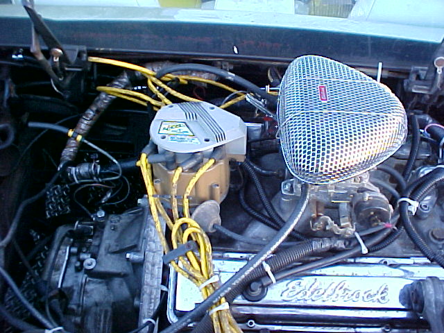

hey thanks Neal, you're a great guy. I still have some cleaning up to do but after 3 years my pics are finally on PFF !
The interior has custom upholstery and a removable Grant Signature series steering wheel. Autometer guages and a Monstor tach (not shown) custom center console, custom dashboard and 4 point roll bar. i made the Targa kit myself and i still need to finish some details around the shifter. i haven't decided on a boot for it yet. CD player with remote, Kenwood hi's angled toward the drive and passenger where the a/c vents used to be and a 10 inch sub replaces the glove box over the computer. also there are tweeters under the A pillars pointing towards passenger and driver. amps mounted under the hood (sandsa spare tire). ACC carpet covers it all up on the floor.
The engine is a mid-80's Corvette 4 bolt main with double-hump heads ported and polished to specs along with a mild cam, Accel distributer, CSI waterpump, totally rebuilt block, pistons and crank, high-rise dual plane intake with an Edelbrock 650 carb. blueprinted, balanced and dyno'd at 410 HP at the crank bolted on with an Archie kit. Auto tranny with a shift kit, and a line of spares to go along with it. Flowmaster 80 series exhaust keeps the headaches away while cruising.
i'm still in the test and tune stage of the swap, but after the motor mount issues i ordered some custom axles from Archie that hopefully will be in Tuesday.
everything is SOOO dirty because it's been sitting up in my barn on the rack for some time now while i tiddle with little things like oil leaks and axle woes. it hurts to see all that nice interior covered with dirt.
i know it's a little "ricey" for some, and as of now i've decided to lose the decals. i used to autocross with some ricers a couple of years back. the paint gets alot of attention and the rims are ( were ) made by A.R.E. who i'm told are discontinued.
thanks to all who have helped and continue to provide input on my project.

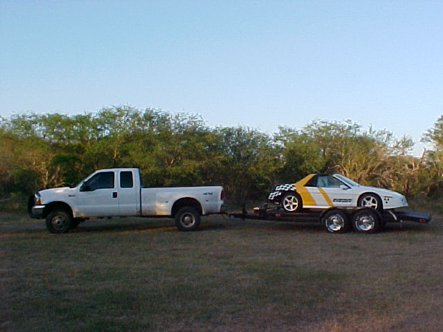

well, as you can see i took those in the evening so i plan to do some more off the trailer and with better lighting. BTW the air cleaner is temporary until i figure out what to do about my decklid. that high-rise intake is a little too high. i want a low profile air cleaner or something but the carb itself hits the decklid with nothing on it. the interior looks exactly like the Mercruiser car and i had never seen that car before. strange, huh. what's more strange is that i particularly don't like the Mercruiser car either. oh well. if i could do the whole thing over again i would probably choose black interior with a solid white exterior. But doesn't it just look like a big Hot Wheels car ?? i love it.

here is the last one 80's boy sent me
BTW, 80's boy its no problem for me to post these

Hi Steve. The tranny seems fine so far. I fear it may be geared a little too low for the V8 but we'll see. It seems excellent for drag racing so far but raps out pretty high on the open road. I don't think it will last long but i'm trying to be conservative. Thanks for the extra cradle too. it really helped out in the longrun.
