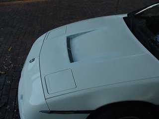

Reddog: here are the best looking hood vents out there. They're the largest functional vents with correct mesh...I remember telling you I'd post
OUT>
I'll be adding additional fascia inlets similar to triads photoshop idea-probably using grand prix ducts that will be cut out w/ rotory zip.

YOu say they are functional? What exactly are they supplying air to? The Rad?
Just Curious. They do look good though.
Philphine
Posts: 6136
From: louisville,ky. usa
Registered: Feb 2000
Total ratings: 54
Report this Post03-10-2002 08:39 AM Click Here to See the Profile for PhilphineSend a Private Message to PhilphineDirect Link to This Post
they don't really supply air to the radiator. more like give air thats's been through the radiator better and more places to go.

That is the one from the Fiero Shop. I'm currently installing one for a member of our club and I just have to say this...
It is a B***H!!!
It is "supposed" to fit with no modifications to the front trunk lip but it doesn't! The center fin sits about 1/2" above the vent with the hood open and is almost flush with the hood closed. The part (a one piece casting) when installed has a lot of tension on it, I'm afraid of cracking down the road...
The part doesn't come with any written instructions, just a video of George installing one. In the video (it's hilarious, by the way...every time his shop compressor comes on you can't hear a word he's saying ) George even had the same problem with the center fin sticking up. His solution was to "blow by" the problem in the video without showing how he fixed it.
I'll get this thing in there, but it will take a LOT of "finessing" to make it right. If anyone is going to do a hood vent, I would look at Archies "Warber" style, Oriefs or even mine... Much easier to do and looks better IMHO...

Cozmo, what kind of hood vent is yours and Oreif's?
Both have the same style as archie's, but all look different.
Im also waiting on some installed pics of ferrari_mommo's tiger paw vents, they should look very good. But i wanna see some before i put down may dollars.

That vent does work.. It works on all Fieros.. It doesn't matter if you have a 4 or an 8. The car WILL run cooler.. If you don't have one or have seen how it works on the car.. You should keep your negative, unprofessional opinion to yourself..

Thank Yaz'All...Yes these vents are from the Fieroshop. It will take time to install correctly. Like Philiphine said they remove hot air from radiator similar to C5 RACING Corvette vents. The fan pushes the hot air out / hauling ass will push hot air from front of car thru these. I think the Fieroshop had a falling out. The video I got to install had both Terry and George explaining cuts and fiberglass tips. Its like a bad soap opera with those two-but they got it right with this kit-

Stokin-hey bro I've had 4 GT's and they all "sprung" headlights at speeds over a buck twenty...

Neil, mine is a "home brew" using a spare grill from the dash.
I had to cut the front lip of the trunk 2" to clear it, but it was a pretty easy mod.
Stokin, I can testify that the vent not only reduces pressure buildup behind the radiator and increases front end downforce but it also increases cooling efficiency.
I did a hi-speed run (70 mi.) to a picnic yesterday put on by our club (Suncoast Fieros) and when I arrived the vent was so hot you couldn't touch it. I know it's an "A$$-O-Meter" statement, but the car also seems much more stable at higher speeds after I put the vent in.
