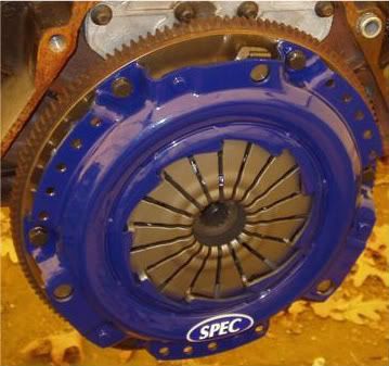

Jncomutt
8902 posts
Member since Apr 2001
In my personal experience...
This Hit...
This Fit...

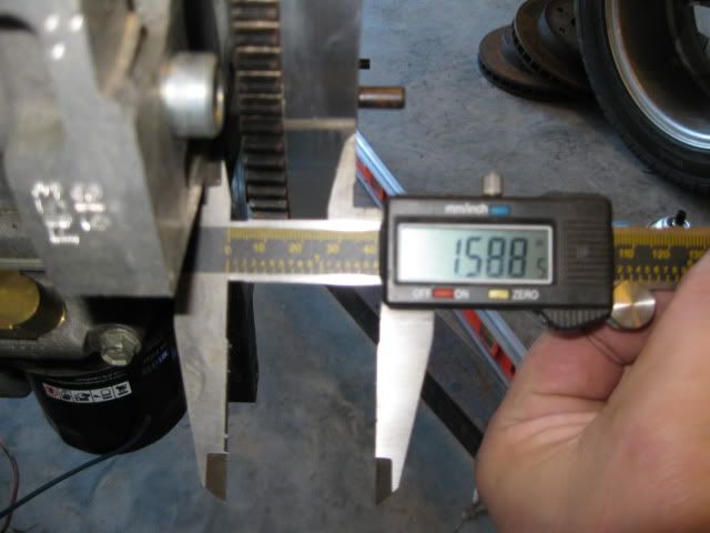

Can you show me (picture) or clearly explain what you want me to measure? I have a digital caliper ruler and access to a 2200 with flywheel clutch and pressure plate still attached. (at the local u-pull) I can get all the measurments you guys need. Then please translate it for me into a specific clutch setup.

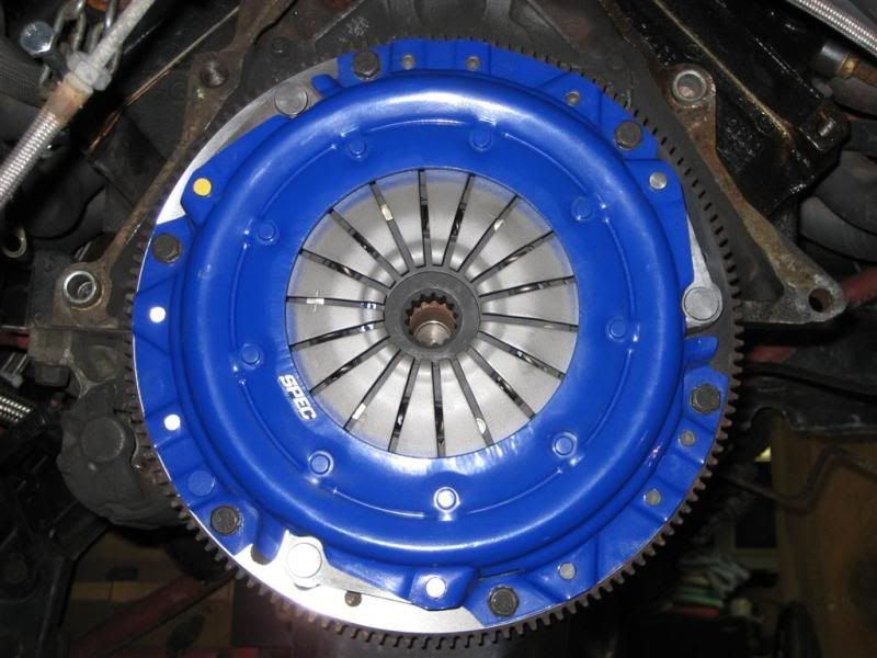

Purple86GT
1592 posts
Member since Mar 2012
This Fit...
What is that? Cavalier flywheel or Fiero? and what model?
HTOB spacer?
Clutch pedal stopper?
Flywheel machined to .084 or .082?
Thanks!
This Hit...
This Fit...
What are the differences between the two other than the visible color and label, also what are the part numbers for the two?
For the flywheel/clutch face depth, you need to measure from the bellhousing flange on the enging to the face of the flwyheel. Ideally, this would be a plunge depth measurement, but in this picture I used the ID teeth so the display was visable (not a 3800 or F23 flywheel in the picture):
To measure the pressure plate release fingers, place a ruler across the center of the clutch and across the top of the pressure plate fingers. Sometimes the ruler will not touch the fingers, so you will need the distance between the ruler and the bellhousing and subtract the gap between the ruler and the pressure plate fingers. If the ruler is resting on the pressure plate fingers, then just measure the distance between the ruler and bellhousing face on both sides and average the # (just in case the ruler doesn't sit parallel with the bellhousing face).

fieroguru
12482 posts
Member since Aug 2003
There are 3 locations on the blue body where there are bands that attach to the center pressure plate ring that goes in and out. If you look closely at these band pocket locations the ones that have had interfernace issues have a complete pocket (the housing fully covers the banding area making the overall pressure plate taller at the extreme diameter of the pressure plate). The ones that cleared has the band pocket partially open/exposed so the pressure plate is shorter at the extreme diameter and can clear the internal differential bulge inside the transmission.

Jncomutt
8902 posts
I can't get the part numbers ordered each time because I don't have access to my school email anymore, which i used to communicate with SPEC.

Sorry it took so long!! I had to go pull another F23 to get the measurments.
So from the mounting surface of the block and trans, to the fingers of the pressure plate, I calculated 63.11mm on a car with aprox 150000 KM. (not miles) so I would say the cluth might of been 1/2 to 3/4 worn?
here are the pics:
[This message has been edited by Purple86GT (edited 09-29-2012).]

From my experience with three F23 swaps now and one F40 the HTOB spacer is definitely needed and for the F23 the only clutch so far that has worked is the one shown above which to my understanding is the SPEC III plus. I have tried clutch net clutches and they interfered same as the McCleod and Bully clutches. Dan
http://www.photosled.com/showgallery.php/cat/631

I'll be using this clutch:
http://www.ebay.ca/itm/4003...id=p3984.m1497.l2649
FOYracing recomended it and they claim that I would NOT need a HTOB spacer.. I am worried about the spacer however... Trying to figure out if it will be needed or not...

Measurement from the block to the flywheel clutch surface?

Purple86GT
1592 posts
I didn't get it. My bad, I didn't think it was as important as getting the pressure plate to meet the HTOB at the OEM location.

I know the clutch, I supplied it ya know. Fiero application Spec S3 I had from a previous project. BTW, my comment wasn't directed toward you as I am sure those who know the story understand (it was in my 14k mile 88GT thread). I just happened to read this thread again and was even more surprised @ the crazy accusations toward me about the F23 clutch "IP" turned into some crap about a 13" BBK. LOL, I know I was just as confused.
Anyhoo... if I ever have to pull the clutch, I will measure and post it for the benefit of my fellow F23'ers.
