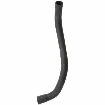

For the hoses...
Driver's side:
Application to look for is 97 Chevy C1500 with a 4.3 V6. It will be listed as the upper-hose.
It fit perfectly with no trimming at all!!! WOOT!!!
The Autozone/Advance PN is E72087 for a Dayco brand.
But neither had it in stock.
I was able to find it at Carquest.
My memory says that it was PN 22228. But my memory is not a reliable source.
Just ask for the truck's hose.
Credit goes to Toadson for that info.

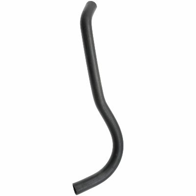

Passenger side:
Autozone PN E71126 for a Dayco brand.
I got this from a thread courtesy of Fierohoho.
I don't know the application it came from.
Thank you's and +'es to DarkToadHoho
