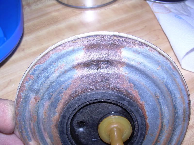

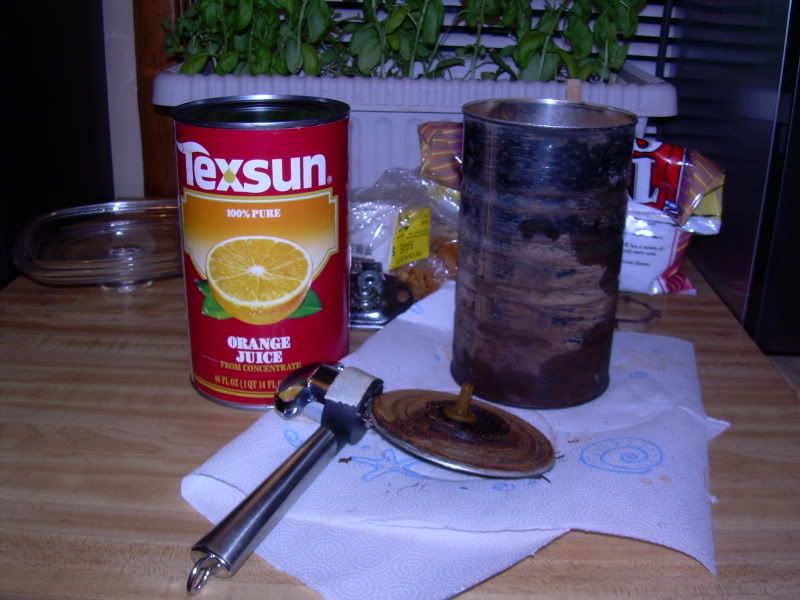

Hi all. As I was putting a new nut on one of my exhaust studs, I thought I'd pull my cruise control vacuum can off to see what kind of shape it was in. I've been having some problems with the car that makes me think I've got a nasty exhaust or vacuum leak somewhere and I *might* have found a little of each tonight. First, I had a loose nut and a missing nut on the trunk-side exhaust manifold that I rectified.

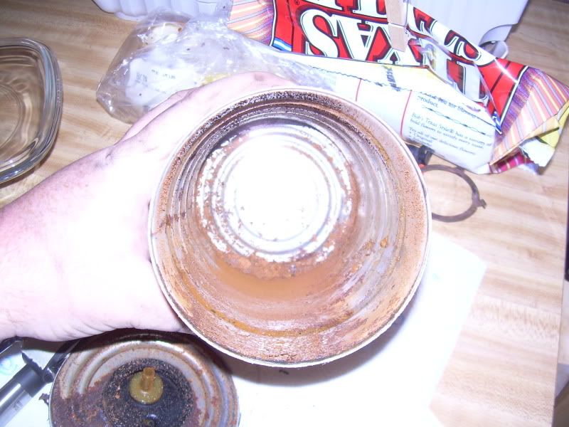

Then when I went to check the cruise can one of the vacuum hoses was loose. Also, upon further inspection I've found my juice can to be leaky. I read some time back about how to fix the can by soldering the lid onto another new can and I thought I'd try it: https://www.fiero.nl/forum/A...050119-2-053731.html

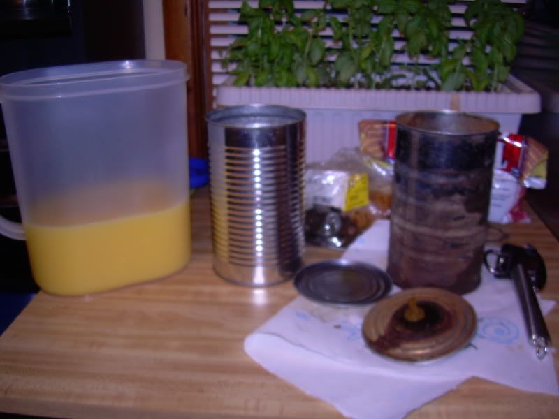

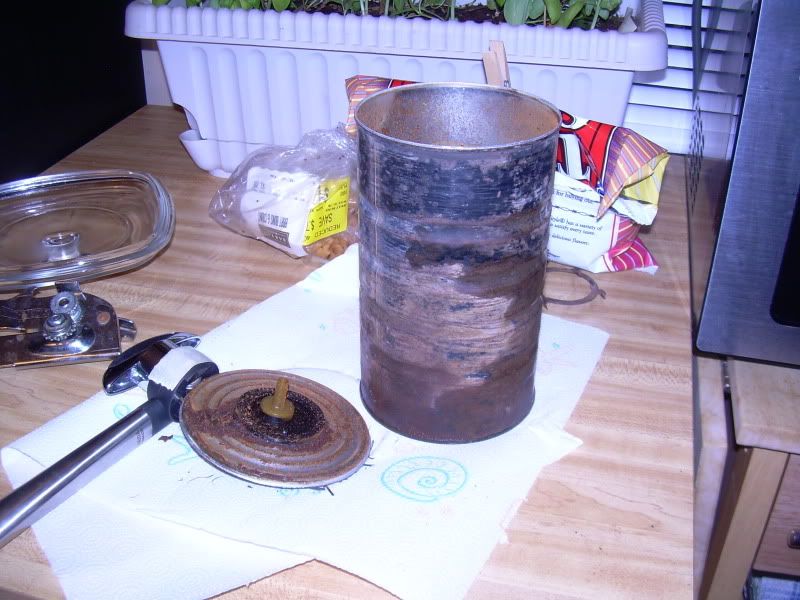

So first I pulled the can out and popped the lid off -- not with a regular can opener but with the kind that umcrimps the seam like in the above thread. I took a look inside and its got quite a bit of rust debris. After scuffing up the outside and cleaning it up a bit, I found the source, well, one of the sources.Fantabulous.
After I checked the can, I checked the lid. Its got a good deal of rust too
So I have this OJ can handy. Nice. A fix AND a drink
And now for some questions:
1. Would these leaks in the cruise system affect the overall performance of the rest of the engine? I get pretty crappy fuel economy, stumbling on start-up, and the occasional code 44 (lean exhaust -- which is why I was looking/found the loose/missing exhaust nuts).
I may actually drive it for a while without the cruise system hooked up and the one vacuum port on the metal line sealed off just to see.
2. I have some flux and solder and a MAPP torch. Is the MAPP torch overkill? Also, will the solder work for the holes in the top of the lid or would I have better luck with JB weld? Actually, would JB weld work for sealing the top as well?

You're supposed to use a tomato juice can
https://www.fiero.nl/forum/A...100421-2-097491.html
Yeah - try driving it with the hose plugged, but my guess is that you won't notice much of a difference. In closed loop operation the ECM adjusts the fuel to get the best mixture as indicated by the O2 sensor. As long as the engine is in closed loop - the ECM actually compensates for the vacuum leak. FYI - disconnnecting the battery will remove the ECM's memory of that and it will then re-learn it the right way right away. Not totally needed but if you want to you could.
Re-sealing the can - Acid core solder (plumbing solder) with seperate flux. Not sure if that is going to hold. I think you would have better results with the JB weld. Test it on a recycle can before you muck up the one you want to use on the car. MAPP gas torch - thats fine to use.

Easier just to go to a junk yard and get one of those black plastic balls used on a bunch of GM cars

The black plastic balls get soft and collapse, so thats a no-go.
I've never soldered anything before other than with a tiny soldering iron, so I think I'll go with the JB since I need to use it to seal up the topside of the can anyway. I'll just make up a big batch of it and do it all at once. If I muck it up... well... I guess I can always replace the can. This is just to keep me from spending the $30 at TheFieroStore if I don't have to. That, and its kind of fun
I'd much rather drink OJ than tomato juice, although I seriously considered getting a can of V8 juice to use and leave the label on except that I only have a v6.
On the vac leak, I drove it around some and it doesn't really seem to change how its been driving like you said it probably wouldn't. I dug out my Snap-on scanner and pulled up two codes: 44 and 45 for lean and rich exhaust. I ran all the suggested diagnostic tests on the other sensors and everything seems to indicate that I've got a vacuum leak somewhere thats making the computer run the injectors with more fuel than it really needs. I tried spraying carb cleaner around the hoses but I didn't notice an RPM change so I haven't found it yet. I might just take it to a shop and see if they can find the leak and then I'll fix it myself.

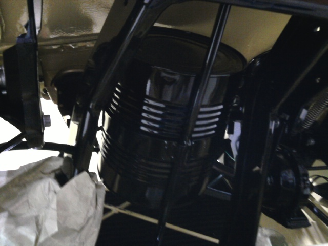

I just did the tomato can for a vette I am building to reglue the lid on. First take a grinder and grind the top lip off the can lid were it is crimped this will give u a nice flange to re bond it with then get some 8115 3m panel adhesive and put a bead of it around the lip of your can and push the lid back on after u add your can nipples to it then u just sand off the extra glue wich leaves the seam back to original looking after u paint it, done! ill add a few pics if I can find them

the reason u use the ketchup can is they are lined with a plastic coating over the tin wich in turn will keep it from rusting.

I replaced the vacuum reservoir on one of mine with a juice can too. I used seam-sealer... it's great stuff and stays semi-flexible. Worked like a charm.

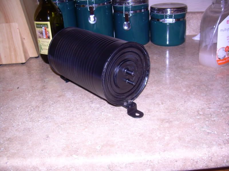

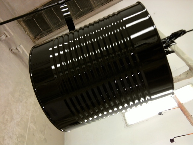

i cleaned the rust off of mine one day but i painted it with high heat gass grill paint and it did smell for about a week. i could not belive how much vacum the can held till i pulled the hoses off. it now looks like the day it was put on the car. what does this can doo, does it have something to do with cruze control.

when u do restorations and certine parts are discontinued u have to be creative I restore corvettes for a living and I guarantee the can I made is six times better than the factory one
1. has rubber lining
2.has polyurathane gasket under the original nipple wich is re atached via a 10/32 socket head cap screw vs the half ass factory rolled over rivit
3. the panel gue holds entire cars together the can is not going to cave in plus I leave a lip on top so their is no way it can
4.its just fun to make stuff people cant even tell the diffrence
the vacum can isnt going to kill you thats like saying its a guns falt someone got shot. anyway about your error codes I just tackled same problem with mine check the large vacum tube that plugs into the throttle body on the bottom side, my leak was their and was fixed with alittle rtv around the fitting since ive done it ive had no problems

Well this has turned into an interesting thread
Anyway, I rattle-canned the inside of my OJ can today. Its just a preventative measure against rust. I'll sand down the lip of the OJ can and the lid of the OEM can after the paint has cured and then JB weld them together. I'll take some pictures of that process when I do.
If my can doesn't work or fails in a short amount of time I figure I'm only out a couple dollars for my supplies and maybe an hour or two of my time. Definitely not a big deal. I can always buy a FieroStore can or convert to digital as mentioned above... BUT if this DOES work out for me, then I'm out no $$ and everything will still look/function as stock.
Alibi
Posts: 2199
From: Tulsa OK
Registered: Feb 2009
Report this Post07-13-2010 04:20 AM Click Here to See the Profile for AlibiSend a Private Message to AlibiDirect Link to This Post
Got a little more done today. I spray painted the inside of the OJ can and the bottom of the vac can lid. The vac can lid has a fair amount of rust and some holes in it so I'm not sure how well its going to hold up but I guess we'll just have to see.
After they dried, I mixed up a batch of JB weld. I smeared the JB generously on the bottom of the can to reinforce the weak metal and hopefully fill in some pin holes. Then I smeared some around the edge of the can (both mating surfaces were wire-brushed before) and pressed the two pieces together. I had a little blob of JB left, so I put that on the top of lid where the metal was weak.
Its supposed to be cured after 4 hours so I'm going to clean up the "weld", paint the outside of the can, and install tomorrow. Weather permitting, of course.

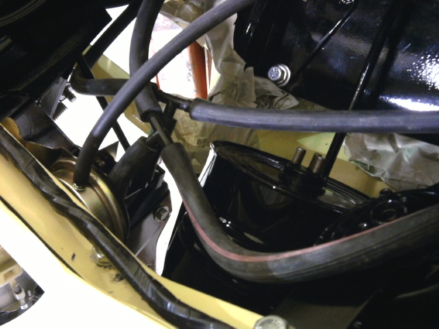

Report this Post07-15-2010 06:02 AM Click Here to See the Profile for AlibiSend a Private Message to AlibiDirect Link to This Post
Got it all painted up and bolted back in. I need some new vacuum line so I'll have to wait till tomorrow to test it. I hope I can get the cruise to work at least.
[This message has been edited by Alibi (edited 07-15-2010).]

I know one can do a digital cruise but I don't want to mess with that just yet. Other styles that are still bolt-on without too much wiring would be interesting though
Anyway, I got my vacuum can in with some new hoses but I can't get my cruise to work. When I press the button the cruise light doesn't come on my dash. I think that I just have a bad multifunction stalk because I've got phantom wipers too. Oh well, just one more thing to track down.
