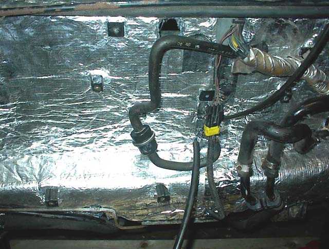

I bought a roll of the stuff from Jegs and did it myself. (Jegs no longer sell the brand of stuff I used.)
https://www.fiero.nl/forum/A...031110-1-029980.html
Here is a good article with a template so you can do it yourself.
http://www.fierosails.com/heatshield.html
JC Whitney sells a kit with tape and adhesive:
http://www.jcwhitney.com/Co...;0;0;0;0;2010772;0;0
Or you can buy just the material:
http://www.jcwhitney.com/He...;0;0;0;0;2010475;0;0
