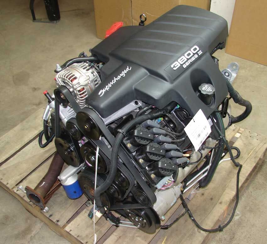

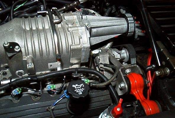

The question comes up often so I thought that I'd share what my 3800SC swap cost. My engine and trans is very low mile (near new) and an auto swap always costs more, and you can save a few bucks by fabricating mounts but when all is said and done these costs should be in the ballpark. I know Darkhorizon always claims that a 3800SC swap can be done for $1000 and you can find high mileage engines for that, but even so add up the parts cost and it becomes failr expensive.
2006 3800SC series III engine w 4T65eHD 60 miles on OD , harnmess but no PCM.
$2750.00 shipped Purchased in 2007 from Schramm Auto in MI. (these guys have many near new engines)

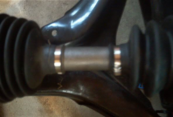

Custom axles $200.00 ( forget the formulas that you read about here, we've tried making them and the fit is terrible)
MSD Wires $75.00 ( you can't use the GTP wires as the coil pack need relocation)
Braided SS Fuel lines & Fittings 175.00 ( complete SS from rail to tank)
Fuel Pressure P Reg 48.00 ( added because engine was a series III)
LS1 SLP 85MM MAF $195.00 Flow improvement
N* Throttle body $75.00 Improvement
N* TB adapter 75.00 Needed to adapt N8 TB)
New belts $52.00
Water hoses (3) 68.00
A/C hose and adapter hdwre $155.00
Refrig pressure sensor $48.00
Boost and A/F gauges & Cups $135.00
Fuel Pressure gauge & Cup $110.00
Shifter reversal mechanism (WCF) $125.00 ( makes task of adapting Fiero mechanism to 4T65eHD shift lever) Works great!
Idler pulleys $35.00 ( when you low mount alternator they are required)
Motor Mounts (WCF) $275.00
Alternator (99 Astro w 4.3l type) 66.00 ( used a remanufactured one-great choice for low mounting)
custom CAI system $200.00 ( could be done cheaper but mine is a ram air type to the side scoop.)
( silicone couplings, 3 1/2" aluminum tube, K&N A/F)
Synthetic oil and filer $35.00 ( costs more but worth it)
Transmisson fluid fill $50.00 ( uses Dextron 6 $5 qt)
Transmission hoses and adapters $15..00
Throttle bracket, dog bone bracket,
Battery relocation and cables $70.00 ( battery now in truck right corner)
Cradle Bushings $55.00 ( recommended)
Primer/Paint for cradle $20.00
3.4" pulley $65.00 ( add only if you are a horsepower junkie and you'll need a special tool)
Injector connectors for harness $38.00
02 sensor $65.00
Speedometer calibration circuit parts 5.00
PCM $100.00
PCM Mounting tray $25.00 ( a GM OEM part) holds that PCM in place nicely)
Oil pressure sensor & Connector $78.00 ( use the 88 Fiero sensor as it fits, the old can type does not)
ETS (Engine temperature sensor) $35.00 ( need the 3 pin sensor that has the internal temp gauge sensor)
ETS Connector $18.00 ( you'll need the conector too)
OBD2 port connector $23.00 ( the harness doesn't seem to come with one)
Walbro HCHP fuel pump $100.00 ( these engines need lots of fuel at WOT)
New rear bearing hubs $160.00
R-123a refrigerent $22.00
Accumulator $35.00
Spark Plugs -Autolite 104's $12.00 ( need cooler plugs with 3.4" pulley)
Mandrel Bends for Exhaust (3" & 2 1/2") $112.00 ( used mild stell and painted w silicone paint)
Manifold exhaust connecting flange $22.00
Afterburner Muffler $95.00
Heddman Hot Tips (ex tips) $165.00
HP VCM Suite tuning software $499.00 ( horsepower is spark and fuel and if you make a change you'll need to scan and tune)
Grease, miscellaneous Hardware $20.00
fasteners, nuts, bolts, and it goes on.and on.
We have already spent over $5,500 in parts alone. Anyone care to add everything up? Yes we could have saved a few bucks by welding mounts and trying to figure out the shift reverse mechanism bu at best this would have saved about $300.00. and of course new hubs aren't a must but who wants old bearing hubs on a new more powerful engine? Then there is the 3.4" pulley so take $500 off and a true cost results. The series III swap can really add up when you convert it to a cable throttle body but the benefit is that you get the more efficient generation V supercharger which gives at least 20 more horsepower.
Bottom line is that swaps cost money and power costs money However, I would not hessitate to do it all over again as I wanted the power and performance that goes along with owning a fast Fiero. When you stomp down on that gas pedal , the power is instantaneous!
If you are looking for some real excitement, the supercharged 3800 may be for you.

The axels can be easily assembled from J body axels for $100, and if you mount the tranny square in the engine bay, they fit perfect.

$200 Custom Axels
$-100 excellent axles can be made in a matter of a couple of hours

I made my own shifter mechanism by welding the shift cable holder to the tranny mount and welding a "C" shaped selector lever $0
This places the plastic rod end very close to the exhaust. You know that's not going to last!

Drivetrain
$2750.00 2006 3800SC series III engine w 4T65eHD 60 miles on OD , harnmess but no PCM.
Now thats not a bad price for the given engine, but add 20k and you can cut the cost in half, and it goes down from there. I dont know if I would take a 100k for $1000, but I got mine 40k for $1200
So we'll just leave that as a unknown variable.

$200 Custom Axels- you can try the many formulas presented on this forum but they don't work. Proper fit is to have the tripod in the erxact center of the tripot at road height. Any les of a fit is unacceptable to me. As they say you can do it the cheap way or the right way

My shifter cable is nowhere near the exhaust.

Axels, its not asking too much to mount the tranny square, and it doesnt actually have to be perfectly centered, and there isnt that much room to mount it too far either way

What diameter are those axels?
