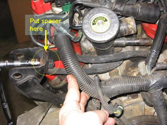

Exactly what I thought. I replaced all my mounts and still had the dogbone out by about 1/4". I did not want to preload the dogbone by forcing it in to place. I noted that the engine side mount for the dogbone did not olt directly to the block. It bolted to another steel piece that then bolted to the block. I made a 1/4" spacer to go between the two pieces (see pic). This forced the mount to line up. I don't like that I had to do it, but could not think of anything else.
Once I put the poly mounts under the motor and transmission and I suppose a new driveline absorber I will set the adjustable dogbone to wherever it is comfortable.

In a sense that is what I did. I like the adjustable dogbones, but was afraid of the potential for vibration associated with poly. I wanted to use rubber. Not having an adjustable rubber-mount dogbone this is the best I could think of at the time.
