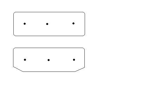

buffaloman
Posts: 48
From: Ohio
Registered: Feb 2006
Report this Post09-22-2007 03:07 PM Click Here to See the Profile for buffalomanSend a Private Message to buffalomanDirect Link to This Post
I have full roller rockers on my duke. You have to use two value cover gaskets or the rockers will hit the cover.
Remember to use good gaskets with sealer and don't over tighten.
