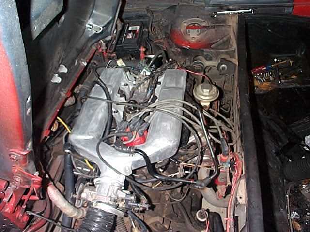

I found this pic from Cooter in the archives, but I still havn't found any hard data on it, like how much he extended the intake or how well it performed. I don't know if Cooter is still active or not but it would be great if he could chime in.

Wow, I used to build a bunch of stuff back before I got old and lazy
As far as I can remember, when I ran the 3.4 on a G-tech, the stock intake showed 140 horsepower, the modified Camaro intake made 160 and the dual throttle body made 200. Those numbers are not going to be actual horsepower, but I just used them for reference to see if there was any gain to be made with the intakes.
The throttle body end had to be cut and extended about 6 inches. The pipe I used was aluminum electrical conduit that had to be special ordered from a electrical contractor supply store. The holes for the throttle body to bolt on had to be drilled and tapped for the Fiero T/B and an aluminum spacer plate had to go between the throttle body and intake because the T/B's idle circuit is different and it would have had a huge vacuum leak.
