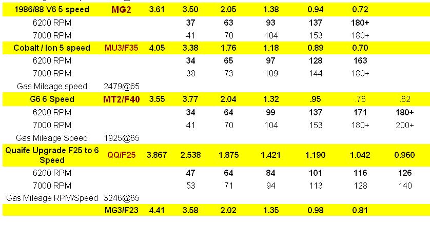

Well, I have been working on a replacement transmission for the Fiero. The 282 is not the best manual transmission for V6 with 250plus, nor V8's period... This was happening before Archie started the G6 6 speed project. I did not research the G6 at the time because it was not really available in the salvage yards. I have researched the
MU3
MT2
MG3
M86
With me, its really all about the gear ratios first, then the strenght. Not everyone is beating the quarter mile every weekend, but everyone does want to enjoy driving their Fiero.
Looking at ratios, OEM support, and most important for the hot rodder... 3rd party support.
First ratios....
I have a webpage setup with the ratio broken down by speed vs RPM... I want to turn 6200 as my redline for daily driving. I know the 3800SC can turn 7000, but its not like it needs to turn 7000 every time you shift.
http://www.fastfieros.com/NEW_manual_transmission_ratios.htm
Then if you look at load designed for the transmission.. The MU3/F35 was designed in Europe for towing. This thing can support 5000 lbs.
Then the OEM support. You can now order a Ion or a cobalt with a Quaife for 06... http://www.quaifeamerica.com/news.htm
If a person is going to use an adapter plate in a V8 application, then you might as well have whatever transmission. Yes, the G6 would have bolted right to the 3800SC, but the other supporting items to this 6 speed does not make it very well suited either.
The MU3/F35 is available for $650. If an adapter plate is going to be designed, it might as well be around something that is available in several cars vs only one car. The G6 GTP is the only getting the 6 speed this year.
Here's another page I had worked on and it has some different information http://www.fastfieros.com/tech/2006_transmissions.htm
What do you guys think?

The ratios dont add up for the 6 speed compared to the GETRAG 282 Fiero however...
Look at the chart... I will make a pic of it so I can post it. >
The speed of first gear is 37 in a 282... in the G6 it is 34
Each time you shift, it is a negative to speed and time. A human cannot shift a cable actuated transmission consistant every time. Now todays transmission is better built, and the cables are getting better.
The gears being stronger? The MU3/F35 is designed for towing in mind. Build to GVW 5000 lbs. I would say that is strong for a 2700 lb car. Then the OEM support is going to be there for the drifting. Its in the Ion and Cobalt SS... This is a supercharged 2.0 engine making a claimed 200HP, but independent testing has shown 200HP at the TIRES...

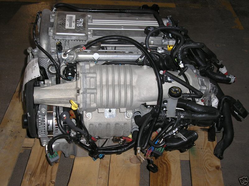

I am liking the EcoTech engine with the SC option. This looks like a ecomony and performance setup for the Fiero. The transmission developed to the Fiero, an adapter plate for the V8's and V6 3800's, then the other supporting items.

The early Saturn had a F25... The later one is F35.. They look the same however from what I can find on the Saturn forums.
Ok, now there's one thought I had not being thinking until now... Gas Mileage... I am not very mileage thoughtful when I drive, but when I hit that gas pump, the sticker shock saids I wish I better mileage in something fun to drive...
OK, so the G6 trans has a 0.62 6th gear.. This works out to 1925RPM@65MPH
The MU3 works out to 2479RPM@65
The 282(Fiero GETRAG) for reference is 2168RPM@65MPH
Ok, now one area I really stress here on the MU3, is support. OEM support, 3rd party vendor support. What will really become available for this transmission as more and more Ion's or Cobalts are tried in Drifting, NHRA, and other events where GM likes to get involved in.
If gears become available, this opens up this transmission to other gear potential.
Quaife already jumped on board and GM responded with an OEM option for the LSD. I also read on a Saturn forum that a 6 speed UPGRADE was coming for a 5 speed transmission? That would be pulling a rabbit out of the hat in my opinion.
The cases must be strong enough for this to have GM approve it.

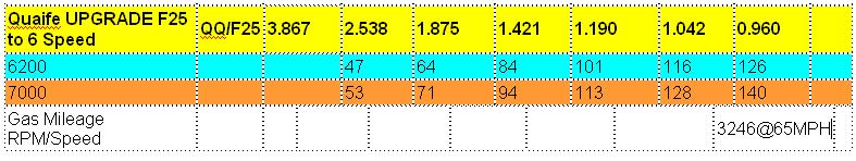

I found the upgrade option for the F25 finally...
Here are the numbers..
Quaife UPGRADE F25 to 6 Speed
Not a gas mileage transmission ratio for sure... Talk about a 1st gear however.. 47MPH at 6200RPM...

If its got a supercharger on it, and OBDII, I want to be a part of it.
I think this is the gas mileage replacement to the 32MPG duke, plus performance.
That SC is a GEN 5 looking version from the S3 3800...
Been doing alot of reading on the Cobalt and Ion forums.. That transmission is very upgradeable, and the OEM support looks promising.

I can expand on this a little more now...
As you can see the engine is tilted. The amount of tilt is 7 degrees.. The race teams tilt the engine 22 degrees. Some of the tilt is for the transmission alignment for the axles. The reference I have found on the web is this bolt pattern is called 7 degree pattern.
It is my goal to install a SuperCharged EcoTec 4 cylinder to the Fiero, but the long term goal is to install the MU3 F35 5 speed to the 3800SC and LS1... This transmission is rated high due to its roots coming from Europe were it was designed for towing packages giving a GVW of 5000 lbs. The clutch and pressure plate from GM is rated at 500HP. I really find this hard to believe, but that is what I saw documented. GM is also releasing what it calls OEM stage upgrades for the supercharged 2.0. A pulley and reflash must be done at an authorzied dealer. If the reflash is done via the Tech2, I will be able to do this. I already have the SPS and Tech2.
The EcoTec PCM is not hacked at this time. Meaning fuel management will have to be done like it was with the 3800SC PCM's before HPTuners and Powrtuner came around.
There is however a product about to be released in 2 weeks that does replace the OEM PCM and it is user tuneable via laptop. Very reasonable priced.
So, so cool things to look forward to..
Loyde

One supercharged 2.0 EcoTec and 5 speed MU3 transmission on the way to FastFieros...
Going to be at least December however before I can work this between my current workload on swaps...
The more interest in this conbination the more moviated I am to work. That is one problem with the LS1 installs, not enough interest at the price that is needed to install an LS1 to a Fiero today. I cannot help that a LS1 engine with low miles is $4000 - $6000 dollars.
I hope that development for a 5 speed that can handle 500HP is excepted and wanted..
Loyde

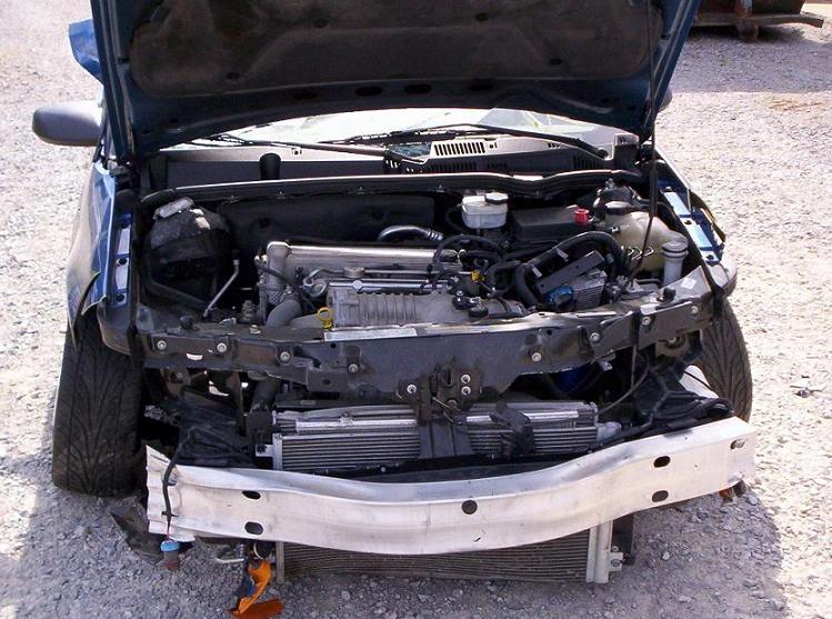

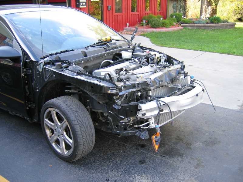

I should really start a new thread, but lets see if I can generate some interest in this little EcoTec 2.0 4 banger... First off, supercharged vs turbo... We are talking 100% realiable daily driver, gas mileage, and performance. In that order...
This is some nice pics of the EcoTec in action of the supercharger flow.. Guys, this is INTERCOOLED from the factory... These engines are good to 500HP with a supercharger or turbo.. The supercharger will need alot of upgrading to hit 500, but it can handle 325HP from what I have read...
You can download the build book for this engine in several places on the web, but here it is on my website if you want it.. This is a reference from STOCK to 250HP...
http://www.fastfieros.com/tech/ecotecstock_250.pdf
Here is a story that is kind of hard to find on the web about the EcoTec developement..
http://www.fastfieros.com/tech/ecotec.pdf
Loyde
