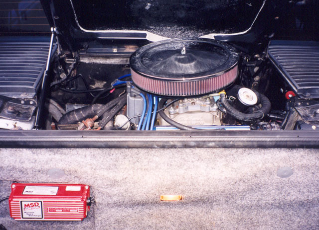

and will a A6 msd box hook up easy to the 2.8? that would stop it from blowing moduals also
Yes, 6A box will hook up easy, just read the directions that come with it. 6A box will not help or hurt your ignition module... let me repeat this for everyone again... BUY AC DELCO, OR GM PART!!!
(Also, its been said, but dont forget to put the right kind of grease / heat sinc on)

yes a full MSD ignition does help but just an msd coil that goes inplace of the stock coil.. they are junk

Arns; the MSD 6a box stops giving multiple sparks above a certain rpm BTW. It just gives it more/hotter spark after that rpm supposedly. I took mine on and off my GT and there was no power difference. Pedal was slightly more responsive but no real power gain. Certainly no gain worth $125.
Actually Dave, the MSD manual says right to the point, (no mystery here)
"Above 3000 rpm there is simply not enough "time" to fire the spark plug more than once, so there is only one powerful spark".
The point I was making is that the Blaster coil and 6A series ignition work well together, and have done well for me. There is no doubt at all that on my engine I have a better 4000+ rpm response, and less hesitation from idle. We are talking about better response and you'd have to do some pretty intense testing to see what difference it made to your ET's.
