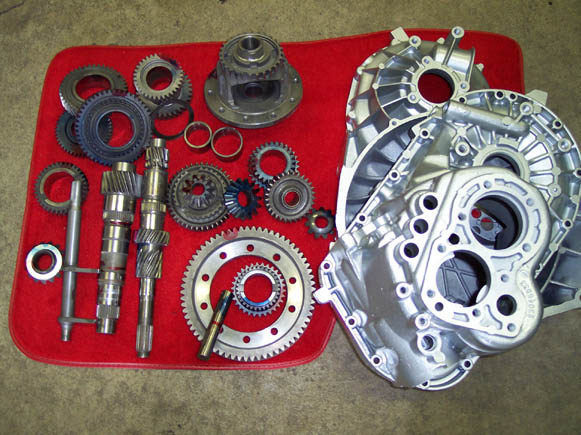

Report this Post07-19-2004 10:11 PM Click Here to See the Profile for TinaSend a Private Message to TinaDirect Link to This Post
Tina
2858 posts
Member since Nov 2000
Thought somebody might be interested on what makes up a Getrag,
If you look close you will see red and blue markings on these parts.
Blue for step one ... the freeze.
Red for step two of the process ... the gradual warming up process.

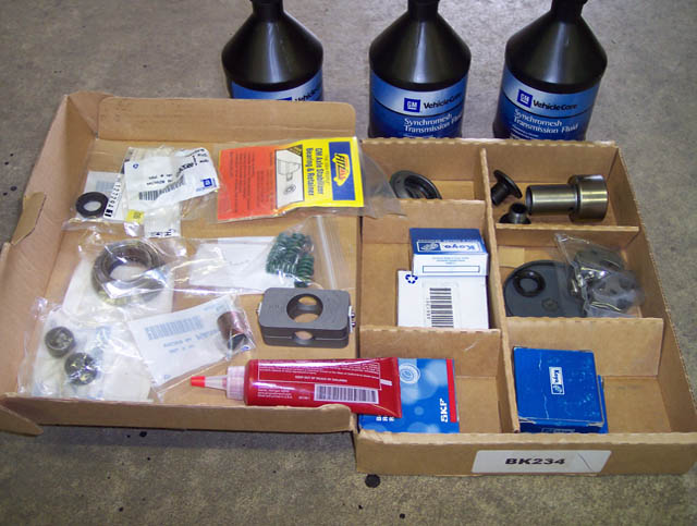

Well you need these things below as well. ( Alright, limited slip is optional)
Look at this this way ... how many of todays cars are actually a manual.
Not too many. That itself reduces the pool of mechanics you can pick from.
Who wan't to carry all these specialty tools.
Parts are getting harder and harder to find.
In the case of the Getrag some parts actually need to be heated up to install.
The guy who ended up tearing mine apart and then putting it back together never done one before.
Did another version of the Getrag though, not made to be rebuilt and made it work.
(The one that's stamped with the "Do not disasemble, return to manufacturer, forget what this particular one is called now)
Plus he came highly recommended from the local 6,7,8, second club people and was willing to give it a shot.
As to tips, Rodney does sell the manual on how to rebuilt one.
Another would be http://www.drivetrain.com. They do offer a rebuilt service. Pretty reasonably too and
are very helpful in locating the parts they don't stock needed for a rebuilt.

Forgot to post the various other contents of a Getrag.
(Syncros not included in the pic... they arrived a bit late)
