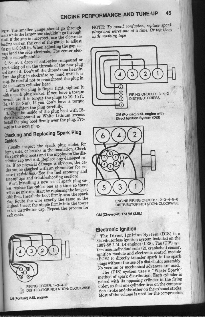

I just changed my spark pulg wires plug and distributer, Noiw the car wont start. What did I do wrong. It turns over but will not start. I thinkg I might have got a plug wire in the wrong order please show me a pic of which should go where. Also I could only change 5 plugs I could not get one seated why?

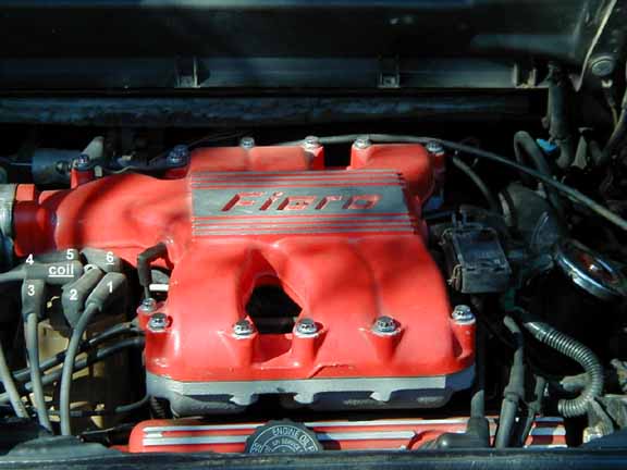

I have a pic can someone please put a cylender number on each plug wire

tgowens
Posts: 2496
From: Somewhere in my Fiero, of course!
Registered: Apr 2000
Report this Post07-01-2002 04:51 PM Click Here to See the Profile for tgowensClick Here to visit tgowens's HomePageSend a Private Message to tgowensDirect Link to This Post
Hope this helps.........

Capt Fiero
Posts: 7658
Registered: Feb 2000
Total ratings: 260
Report this Post07-01-2002 04:53 PM Click Here to See the Profile for Capt FieroClick Here to visit Capt Fiero's HomePageSend a Private Message to Capt FieroDirect Link to This Post
here ya go, hope this helps.

There is a discrepency between the pics the 6 on my pic is where the 1 is on the other pic. I used the other pic and my car still will not start. What now

ls3mach
11610 posts
Member since Mar 2002
Mr owens you are a GOD. I got it started but now it sounds and runs funny. A mechanic is coming buy in a little bit but if anyone has anything else I should try it will svae me some money.

Avengador that diagram shows the correct wiring.
Capt Fiero
Posts: 7658
Total ratings: 260
Report this Post07-01-2002 07:36 PM Click Here to See the Profile for Capt FieroClick Here to visit Capt Fiero's HomePageSend a Private Message to Capt FieroDirect Link to This Post
Well that is strang, as mine is set up as per the pic I posted and my car runs very well. I realize that it is a simple matter of pullng the dist shaft out and move it over one tooth to make your number one point in a diffrent spot. But from the factory, I thought #1 pointed more to the passanger front.
