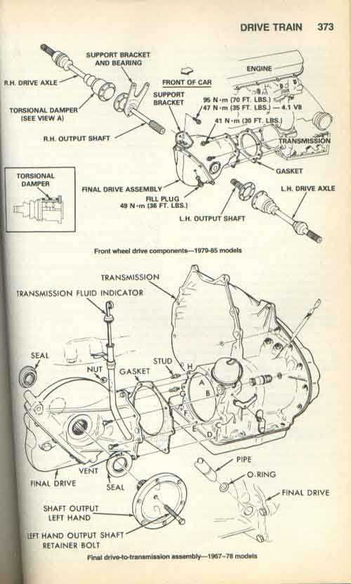

The eldorado/toronado/riviera automatic transaxle can be beefed up to handle just about anything a SBC can give it. The first problem is that it is a big heavy trans. The second problem is that half of the engine and all of the trans is behind the rear wheels. No matter what you do you will not be able to get it to handle as well as a Fiero should. It looks pretty cool and the wow factor is high, but it's just too much weight in the wrong place. For a car that is on display more than it is on the road, it is great, but if you want a good driving car I'd find something else. I drove my 350/TH325-4L Countach for a about a year with no problems. I was happy with it but only because I was real easy on it for fear of wrecking the body. It was also 10" wider than a Fiero and had 305/50/15 tires.

I'm no expert, but I did learn a lot from doing it and I've looked at a few others in kitcars and such. The TH425 is the older stronger one. You don't get the overdrive as in the 325-4L, but I've been told it is basicly a TH400 converted for FWD. flipping the diff and pointing the engine out the back will put the entire weight of the trans in front of the axle instead of behind it. I don't know how much it actually weighs, but you won't catch me trying to pick one up. It uses a cast iron differential housing that looks like a RWD unit without the axle tubes. The pinion shaft goes right into the trans case and there ar like 6 bolts holding it together. You can take the bolts out and rotate the diff 180*, drill some new holes and bolt it back on. This also puts the centerline of the axles above the pinion. So if you leave the axles at the same position, the engine will sit lower in the chassis, another benefit. It's all really confusing unless you know what the trans looks like, and trust me, it looks like no other. I think you'd need to cut the trunk no matter which way it's done.

With the differential flipped, don't you have to modify the oil pan to clear one of the axles? seems like I saw a web site somewhere that showed the pan being modified. Then again, I think the motor was a SBC so it may have needed modification without rotating the differential.

The SBC oil pan needs to be modified either way. I made my own, but it looks like a 4x4 S-10 V8 oil pan from Summit racing will work. here's a pic of the TH325 (top) and TH425 (bottom)
Hugh on the forum has a TH425 and 350 (pulleys front) in one of his 88 Fieros. He has done everything he can do to make it handle well but it doesn't. We are discussing pulling it out and putting in a 3800SC.

Quote: "There was a site that I was given that used a sbc with a automatic set up in the normal fiero position that ran 10's ill see if i can find the link and see if we can find out what transaxle he used."
It's probably a built up T125... a regular Fiero transmission. If your interested in using that system, then V-8 Archie is the man. The longitudinal system is probably cheaper but, as was mentioned, handling will suffer. There are things that can be done to help make it better:
- Reverse the transmission (as mentioned earlier).
- Build the motor as light a possible (i.e., use aluminum heads, intake, shorty headers, etc.)
- Moved the battery up front.
You will still be heavy in the rear but handling should improve. You just need to ask yourself, "What do I want to accomplish with this car?". If it WOW appeal and low bucks with rock solid dependability with regular abusability (read - no broken transmissions) this is a pretty good swap. If it's tire blistering cornering ability, then this is not what you want.
Roy :D

Any longitudinal engine swap will require cutting the trunk. I am in the midst of making such a swap using a TH425 which, by the way, is a bullet-proof transmission. Originally I had planned to mount the engine facing forward but I have since decided that I am not satisfied with this arrangement and I am now trying to turn the differential around to reverse the rotation and thus allowing the engine to face rearward. There are two problems with using this setup with a forward facing engine: 1. the majority of the weight is behind the rear wheels and 2. the engine sits too high in the engine bay requiring the use of a tall (3-4") hood scoop to cover the carb (or FI unit) and distributor. not good for a sleeper '84 2M4.
I am working to solve this problem of turning the diff around, i know it has been done but not sure by whom. If anyone has info they want to share i would be happy to share my experiences in this swap with them also. I also have a good contact for TH425 transmissions if any one is in need of one.
