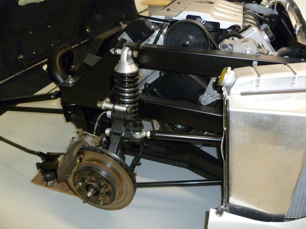

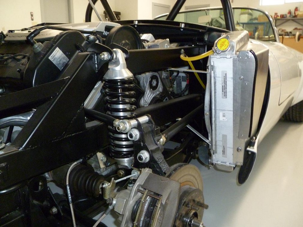

john austin
OCT 17, 05:04 PM
quikgta, sorry for the delay but you asked for suspension pics and I did not have any. the front is simply 88 fiero narrowed 3 inches with small coilovers so pics would not show much. the rear is highly modified 88 so I pulled a rear wheel and tried to show in 2 pics. i'll try to get them posted.
hnthomps
OCT 17, 05:21 PM
Here are the two photos that John sent me for posting in this thread.
.JPG)
.JPG)

john austin
NOV 03, 08:31 AM
quikgta, don't know if you are still following this thread, but did the rear suspension pics help? hard to show in pics.
