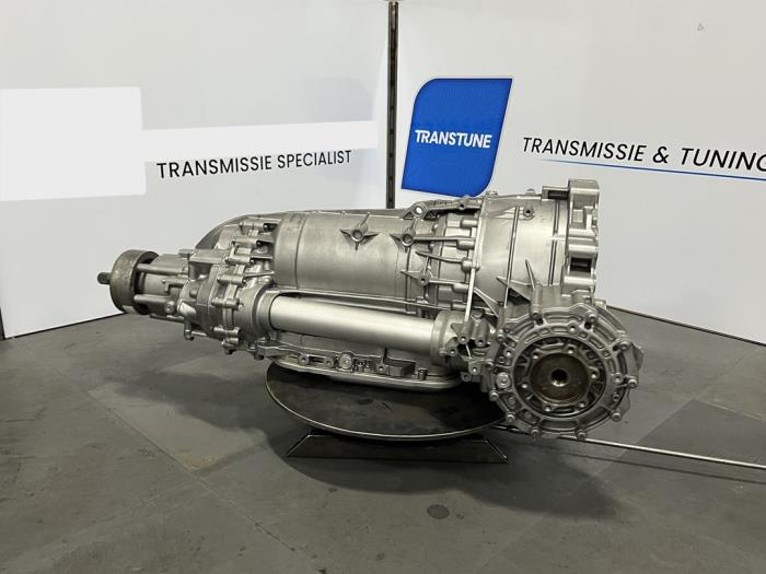

engine man
5364 posts
Member since Mar 2006
thees are the three transmissions but the ZF 8HP 55 is the only one i have seen they claim it can be modfided to handle 1400 ftlbs of torque

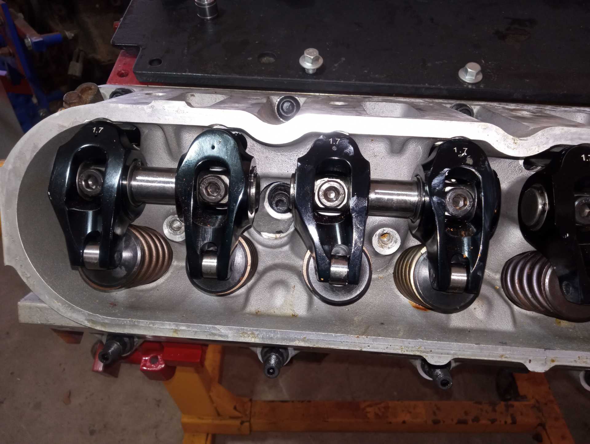

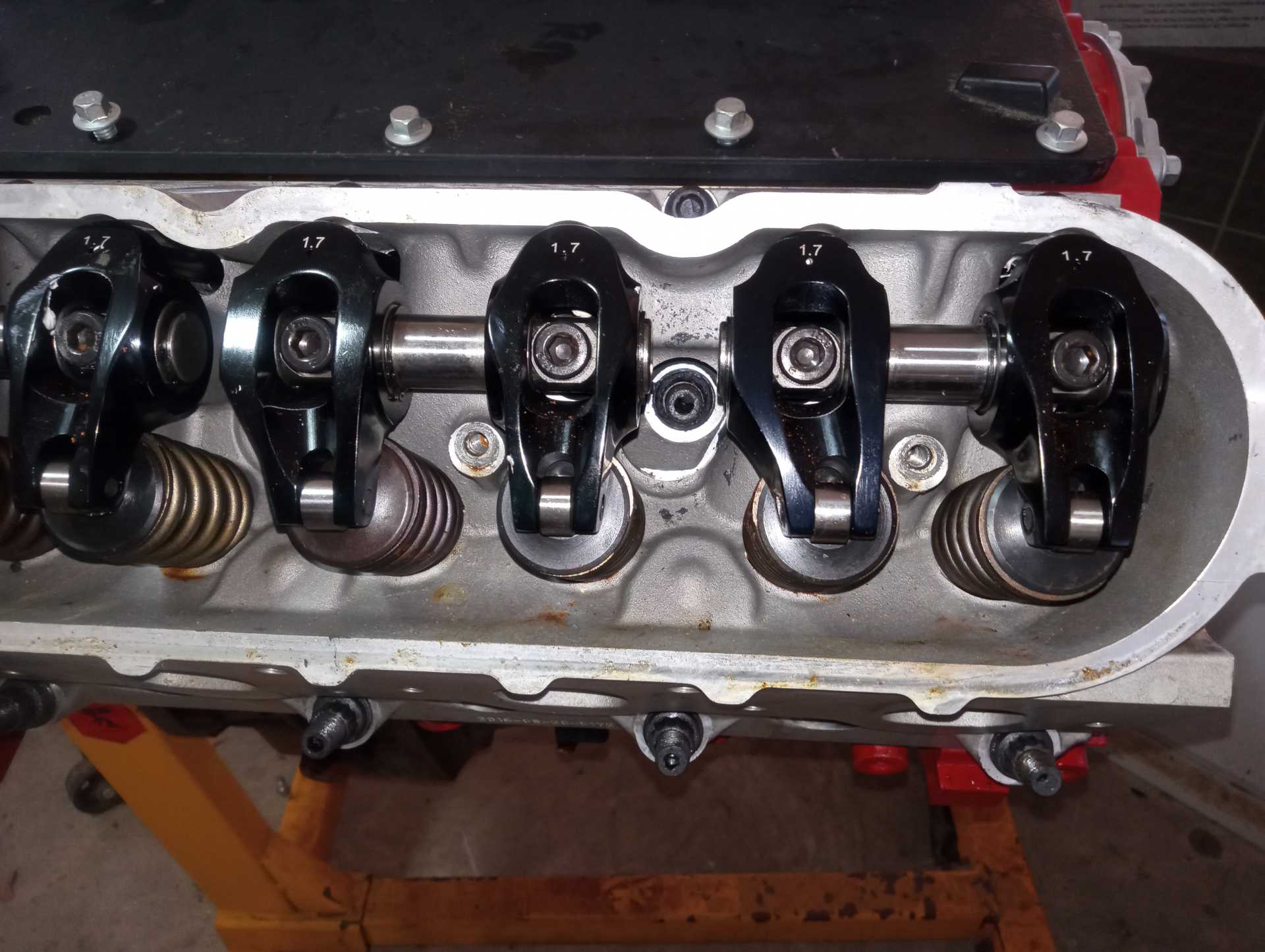

Report this Post11-19-2025 02:18 PM Click Here to See the Profile for engine manSend a Private Message to engine manEdit/Delete MessageReply w/QuoteDirect Link to This Post

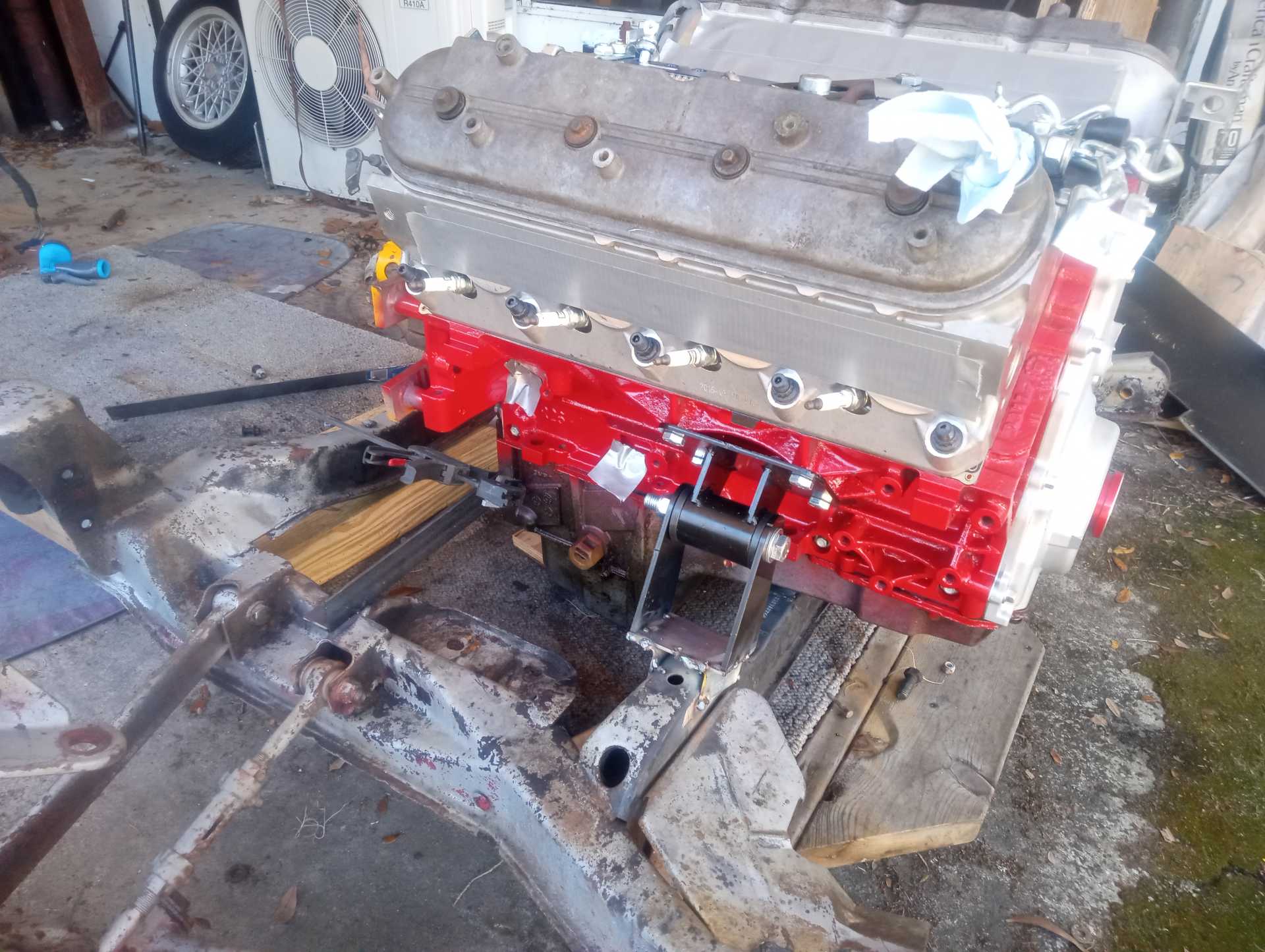

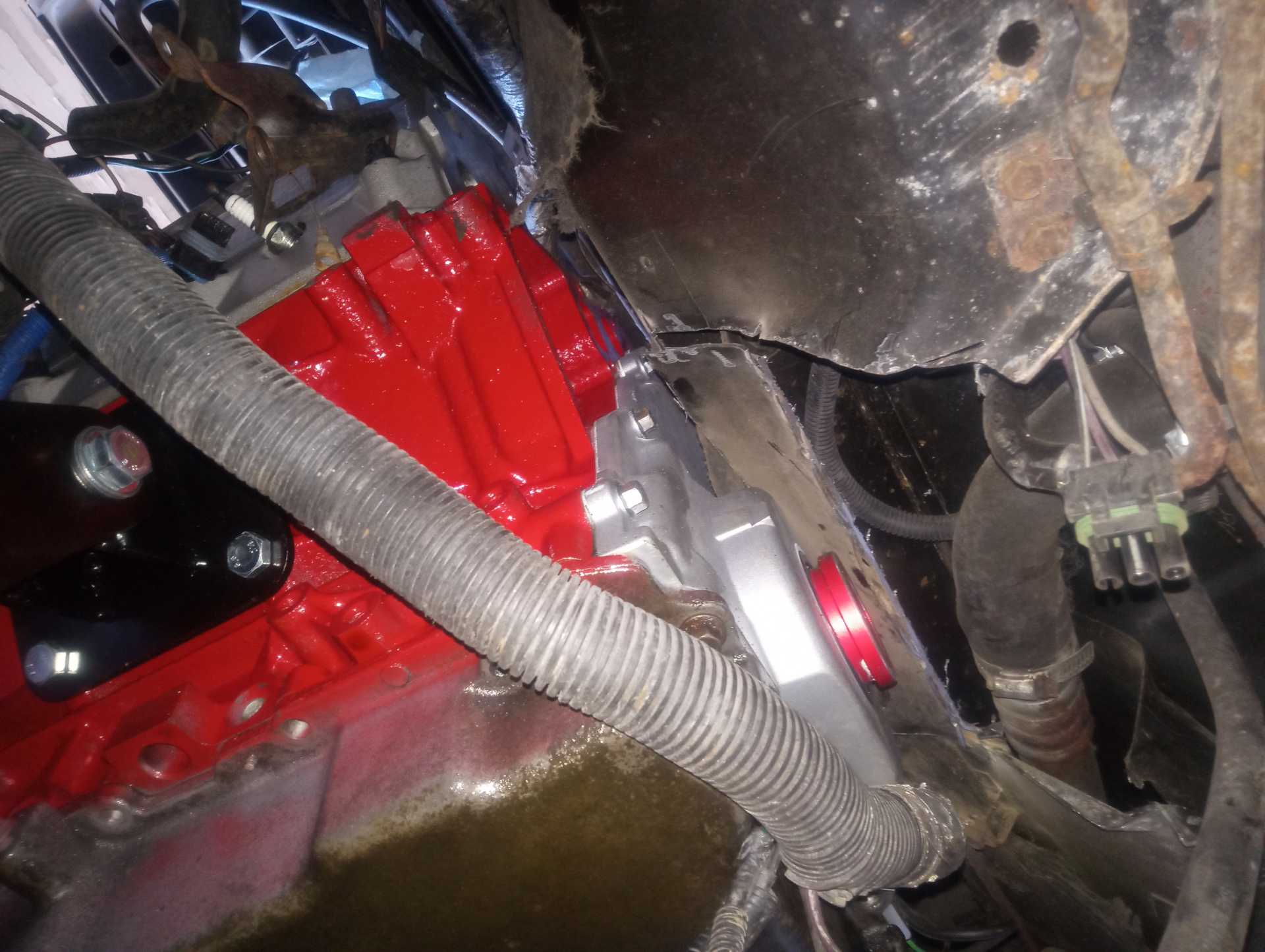

well I have a bit of clearancing to do on the rocker arms as they just so slightly touch and i will need aftermarket valve coveres as the baffle in a stock cover hits the rocker's

I want to say that the Audi trans probably has the same "bones" as the ZF 8HP75 trans that's in the Ram pickups.
It is reputed to be about as bullet-proof as you can get.
I'm not sure what you're going to do about the control/programming, but Ram definitely got it right. It is, without a doubt, the best - and most intuitive - automatic trans I've ever driven. And I generally don't like automatics at all.
Good luck with your project.

Yes it is the same as the Dodge trans but for Audi Turbo lamik makes a TCU for it and you can have a virtual clutch watch the video https://www.youtube.com/watch?v=6Q7x-VVuSfc

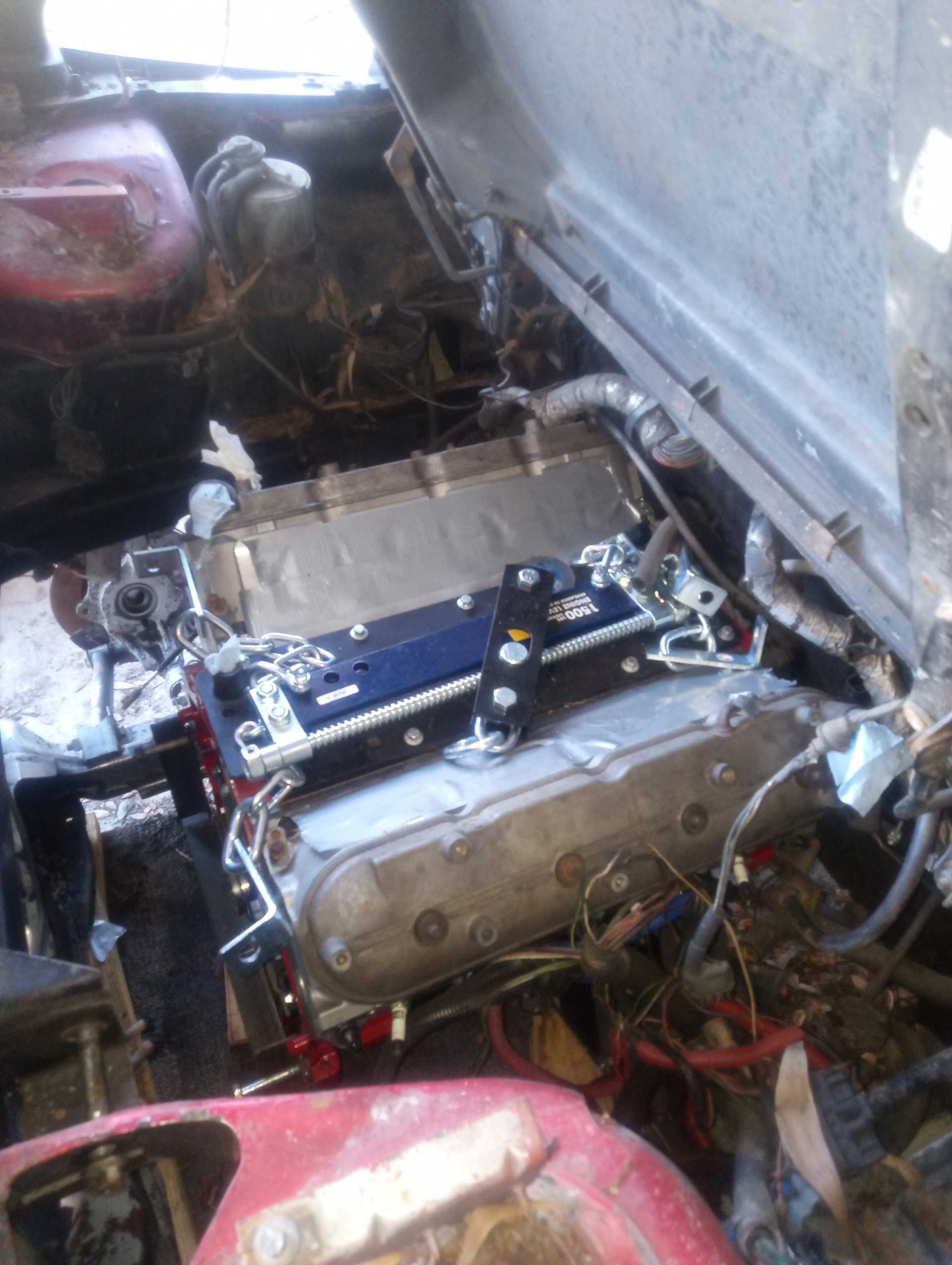

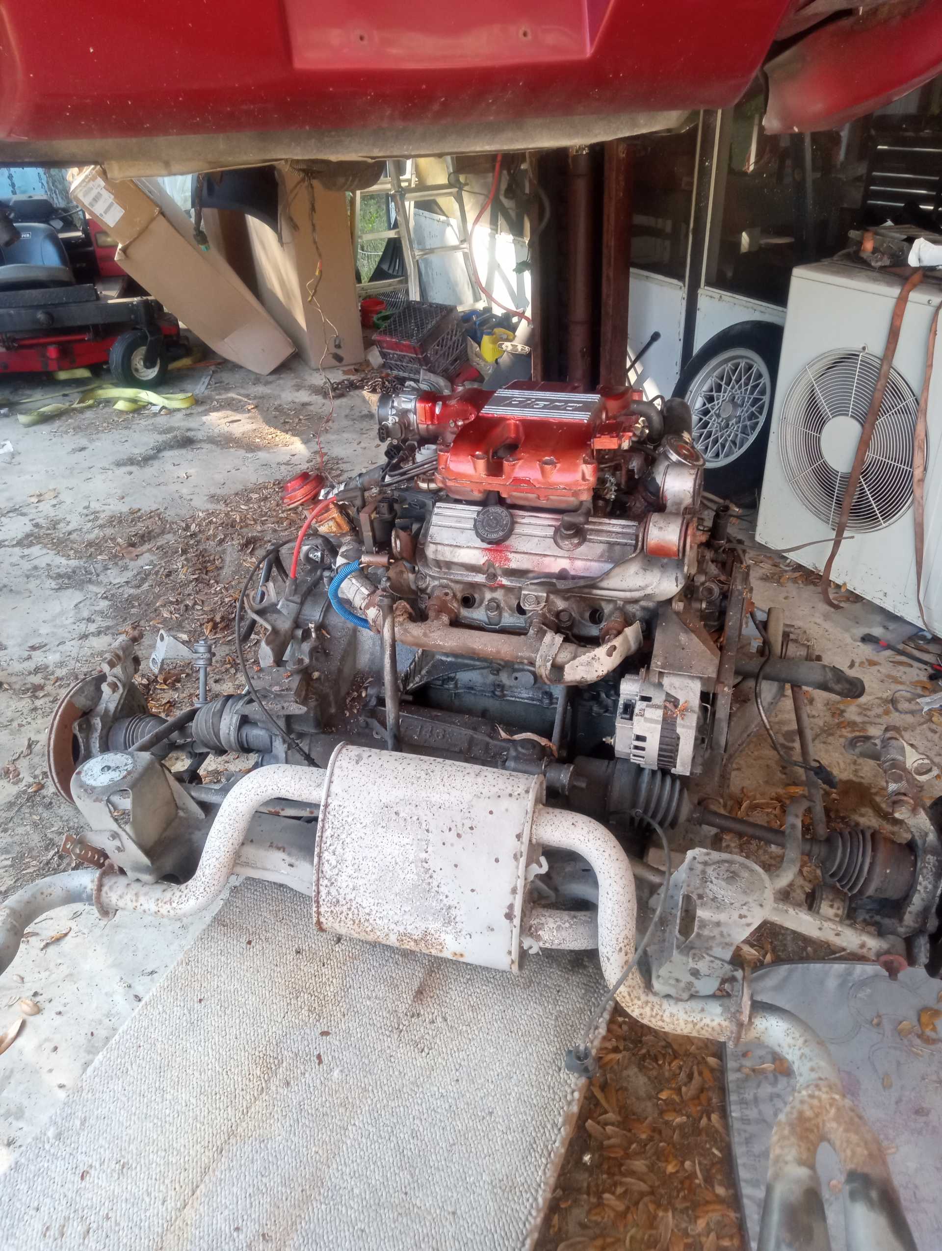

worked on the car disconected all the wiring but the starter and will have it all out by the end of the weekend as i am just taking my time no big hurry

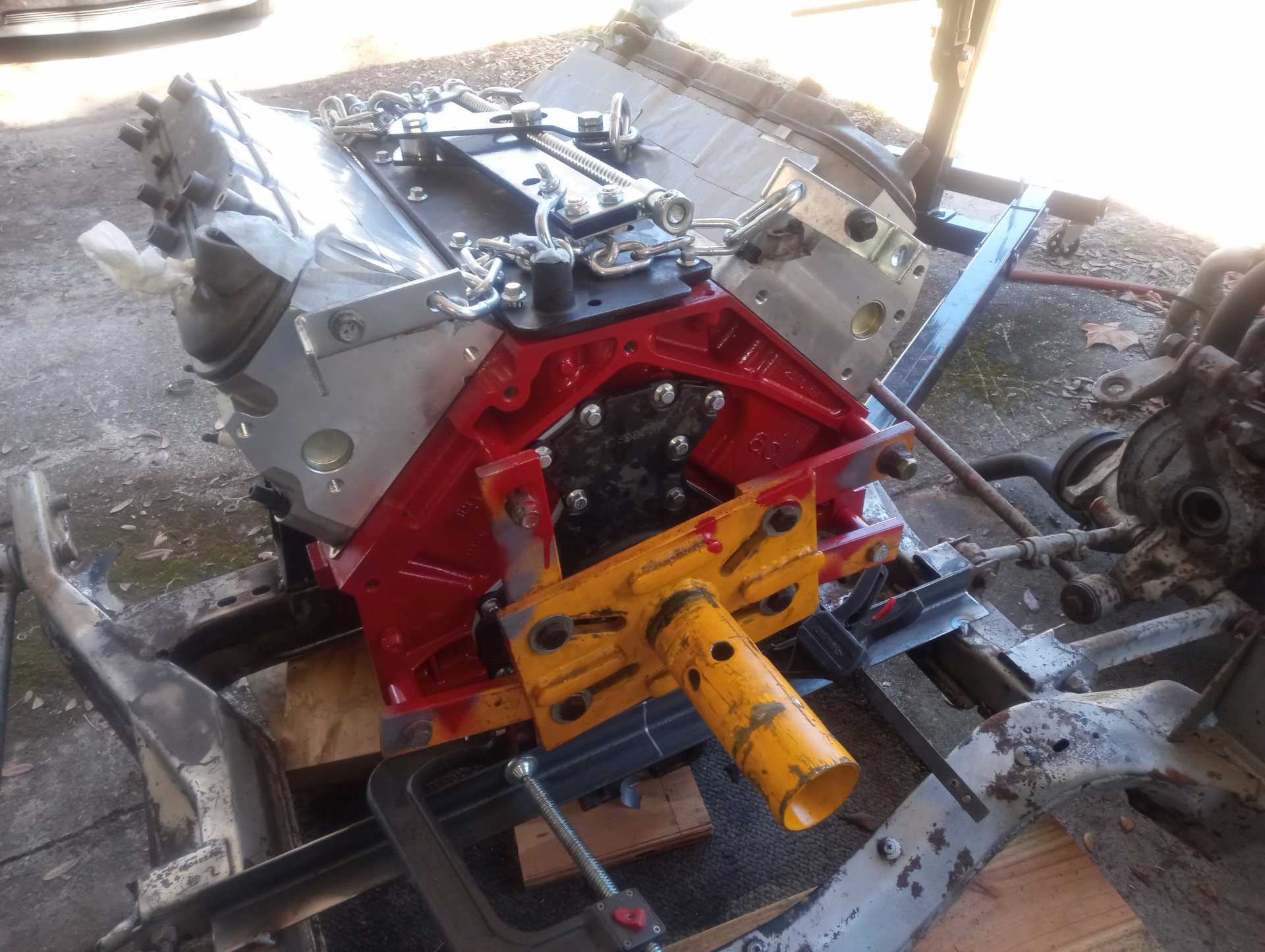

Report this Post11-22-2025 03:09 PM Click Here to See the Profile for engine manSend a Private Message to engine manEdit/Delete MessageReply w/QuoteDirect Link to This Post
engine man
5364 posts

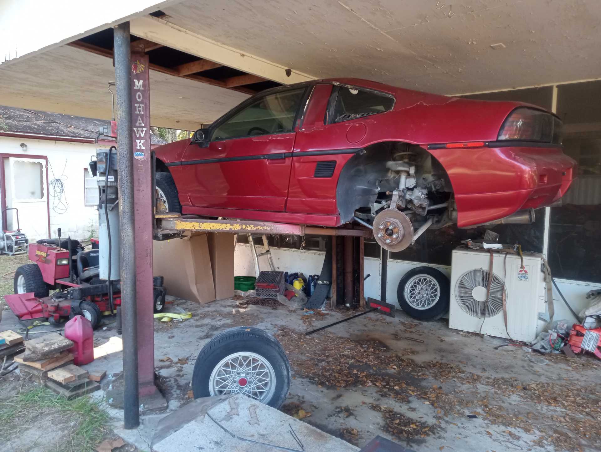

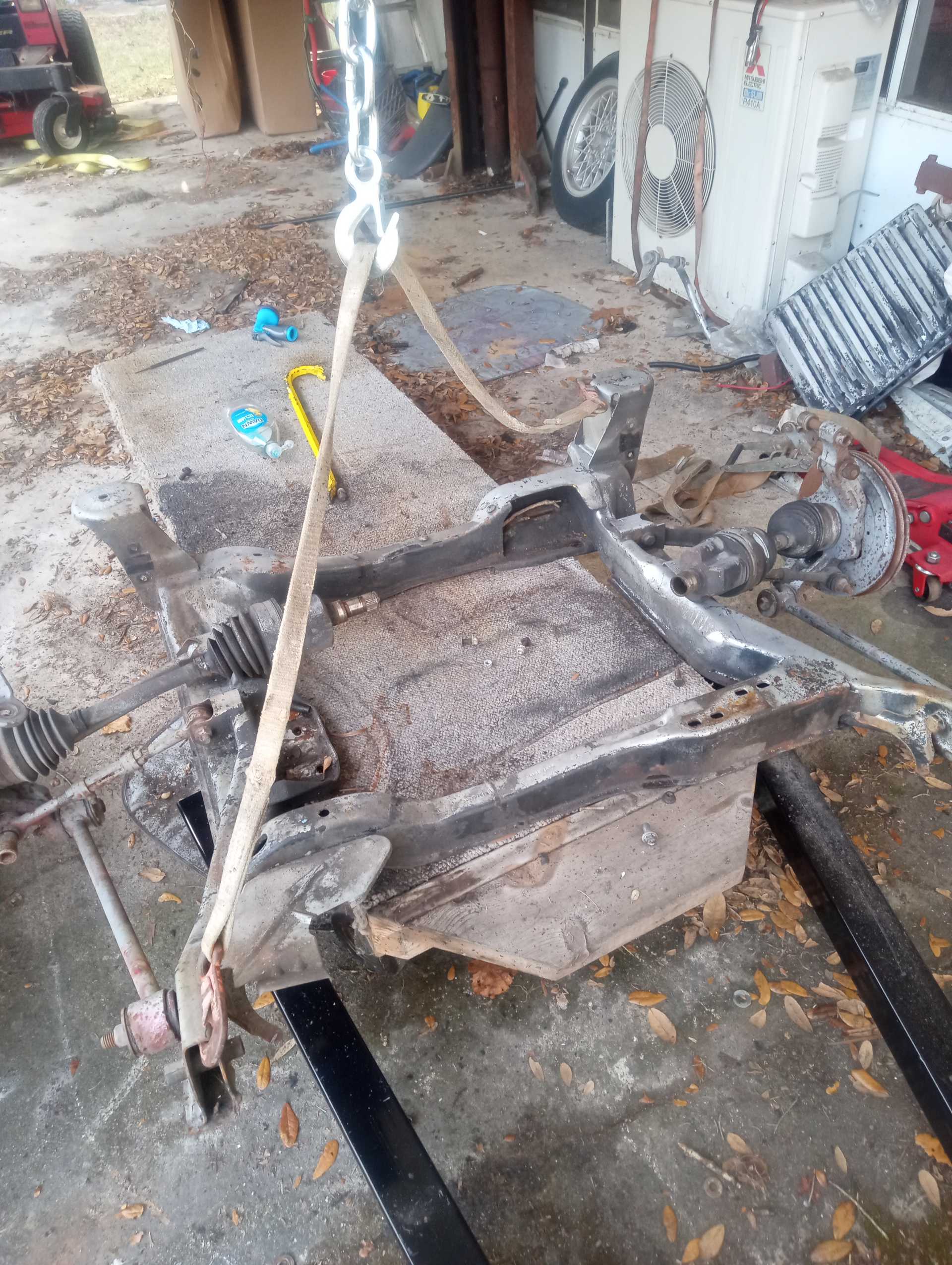

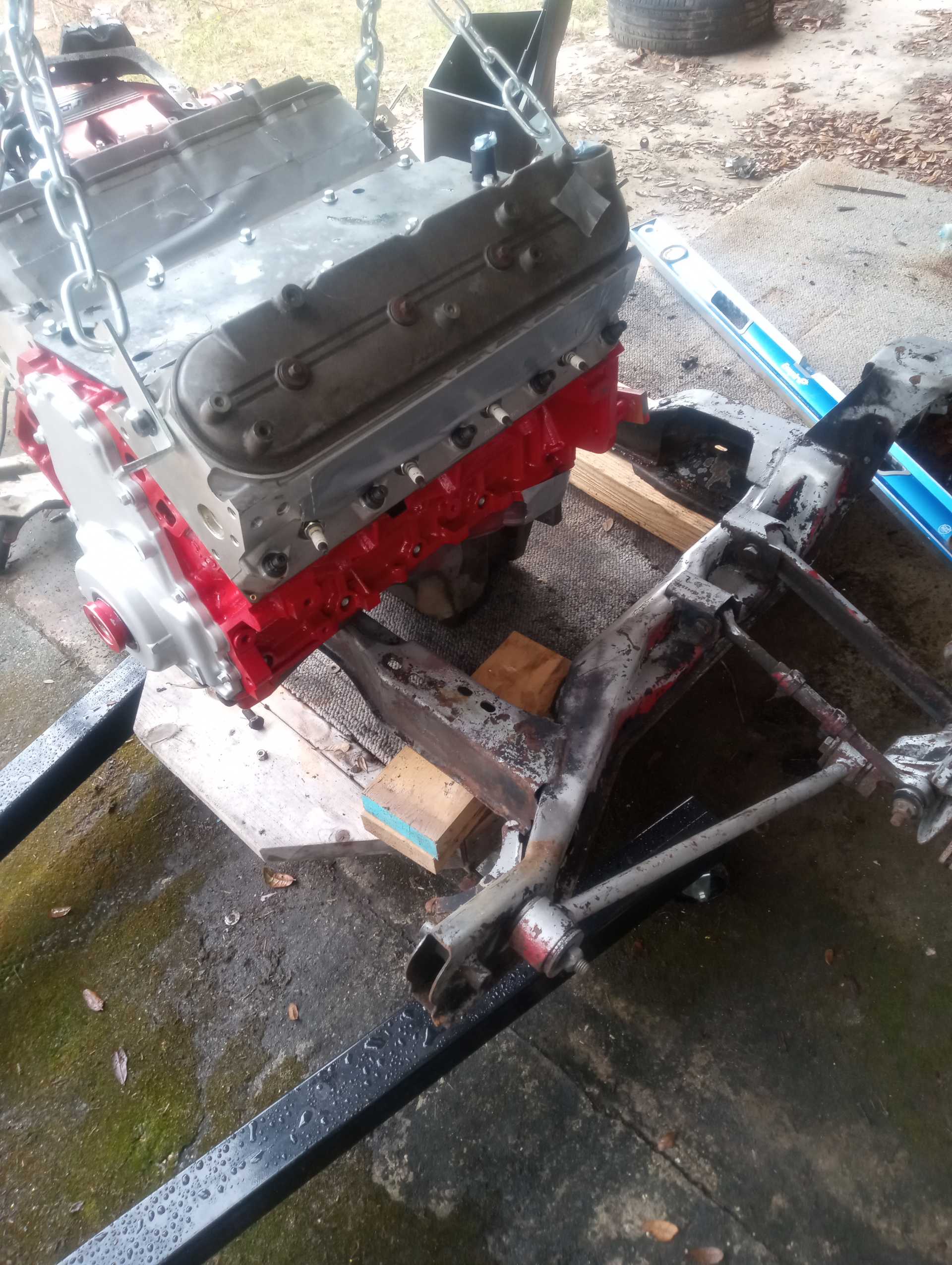

Ok she is on the lift and just the starter and AC to disconect then the 4 cradle bolts I need to soak the rear cradle bols as we know how the nuts just start spinning

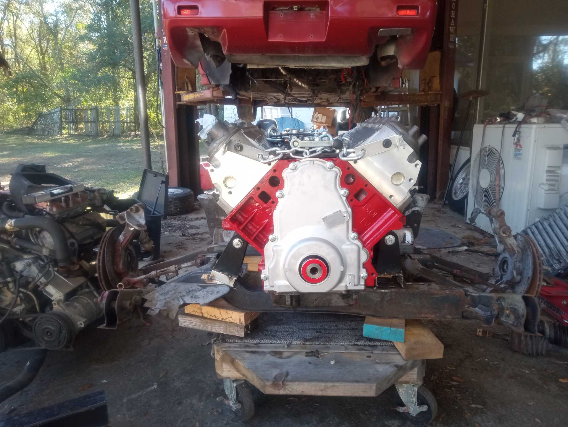

Ok i did some basic measuring I am coming up with 20.5 from the front of the number 1 bank head to bellhousing on my Ls and i think the Fieo axle center is 21 incehes from the top of the firewall back I am not sure how much the firewall slpopes forward at the bottom of the decklid hinges but i figure if i have a 1/2 inche clearance from the top of the heaf to the fire wall and with a 1 inch thick adaptor and the axle line on the trans is 1.6 inches behind the bellhousing mating surface i should end up with just over 2 1/2 axle offset i will have to run a remote electric water pump and low maunt alternator hell i might even get the AC pump back on it .

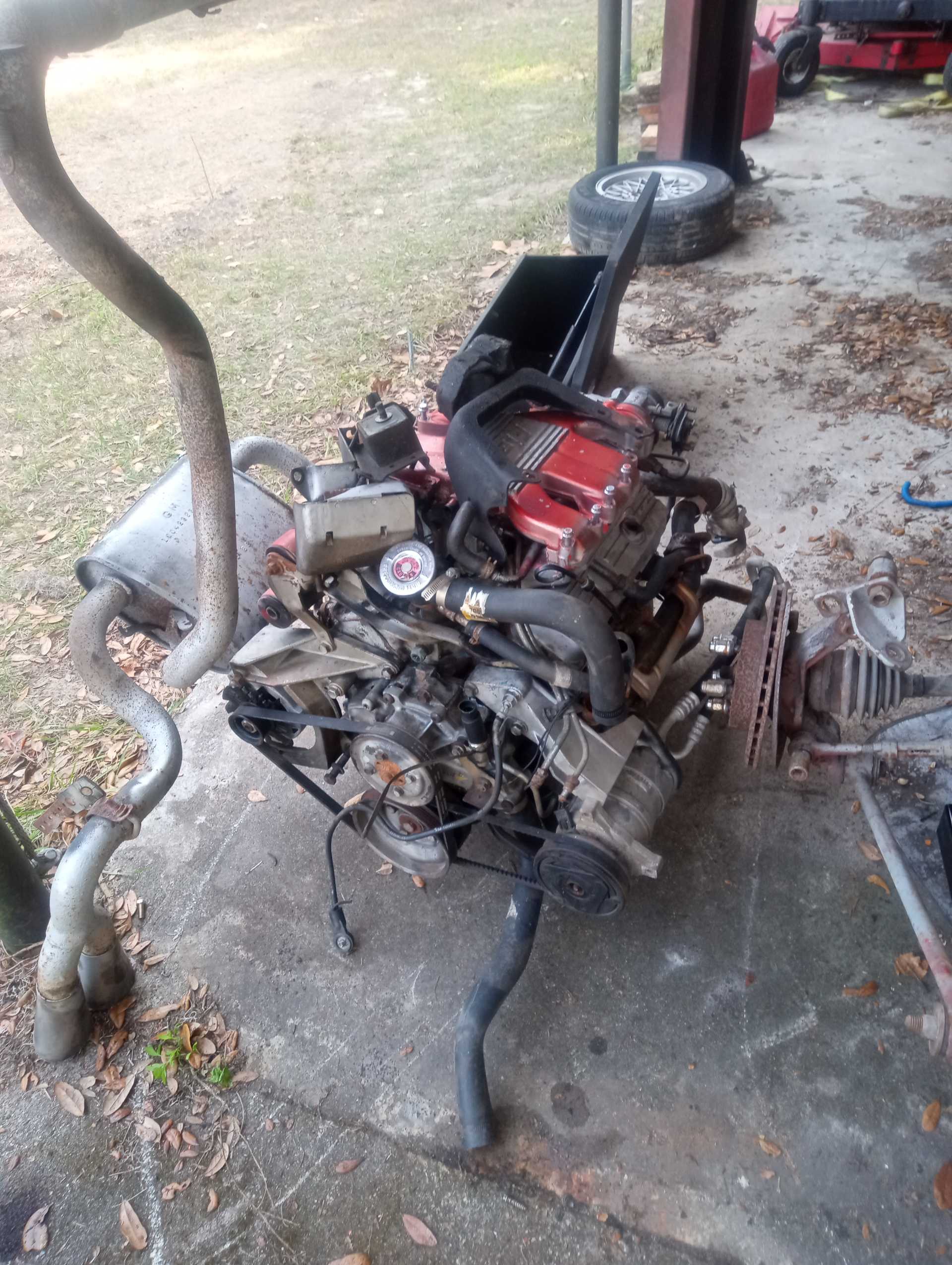

Ok the stock engine is all off the cradle now just need to pressure wash the cradle tomorrow then i will hook onto the engine and start postioning it on the cradle

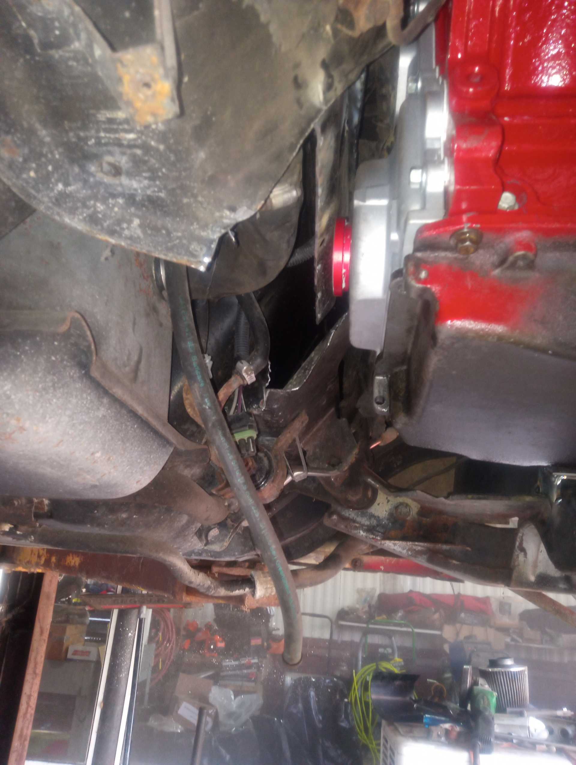

Report this Post12-06-2025 10:28 AM Click Here to See the Profile for engine manSend a Private Message to engine manEdit/Delete MessageReply w/QuoteDirect Link to This Post

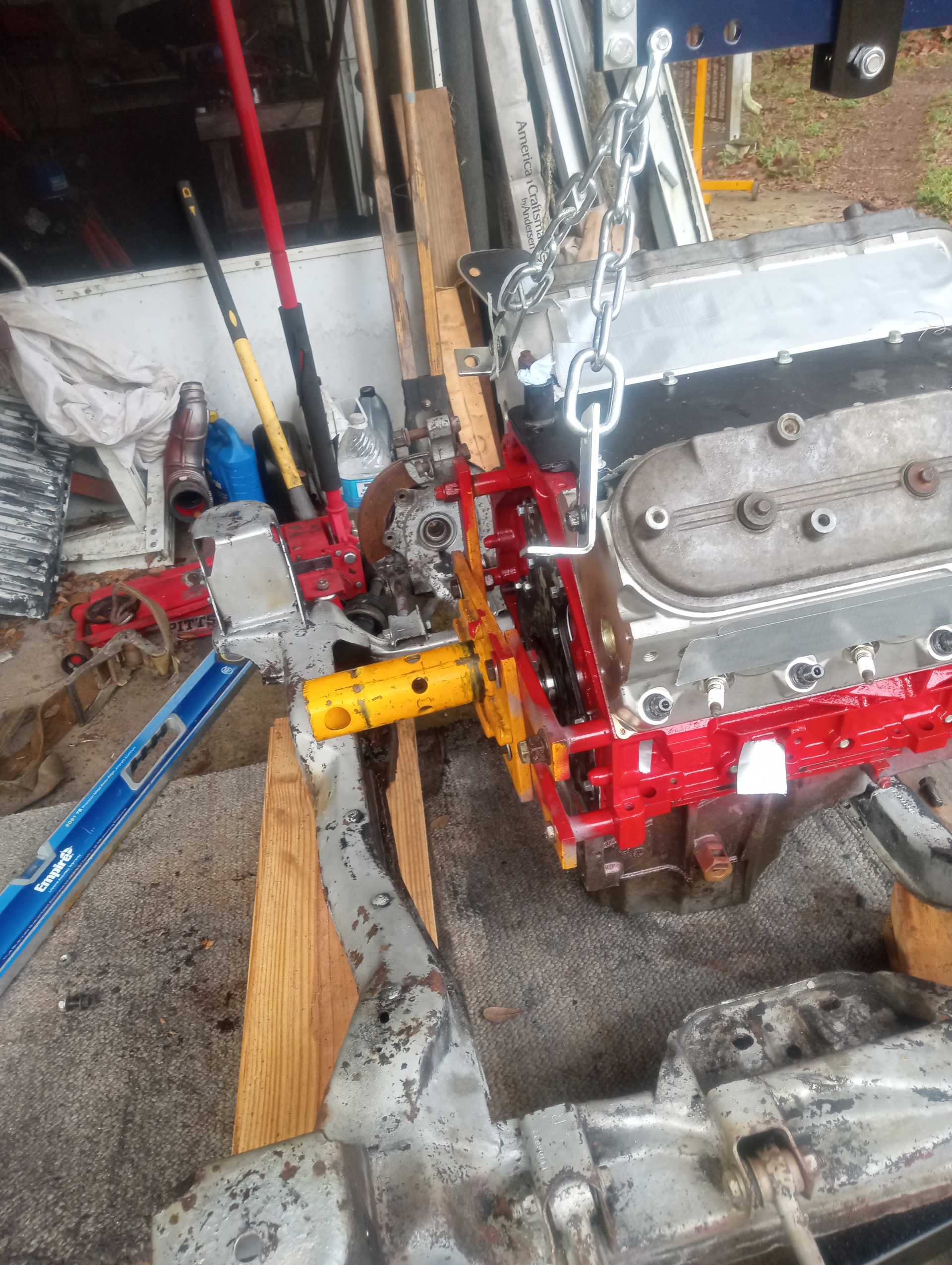

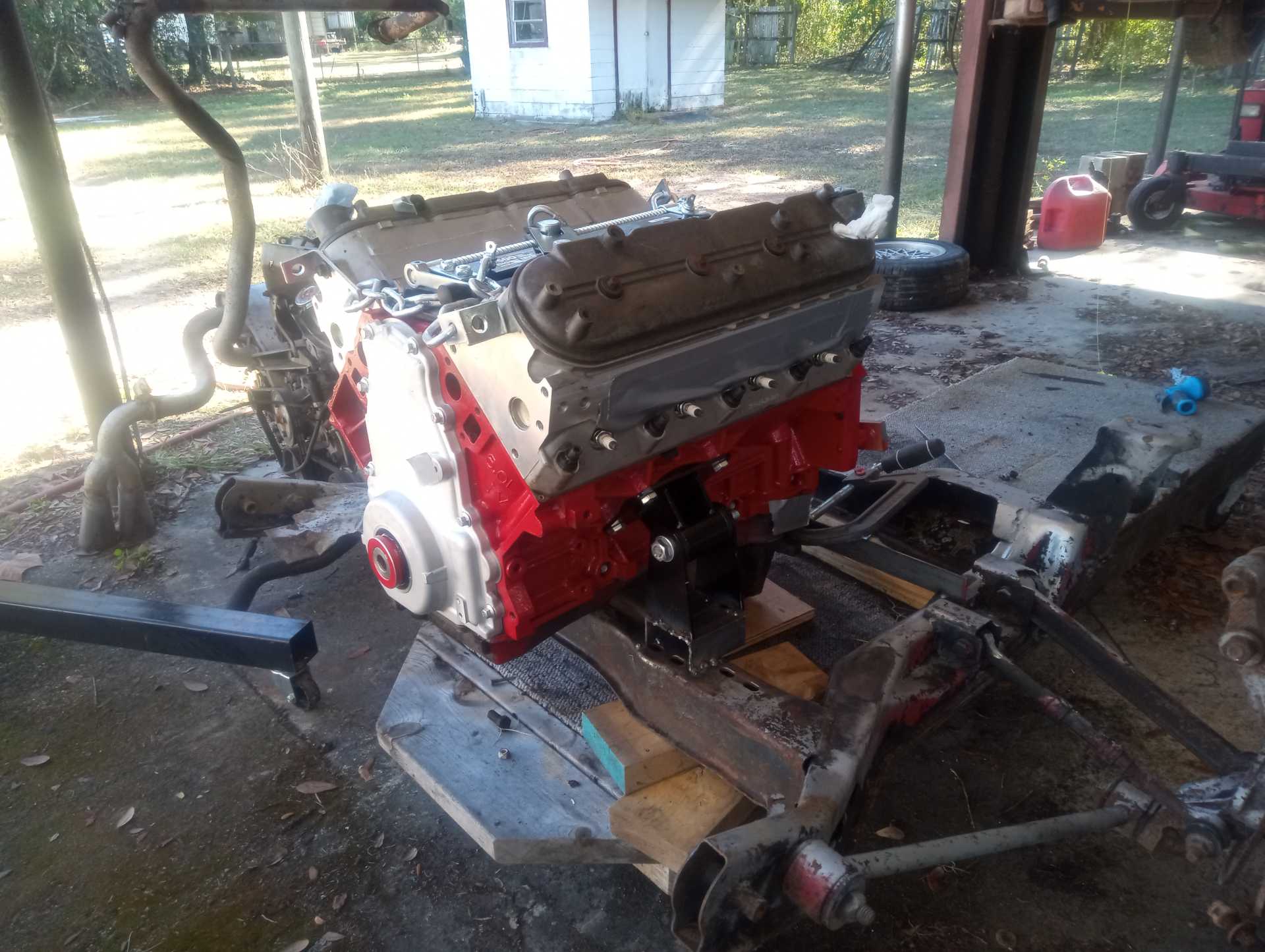

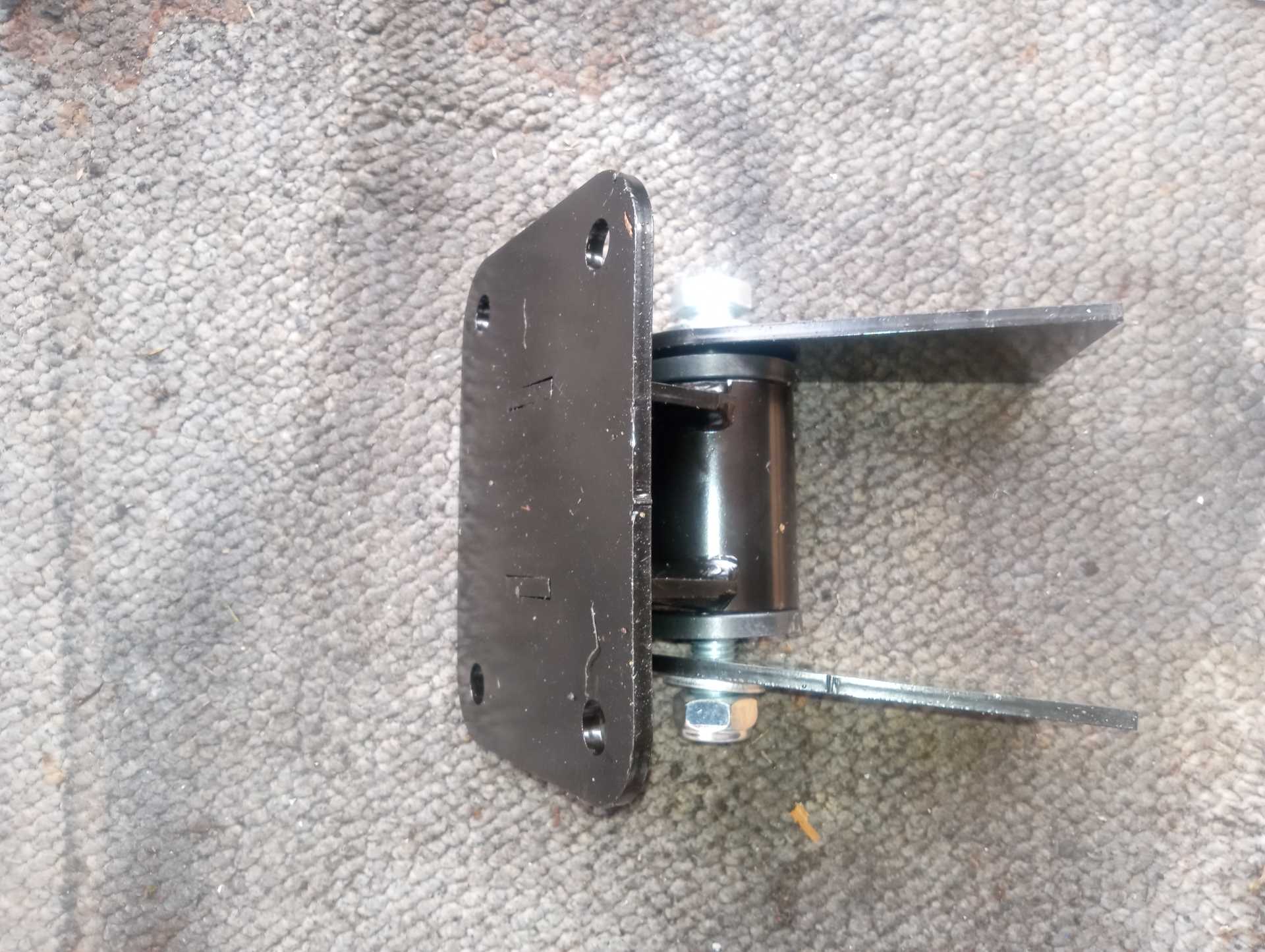

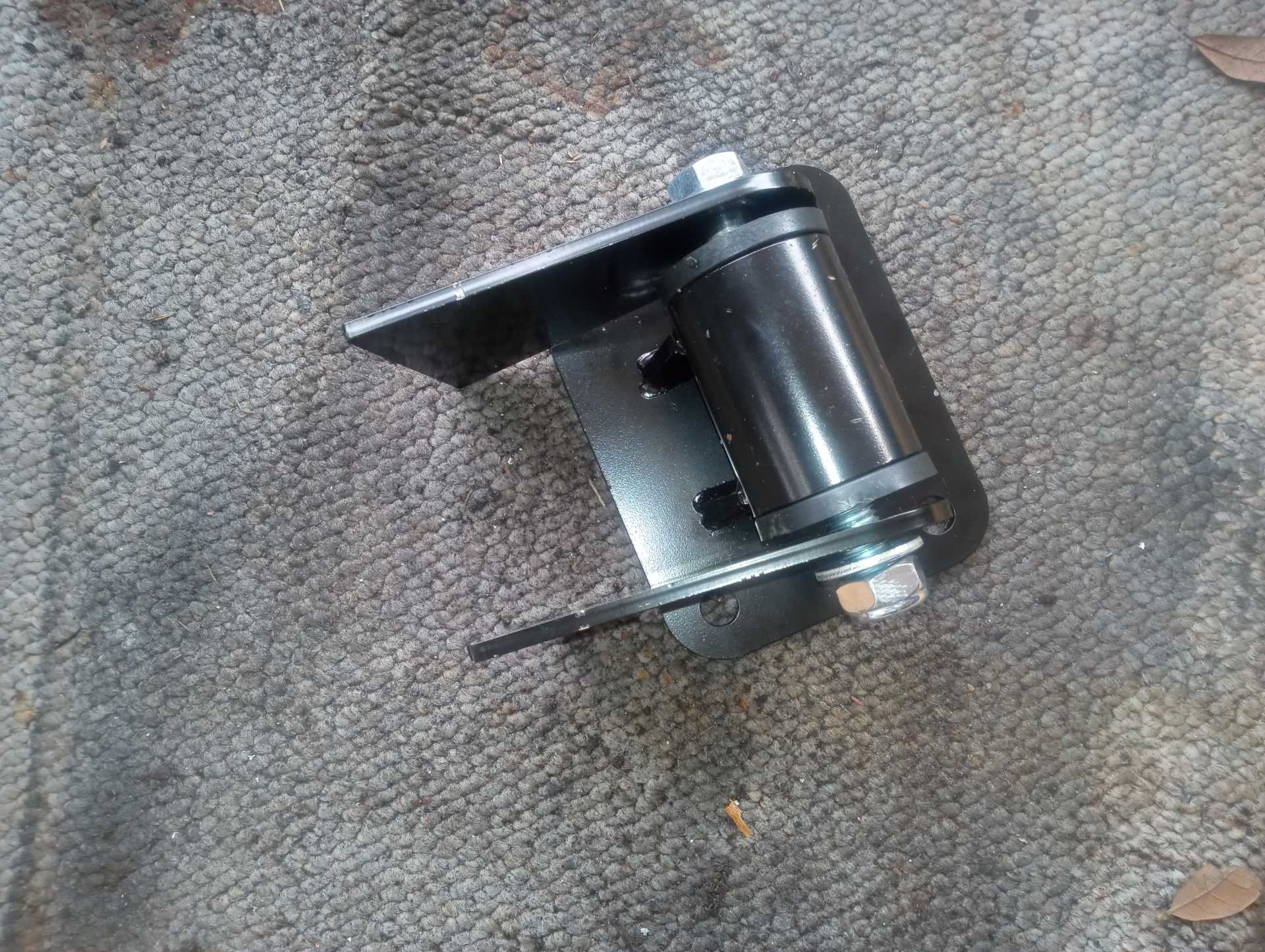

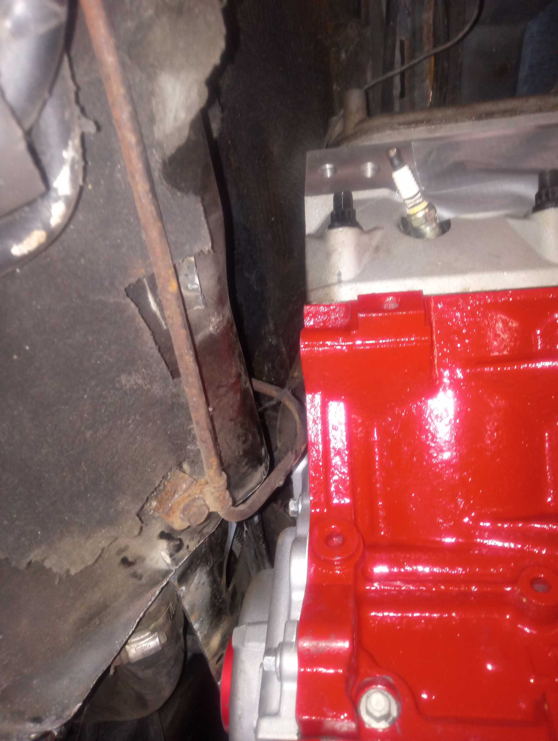

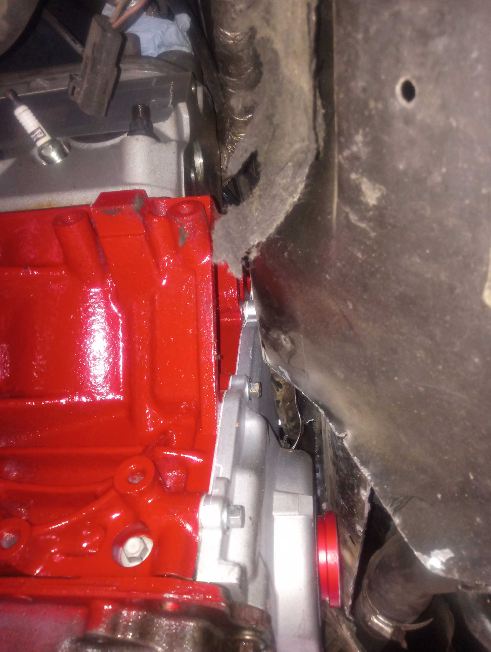

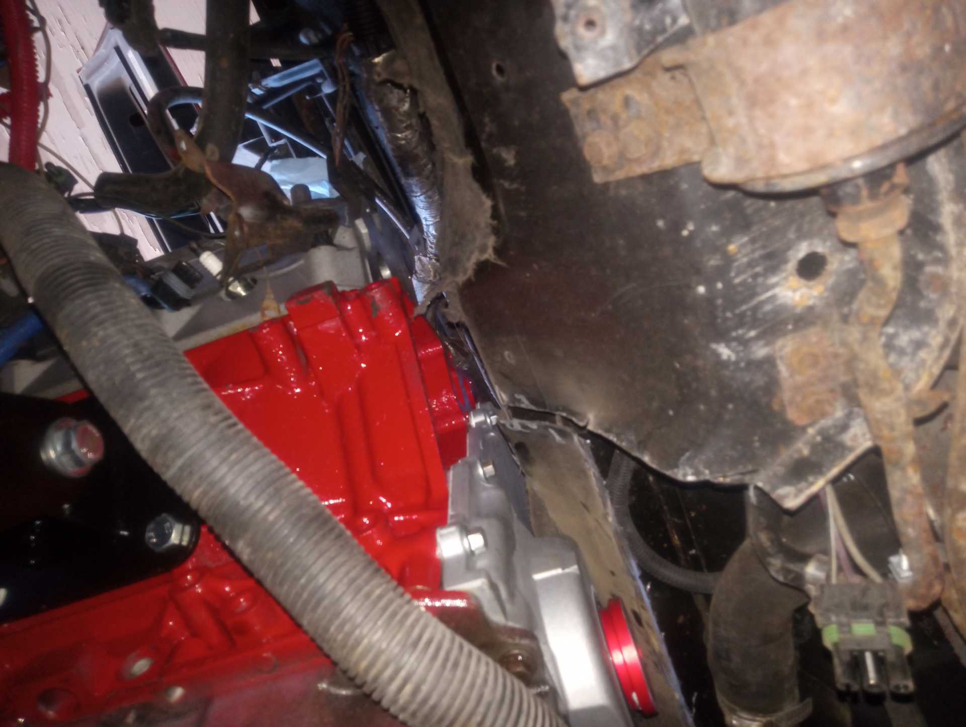

Ok this is about where the engine will sit as the mounts i have will pickup the front crossmember wit just a small amount of box tubing and i will need to notch the crossmember about 1 inch for oilpan clearance i will be running a shorter oilpan as this is the truck version and is like about 9 inches deep versuse the 6 inch deep one i will be running the bellhousing flange is about 1 inch in front of the axle centerline

Thanks fieroguru but I did bit the bulet and have a transmission comming the one jack shaft is not to bad as i found one for about $35 on ebay and the flywheel i should be able to find from a awd 0B2 transmission localy so all should be fine

Ok i have it taced into place and will test fit it tommorow as i have some places I need to go today but if i did it right i should have about 1/2 inch clearance up front at the closest place on the firewall

need to do some more clearancing as this is going to be tight realy tight on the firewall

Report this Post12-13-2025 12:21 PM Click Here to See the Profile for engine manSend a Private Message to engine manEdit/Delete MessageReply w/QuoteDirect Link to This Post
Ok i have it bolted in all the way not much clearance for a balancer yet i would like to run a Ls4 balancer I woild like a SFI balacner as it is right behind me .

Report this Post12-13-2025 01:08 PM Click Here to See the Profile for fieroguruSend a Private Message to fieroguruEdit/Delete MessageReply w/QuoteDirect Link to This Post
Looks like you are planning to run the LS4 balancer. You might want to install it before locking in the engine placement.
I would also drop the fuel tank before doing a lot of cutting in that area. I have seen a few fuel tanks with a crack on the inlet and vent nozzle.
That cross tube is also structural, so you might want to consider reinforcing it for the section removed.

Report this Post12-13-2025 04:14 PM Click Here to See the Profile for engine manSend a Private Message to engine manEdit/Delete MessageReply w/QuoteDirect Link to This Post
yes I need to remove the tank anyway as I am sure if there is any gas in it it is bad the car has not been on the road for over 10 years so it is a good idea to take it out and not sure how i will brace that up as i was not sure if it was structural so thank you for pointing that out what do you think some 1 x 2 across the bottom that i can bolt in after the fuel tank is in do you think that would do it ?
