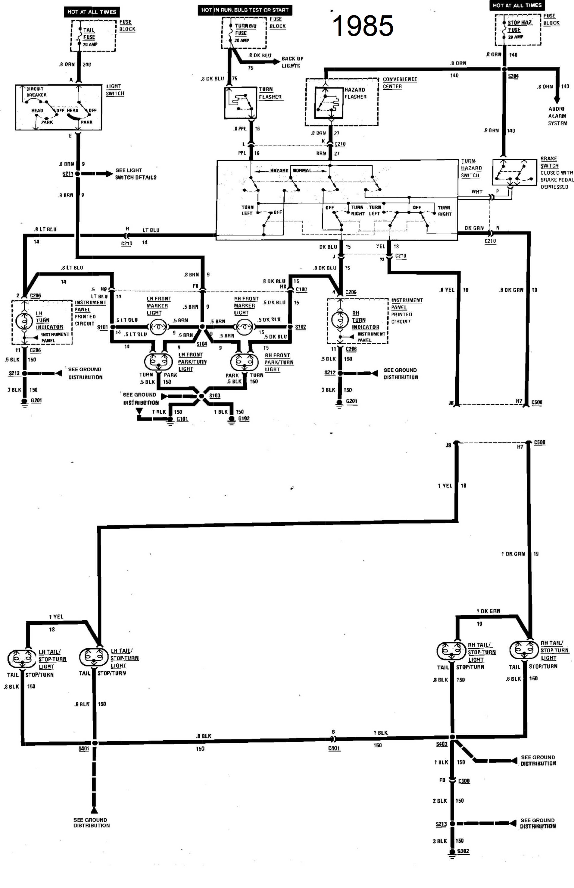

Report this Post11-12-2025 09:13 PM Click Here to See the Profile for Vintage-NutSend a Private Message to Vintage-NutEdit/Delete MessageReply w/QuoteDirect Link to This Post
I found the 1985 schematic if *this* be any help...
Plus the Later Models w/ High Mounted Brake Light
https://www.fieroinfo.com/wiring/fiero19.pdf
