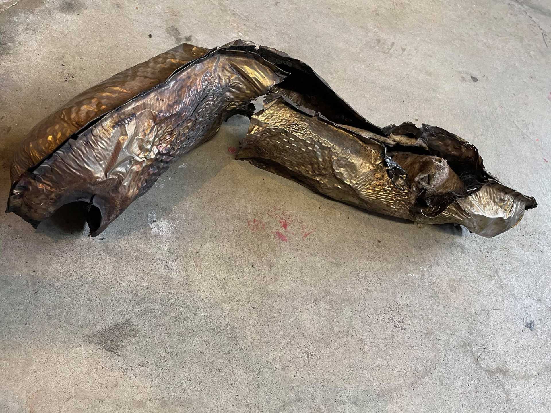

Hey all - replacing my y-pipe and the heat shield material is really sketchy. Anyone have any good tips on materials to use? This is the 88 version, so its the foil type. What is the material under the metal - fiberglass? Are there any patterns out there?

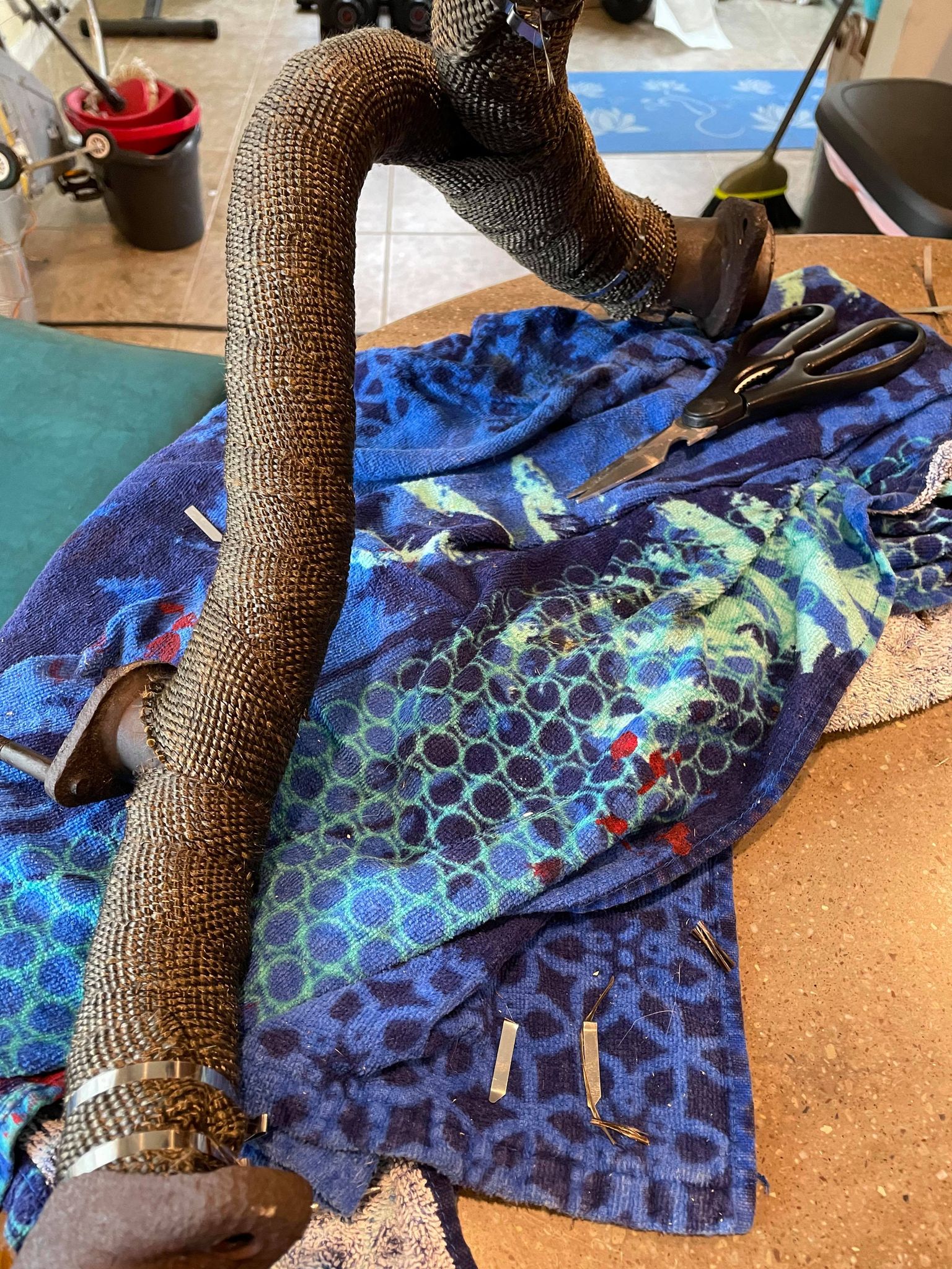

tnkgnr
Posts: 264
From: Charlottesville, VA
Report this Post03-16-2021 11:49 AM Click Here to See the Profile for tnkgnrSend a Private Message to tnkgnrEdit/Delete MessageReply w/QuoteDirect Link to This Post
Screw it - went with the heat wrap. I keep it garaged and once it dries, I'll hit it with the high-temp silicone spray.

Report this Post03-16-2021 03:12 PM Click Here to See the Profile for olejoedadSend a Private Message to olejoedadEdit/Delete MessageReply w/QuoteDirect Link to This Post
The silicon spray works wonders.
