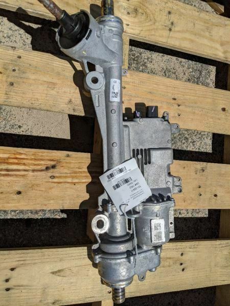

I am only try to argue here, Everybody can benefit from faster more precise powersteering in a Fiero
Sorry, I can't help you here but I were to build another Fiero I would search for an electric rack, not the steering column. The electric steering racks are much more common now than ever. No pump or lines of any kind, just a rack with a motor inside the rack itself. I have no idea what the ratios are or the needed inputs but that seems like the future of powersteering.

I believe the new Mustangs have a very good all electric rack- but you would have to be the first to mod one for a Fiero. I was looking at electric pumps and snagged an MR2 Spyder one off of Ebay.....But I have a number of other stuff to do first (And I have to use a C4 Vette rack because I have the battery up front (The F-body standard WCF setup won't clear the battery box)
If I was just cruising around I probably would never need power steering......But the Fiero racks are all very slow.....I don't think I would want the C4 2-turn rack (Too quick) but the 2.5 rack would seem to be the sweet spot.....Racing a Fiero (Especially cone-courses) you really need quicker steering.....and a quicker ratio with competitive wide racing tires is going to equal STIFF steering....So you need POWER steering....
2019 Mustang rack $199 on Ebay...The motor sticks out forward so it would not need much modification.....Might even clear my battery box....

Don't forget that the rack needs to be front steer. The rack is mounted in front of the wheel centerline. The rearsteer racks will not work,... unless you import a right hand drive rack and then flip it over to mount it.
Also, the closer the steering input shaft is to 90* the better. The Fiero is close to 90*. That Ford looks like it could be closer to 45*. But it is hard to tell in pictures.
