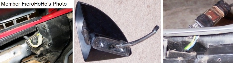

4:54 Minute Mark / Powered Mirror Removal {if required}
The mirror has a ~6-inch pigtail with a connector which is not visible as it is concealed under the front window guide, making it impossible to disconnect the mirror.
The only way to unplug the mirror is to gently pull the mirror upward as you draw the door wire harness from under the front window guide. When the mirror connector is visible at the top of the track, guide the connector through the door’s opening noting that the door harness doesn’t have a lot of slack.
Capture the connector at the outside of the door, and then open the connector’s latch to separate the mirror’s pigtail from the door’s harness.
DO NOT allow the door harness to fall into the door without a way to ‘fish’ it out; I held the door harness connector at the outside of the door with a spring clamp.

With the outer panel off from the door frame, you can renovate all the window tracks/guides and wheels/cams; window motor connectors; door latch and powered lock mechanisms, plus many swap door locks so the ‘less worn’ passenger’s lock can be put on the driver’s side.
If you’re interested to learn more about the outer panel, member fierohoho posted a great ‘How-To’ procedure with pictures
https://www.fiero.nl/forum/Forum9/HTML/000019.html
