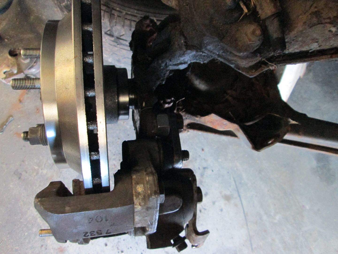

Only the 88's have to be concerned with clearance to the lower a-arm nose. The 84-87 has inches of clearance in this area - especially if using the shallower 13" C5 rotor.
This is a 12" C4 rotor on an 84-87:
Here is the same rotor on an 88 that has had the nose trimmed to provide the needed clearance:
The area where the 84-87s have interference is between the caliper and the shock... depending on caliper, amount of lowering, and rotor application.
And the location that the mounting bracket places the caliper. DoubleC4's mounting brackets are nicely designed because the clock the caliper up enough that it clears the shock mount just fine.
I have 2 87 GT's, both lowered and both with big brakes. One has 12" Corvette rotors with 88 Fiero calipers, and it's running cut springs. My other 87 has 13" C6 calipers with DoubleC4's brackets, with Rodney's lowering ball joints, but I am also running different hubs on that car, so I don't know if that comes into play. No clearance issues with either setup.
I believe the 88's are the only ones with clearance issues when lowered with big brakes.

Thanks for the replies. That picture really helps guru. I willinstall the drop ball joints and springs and see how things look. If I do end up with problems with the shock and the caliper can the shock mount be shifted within reason? Thanks, I'll update when I get parts on the car
